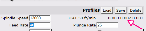

    feedrates depends on the cutter rpm, the material, and the machine stiffness.
    a good stiff machine should be able to cut cherry at 180 inches a minute (but shallow depth of cut, like 0.08")
    Try 30 to 50"/min, but do google the topic. knowledge is power!
    in Sketchucam you will see the cut depth per tooth in the settings dialog.
    Arrowed is the value for a 2 flute cutter, 0.002" per rev. you want this about 0.002 to 0.008 per tooth, and it is calculated from the rpm and the feedrate.
    If you go too slow the wood will burn, the 'chips' will be just powder, avoid this.
    You want a chip that flies away, cutting not rubbing.
    and do clear the chips from the slot with a vacuum, recutting chips is a bad thing.
