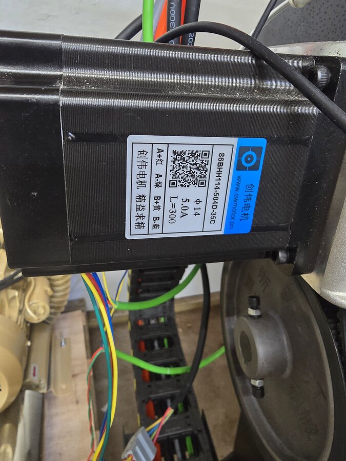

  7. shane doyle
    Sep 11, 2024
    Right on, i appreciate all the info, the motors on my machine are these. Not sure that makes a difference. I've been beating my head against the wall for 2 weeks just trying to get mach3 to turn the spindle on with code. I purchased the blackbox to try and use openbuilds control since it's sooooo much more intuitive and user friendly. But I guess I'll need to go a different direction.
