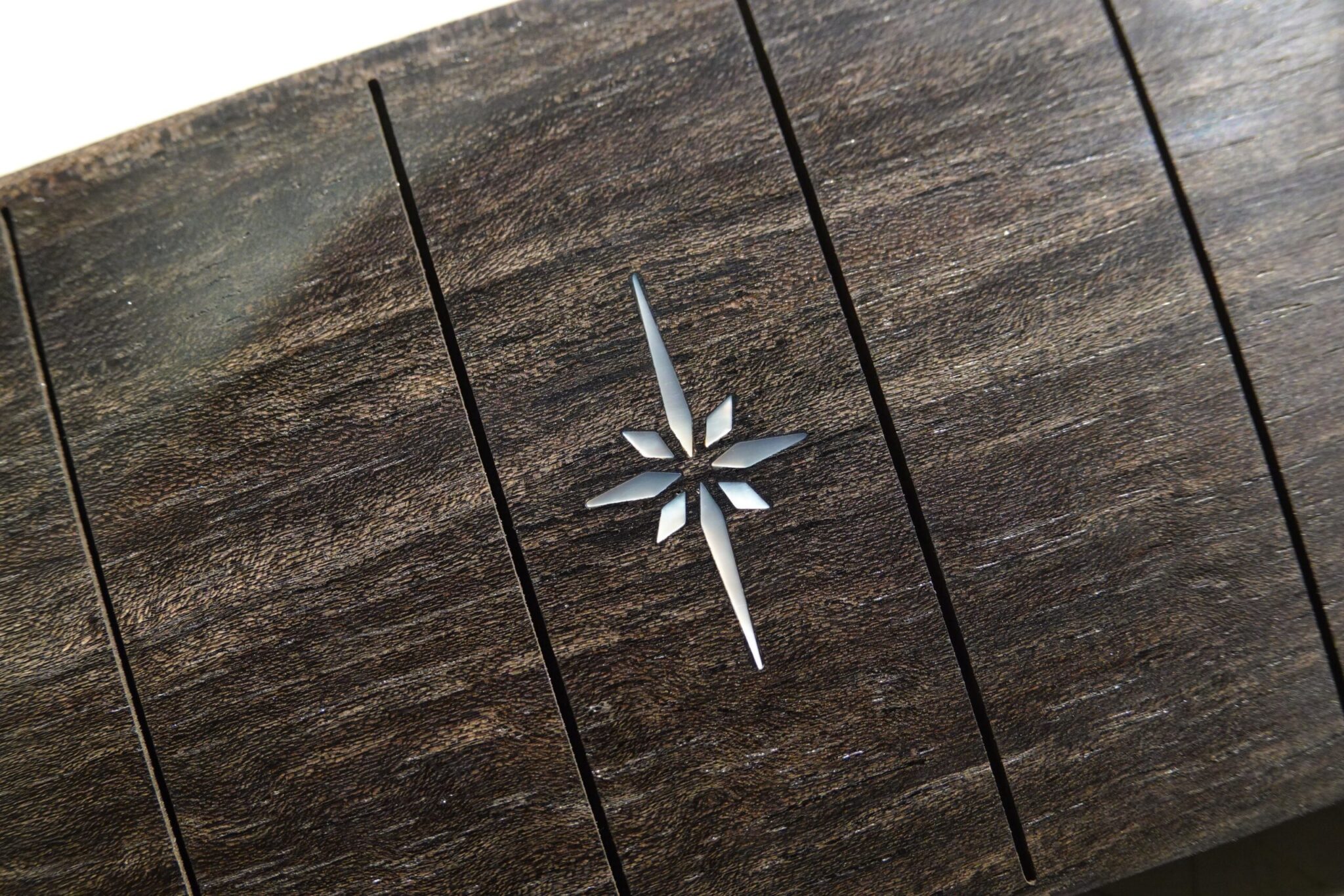

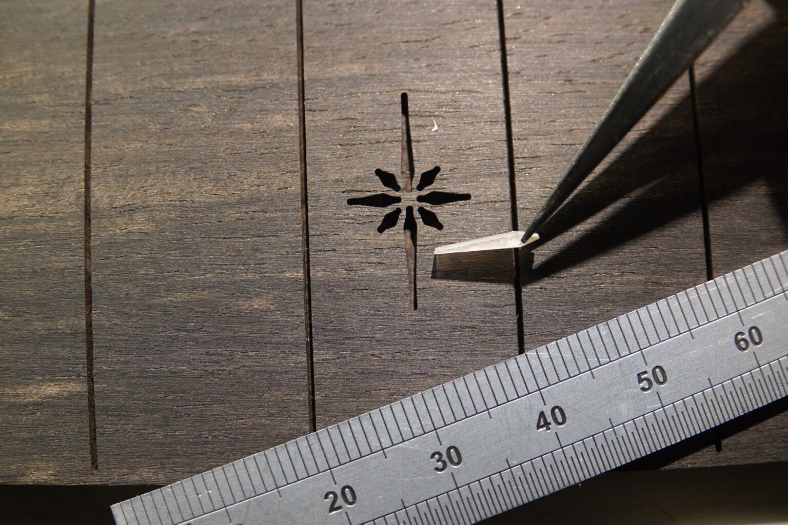

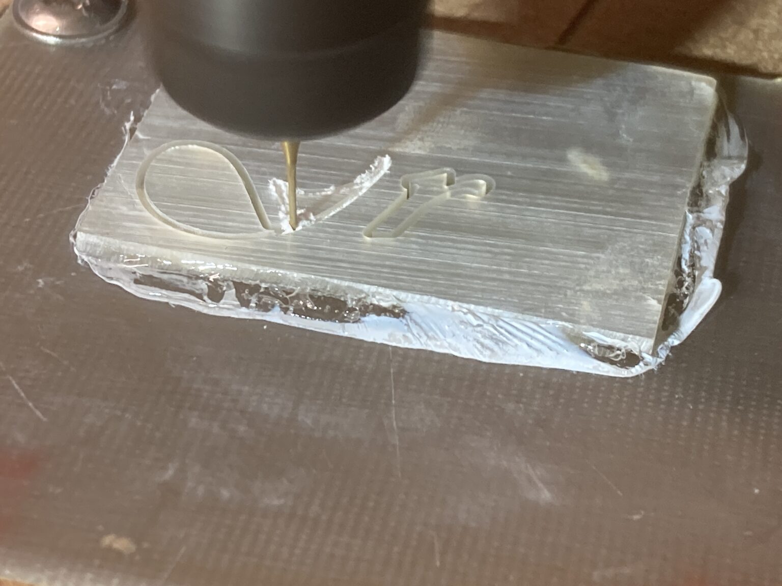

    I used a 0.6mm diameter end mill to cut inlay pockets in ebony for a guitar fingerboard. Feed rate was 125mm/min (5" / min) @12000 RPM (the maximum speed for my spindle) with a 0.3mm step-down.
    The shell inlays were cut using the same end mill at 100mm/min and 0.2mm step down.
    I only broke one end mill in the whole process, and that was because I hit it with the workpiece when loading the machine :banghead:
    The cutting speed formula above doesn't give any consideration to cutting forces - this is the limiting factor for these teeny-tiny mills. I arrived at the figures above after noticing the end mill flexing at ~50% higher feed rates.
    You may well be able to run faster - how lucky do you feel? :)
