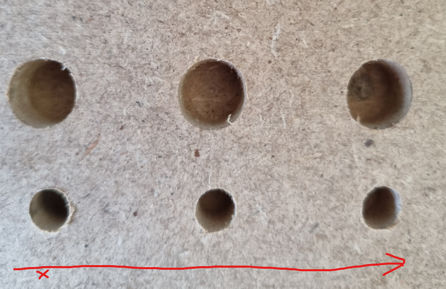

    On the other hand, I have another issue... When I mill circles in bore operation they are ovals. Calibration and tramming are set correctly. Any idea of what can cause this?

  5. Alex Chambers
    2,831
    1,389
    Sounds like backlash. If you post a pic of the oval, labelling the X and Y axes we can give you a clue where to look.
    Something is loose that shouldn't be. Starting at the bit wiggle things feeling for something moving (motors powered on). You will probably feel something rather than see it. If it is backlash something is allowing the motor to turn slightly without moving the gantry. When the "play" is taken up the gantry starts moving again.
  6. absolutefx
    Mar 25, 2024
    19
    Hi Alex. Here is a pic
  7. Alex Chambers
    2,831
    1,389
    Looks like there is some slack somewhere on the X axis. Check spindle mounts, backlash nuts, lock collars, bearings on leadscrew ends and motor coupler. Probably a good idea to adjust eccentrics as well.

  11. absolutefx
    Mar 25, 2024
    19
    Thank you all for your help.
    Effectively I was not up to date despite of what I thought. I was on my local but not in the cloud.
    No post process warning anymore. :thumbsup:
    I was not aware of this. I thought that I did'nt have to homing if I was zeroing my wcs. Thank you to have pointed this to me.
    @Alex Chambers For the circles I think the issue comes from the nylon nuts on the Z axis plate. I have thighten them up but they seems to be a little bit loose. I should replace them.
