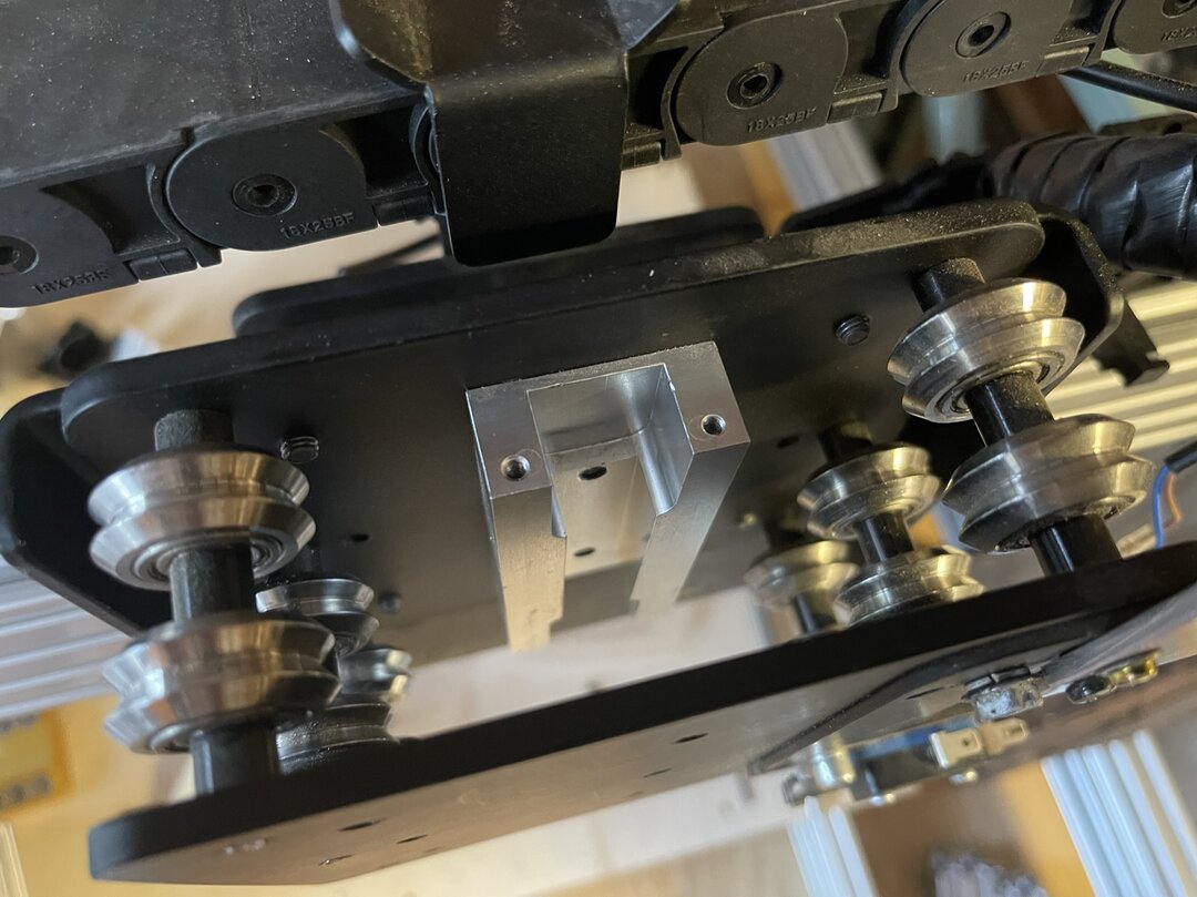

    I am retrofitting a Chinese Ebay 1m x 1m CNC I obtained from an older gentleman in June who wasn't interested in the CAD part of CNC work and passed it onto me. I will be exclusively doing very lengthy (24-36+ hour) finely detailed 3D finishing cuts in various wood species.
    At this point six months after I started it's basically a Lead 1010 as I have replaced just about everything with Open Builds components following their excellent build instructions.
    Notable outstanding differences are:
    • The tool is a 80mm dia. 2.2kw ER20 liquid cooled 24,000 RPM spindle, controlled with a VFD (see this thread)
    • I have a custom high-z configuration to accommodate the spindle on a C-Beam for max Z clearance and strength.
    • The machine is built on a pallet rack.
    Here are a few photos:
    IMG_0458.jpeg IMG_0459.jpeg IMG_0460.jpeg IMG_0461.jpeg IMG_0462.jpeg IMG_0463.jpeg IMG_0464.jpeg
    I have a few open questions that I am hoping the experts here can help with. Last night I finished the build to the point where I was able to successfully cut my first piece. I then started a longer one and noticed some issues that I would appreciate some help with.
    Here are my current issues:
    Issue 1: Whip on Open Builds 8mm Lead Screw. See this video: iCloud
    My X axis is based after the OB High-Z mod. I have two C-beams, with one Open Builds NEMA-23 high torque motor on the lower beam. I have two nut blocks on the lower gantry cart with the screw. There is a third cart that is attached to the two "travelling" carts at the front, and another cheese plate that attaches them together at the back. The spindle is attached to a 750mm C-Beam that travels up/down in Z. This gives me maximum clearance that I need. Everything has been squared and trammed to the best of my ability.
    I am getting bad whip on the X direction unless I loosen and move the lock collars in about 0.5mm from both the motor and the end plate, and leave the nut blocks on the gantry cart slightly loose. This allows the bearings at each end to "slop" move in 0.5mm, but the lock collar isn't pushing the bearing inwards when the cart is travelling in that direction. This seems counter intuitive to have sloppy bearings. But it eliminates the whip.

    Switch to a tensioned leadscrew setup: C-Beam® Tension XL Linear Actuator Bundle as inspiration of the basic assembly. With that big a spindle, it would just be a better option
    You need
    - Different end plates
    - thrust bearings
    - flange bearings
    - tension nut
    Also check that the screw is straight - if it picked up a bend you can try straigtening it, or replacing it.

    Regarding the tensioned leadscrew setup - I already have all of those parts on hand. So the basic idea is just to add a tension nut outboard of the plate, which I replace with another C-Beam motor mount plate with a thrust bearing at the opposite end of the motor, right?

    Tension Nut > Thrust Bearing > Flanged Bearing 688ZZ 8x16x5 > C-Beam Motor Mount Plate > C-Beam with leadscrew > C-Beam Motor Mount Plate > Flanged Bearing 688ZZ 8x16x5 > Thrust Bearing > 1/4" x 8mm Flexible Coupling
    See video below from 12min30 onward to about 17min. Also the tensioning process around 19min10

    I have one more major R&R operation - swap out the metal-wheel gantry carts and 10mm lead screws along the side Y-axis C-Beams with OB components, and then my little machine will be ready for action.
    Not sure why this design was implemented by whomever made this machine, but without eccentrics it's impossible to tighten and there is a great deal of slop in it.

    Peter – when I rebuild, this X axis c-beam with the tension nuts and thrust bearings, is it better to use the two Nut blocks or the one anti-backlash nit block?
  18. Peter Van Der Walt
    15,644
    4,471
    The two-nutblocks strategy further reduces whip as you hold the leadscrew at two points some distance apart - we prefer that for longer screws. On a Z axis that's short we'd prefer the Anti Backlash nut (single one)
