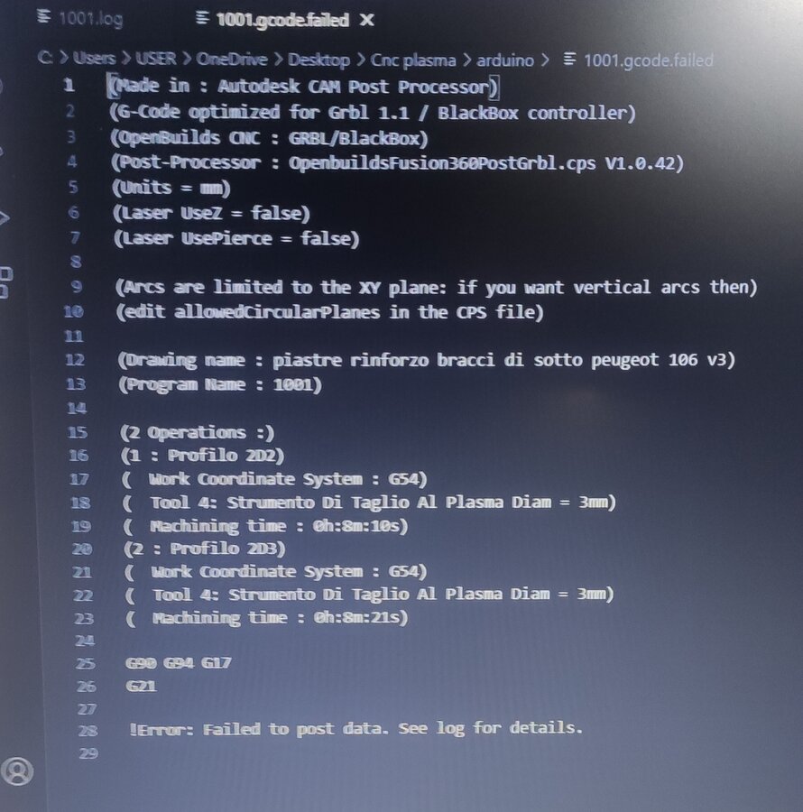

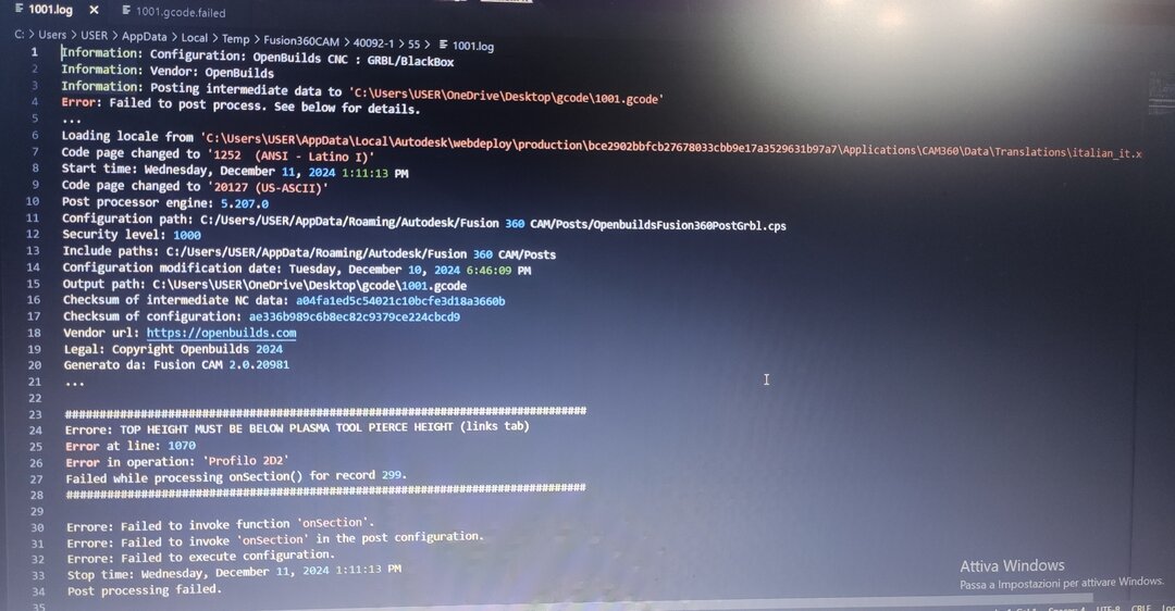

hi, I can't create the post process on fusion 360 for my plasma cutter,
Discussion in 'Laser Cutters' started by Giuseppe Radici, Dec 11, 2024.
  1. Giuseppe Radici
    Dec 11, 2024
    quando vado awhen I go to do the post process it gives me the following error, I'm new to fusion, if anyone can help me I'd appreciate it IMG_20241211_220046.jpg IMG_20241211_220023.jpg
