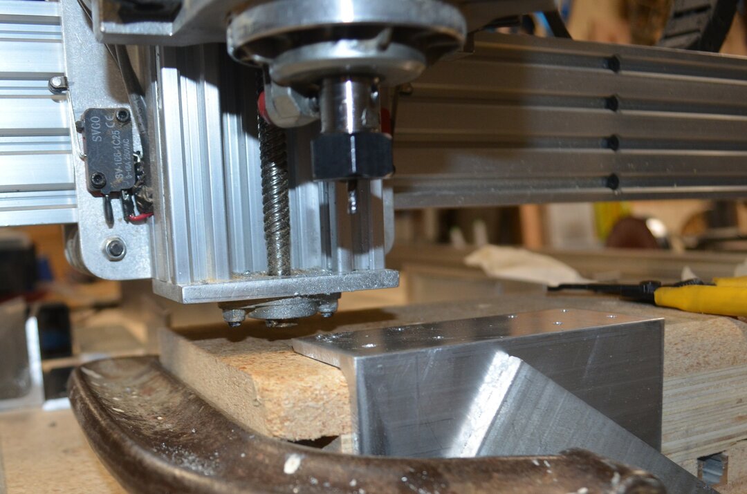

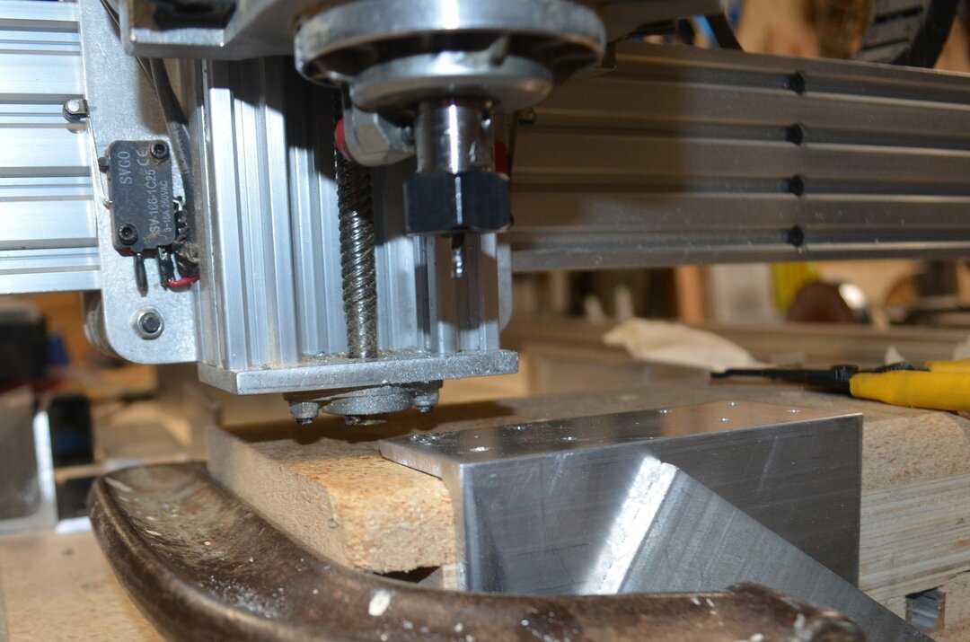

    You get a lot of flex with long endmills which leads to inaccurate cutting if precise parts are needed. Also, they can break easier due to the deflection. I had some cheaper 1/8" endmills I was using in aluminum and they were about 2 inches long. They broke really easily when cutting so I took them over to my vise and performed a controlled break and shortened them significantly. After that I did not break another while cutting the aluminum.
    I pointed you in the direction of some extra long ones thinking that you were maybe using the full depth of the high Z mod for soft materials like foam. I personally use as short of an endmill as possible when cutting. To be able to use a really short endmill, I made a fixture to raise up the work piece.
