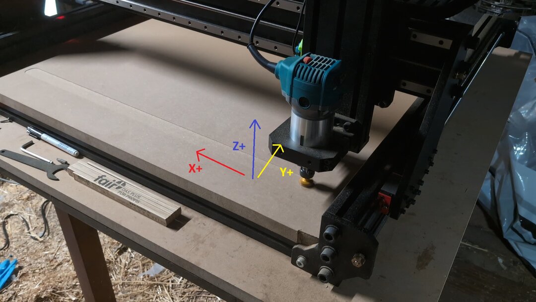

    Hello everyone,
    i´m doing my first steps in cnc and and i´m a little lost with the software. I use a RatRig Stronghold one (750x750mm) with the blackbox X32. I chose the Lead 1010 preset in the grbl settings as a starting machine.
    First things i did: Starting to create my spoiler board
    -callibrated the x,y and z achsis (for that i had to invert the X achsis movement, so it runs into the limit switch by traveling with X+)
    -got the limit switches to work correct (set $5 to 0)
    Now i have some questions:
    -where do i set the working space of the machine? could not find any option
    -> because of this i manualy run the router into the limit switches, drove them out by 1mm intervals so they are not triggered any more and afterwards drove the x and y achsis about the theoretical max. working size of the machine (y = -750mm, x = -744mm) -> set x+y to zero
    ->After setting the z hight by the probe i did a surfacing action with the openbuilds wizard. This did actually work pretty well.
    Now the big problem:
    -I designed my spoiler board in Fusion 360 and wanted to start milling the bags/holes u can see in the picture
    -i run the openbuilds postprocessor and when i load the generated g-code into openbuilds, i get a warning massage about G53 which i dont understand at all (see picture)
    -if i start the run (Position X=-744, Y=-750, Z=15mm set to Zero: 0mm/0mm/15mm), my machine always travels into the sidewall o_O
    -if i start the run (Position X=0, Y=0, Z=15mm set to Zero: 0mm/0mm/15mm), my machine always travels into the limit switch :banghead:
    ->I gues there is a problem with the home point, so Fusion is given a wrong 0/0/0 out to open builds? Do the coordinate-arrows set in Fusion360 point towards X+/ Y+/ Z+ or X-/ Y-/ Z- ?
    Sorry if there is something obvious i dont get but i´m a total noob and german (so my englisch is not the best;)).
    I hope you guys can help me understnad the issue and solve it.
    Best regards!

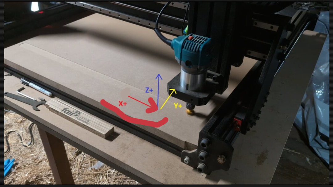

    In this picture, the X axis is backwards. X+ should point to the right. If you correct that, F360 should make more sense.

    ok but my limit switch for x sits on the left side and the openbuilds wizard told me that X+ should travel towards the switch ?!

    Normally the switch would be on the right (X max).
    It is possible to configure it to home to X- : Have a look at $23 settings:
    grblHAL/doc/markdown/settings.md at master · terjeio/grblHAL
    I believe you need to set $23=1.
    Before homing, though, MAKE SURE that the jog controls move the machine in the expected direction: X+ right ; Y+ away; Z+ up. Adjust the direction invert settings ($3) to make sure that these are correct.
