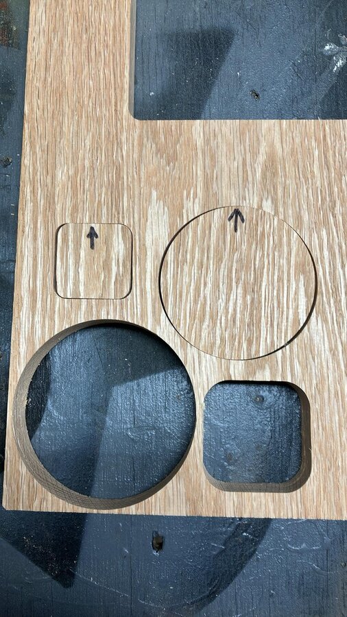

    I have a BlackBox X32 that I have been trying to calibrate over the last year+ so it will accurately cut a circle. I have calibrated multiple times and can never get both the x and y axis to dial in accurately. I have been told my cnc is not compatible with this controller but others with the same machine have success but I cannot achieve my needs. I haven't had a project that has required a perfect circle for quite a while, but now I do. I concocted a test that proves my X it out by at least a mm. When I had calibrated my axis I had calibrated out to 900mm. It appeared to be cutting accurately but obviously it hasn't. I am on the verge of replacing it with something else. Because I need an accurate controller. Any thoughts before I bail would be greatly appreciated.

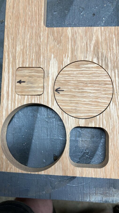

    Okay... So I spent an hour checking couplers, stop collars, connections, grub screws and a partridge in a pear tree AND I am trammed within .002 of inch. EVERYTHING is tight and where it should be. I even marked the coupler and the shaft on both ends and nothing moves. We are tight. So then I ran my x axis to right. Jogged it 10mm and then jogged it 10mm to right and made my mark. I jogged it 700mm to the right and made my other mark. Measured it... It is perfect. Right on the 700mm tic. So I checked my y axis. Did the same process and ran it out 700mm... On the nats ***... What the hell is going on???? Why will this thing not cut a perfect circle? I mean you see the pix. It's off like 2 or even 3mm's. What I haven't done is cut another circle but I'm going to bet the results will be the same. I'm at a complete loss right now. It has to be in my ball screws or something.

    I'm puzzled by the jpeg on the left (above). If the disk is sitting in the aperture from where it was milled, (and it appears to be inline with the grain), then I can understand the gaps left-ish and right-ish from the where the tool has cut, but the "tight" fit top and bottom doesn't make sense.

    It looks like you have cut the test pieces from oak which is hard; try machining something super soft like foam as if it is a flex problem somewhere, then the cutting forces on foam are so much lower, there is likely to be less flexing. Also repeat the test in oak, but with the board grain turned through 90 degrees to see if the same axis has the error in it; if there is flex in the Z-axis, the grain of hardwoods like oak can cause deflection differently depending on whether you are cutting across or with the grain (a test on plywood is usually more consistent as grain has less impact). Looking at how your circle is tight with the grain top/bottom, but about right when the grain is placed sideways, it is almost as if the bit cut a wider slot when running with the grain than when cutting across, which could be your Z-axis flexing in different ways depending on how the machine is vibrating.
    Also try cutting the circles close to one corner of the bed, such as near the home position, and then repeat it right in the centre of the workspace to see if there is any difference (cut in the oak or plywood to make sure there is plenty of cutting force). The corner/centre test is a good one to catch if the Z assembly is applying a torque and twisting/flexing the cross gantry (usually the X), as gantries are usually less susceptible to torsional twist at the ends. The other common flex-point is the vertical end supports, such as in an XYYZ machine, where the two ends of the X gantry drop down onto the Y actuators. As others have said, try the simple test first where you grab hold of the collet and put some force on it by hand to see if you can move it, but repeat the test in the centre of the machine and corners too to see if there is any difference. The tests Peter suggested with diamonds and squares are also really good to try as they can also reveal problems with other issues like strange 'wobbles' in the sides due to resonant flex as the machine accelerates and decelerates too. Evan

    Tore gantry apart and found most bearing block screws to be anywhere from a quarter turn to almost completely out kind of loose. Tightened everything and cut a new test. I think I need a good tramming and I should be good to go... I suspect... (Peter)... When building my machine the instructions had told me to leave my bearing block screws loose one quarter turn until I got them on the rails. Once I put them on the rails I missed the step that had me tighten everything. So ever since then the vibrations have just made matters worse and making it impossible to cut a perfect circle. So Peter I owe you an apology for my snarking comment "But when I come back on Monday after doing all this work and it's still not cutting a perfect circle what will you tell me then?" You were right and I was wrong and I will gladly eat crow.
    Here's a pic of the new test. It's so tight I had to turn it slightly to get it in. I'm guessing because it now needs to be re-trammed.
