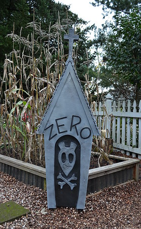

    I'm trying to import an image into a 2D sketch so I can route it into some wood. Does anyone know how I can make the pieces of the image into workable pieces?
  2. Giarc
    3,062
    1,712
    Are you just trying to engrave an image? F-engrave is free and works. You just need a BMP file. I usually will convert an image to a bmp then use the "trace bitmap" function in Inkscape prior to using F-engrave. I "engraved" this image at the full depth of the material to cut out the skull and cross bones used in my Zero tombstone.

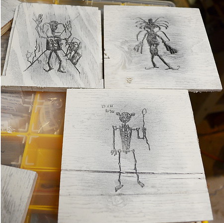

    I used F-engrave's V-bit function to carve these images my nephew drew.
    If it is a grey scale image, you need to up the contrast to get rid of shading so only the lines are left.
