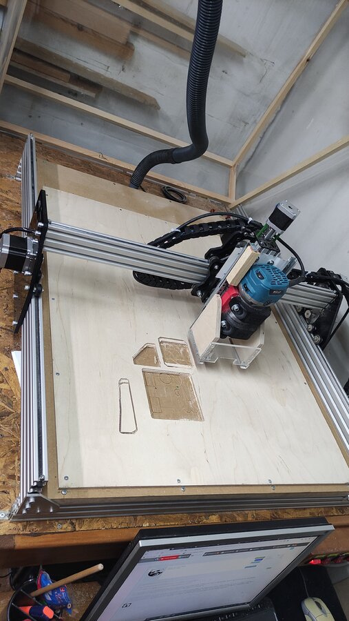

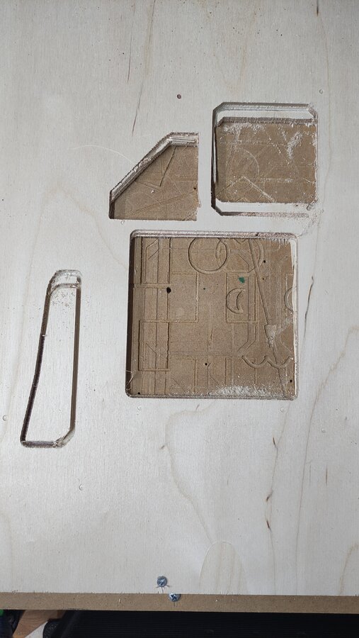

    Hello, i have a custom build cnc which i bought from a local store. The problem i have is this: it is cutting most of the drawing correct, but in random time, when it is cutting a square, its turning left 2-5mm earlier (and sometimes down), moving all the cut left and down by 2-5mm. I will attach a photo, and i will also include the gcode if you can find something wrong.
    Thank you in advance.

    Check your pulleys/shaft coupler setscrews - a drop of loctite between the coupler and motor shaftleadscrew or motorshaft and pulley also helps. It looks like slipping

    The toolpath would preview with the error present if it was a file issue. It does not. This is mechanical.
    Assuming you are using OpenBuilds BlackBox and our Motors of course? If not, could be Mechanical or Electronic. Or if you didn't buy from us, could also be Grbl settings (our parts are high performance, so the profiles match)
    But, when we see this issue, its usually mechanical, and then usually: setscrews slipping on motor shaft, leadscrew side, or pulleys shipping on motor shaft (you didn't mention what machine you have, so mentioning both) - for fear of stripping people undertighten the grubscrews.
    If those are tight, gripping the endmill and giving it a wiggle will help you see what else is loose / badly adjusted

    This is the cnc
    Grub screws are tightI gave it a wiggle but i dont feel something is loose.
    Is there anything else i can check?
