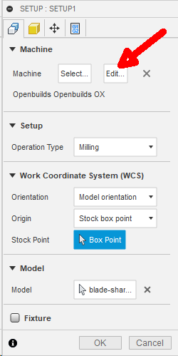

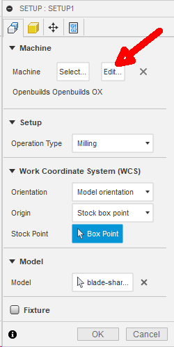

    so I switched over to that post processor and now im getting this. I have this setup like this... this picture I should say
    and when I post it looks like this. whats the deal with this new warning? Screen Shot 2022-03-28 at 6.15.05 PM.png Screen Shot 2022-03-28 at 7.47.24 AM.png Screen Shot 2022-03-28 at 6.15.24 PM.png
  11. David the swarfer
    3,595
    1,969
    You will have to point out this 'new warning' as I don't think I see anything new.
    if you mean the yellow bit of text in the simulation edit box about there not being a post associated with this machine, then you can go into the machine setup and set it.
    1 - rightclick your setup
    2 - select 'edit'
    3 - on the 'setup' tab, select 'edit' button under machine, then follow your nose to select the post for the machine
  12. shotfun
    shotfun New
    Jan 4, 2022
    71
    Yea. That’s what I mean. In the other screen shots I was showing that I’ve already added the PP. it’s strange that after being added that yellow bits popping up. I’ll try again.
  13. shotfun
    shotfun New
    Jan 4, 2022
    71
    so I did just that and ive done it a few times. I had used that approach a few times before I messaged you about it. heres the current status. I chose the open builds PP in the edit tab and even though im getting an actual simulation, im still getting the yellow warning.
  14. David the swarfer
    3,595
    1,969
    number of work offsets must be 6
    ultimately is does not matter, that is just a warning that you have not set a post for your 'machine config'.
    Setting a post for the setup is sufficient to generate Gcode, you dont need a machine configuration at all in order for the post to work
