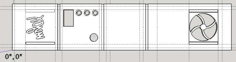

    Well, I flattened the layout and used SketchUcam, tweaking its paths by editing some segments and posted the SketchUp file a bit earlier.
    I just could not go to bed without seeing what SketchUcam would do, especially since I tweaked and played a bit of shell game with it... Taking a peek at the resulting G-code with Universal G-code Sender's viewer I get this :
    I'd say that is darn near perfect (although it might be hard to tell from the above screen capture). The depths look about right, not certain why there is some red in the fan grill, but it still looks ok. I did not order the groups, so there is a bit of skiping around. The origin seems a bit off, but I left the SketchUp file with both the flattened SketchUcamed AND the 3D version of the shield. So that probably explains the odd placement of the origin.
    But most amazing, given all the tweaking done manually to get SketchUcam to do the myOX logo just right ... the logo looks more than AWESOME :D:thumbsup:
    Yes, you probably noticed a little flaw, didn't you ? :oops: I forgot to do the cutout of the shield itself from the rest of the raw material
    It's also hard to see, but there should be some tabs to hold the cutouts (the rectangle for display and button holes).
    If it wasn't nearly 3 am, I would run to myOX and give this G-code file a try right now ... but I have to catch some :sleepy: before work - only a few hours away now.

    After some trial and error, I finally got the SketchUcam to behave as I needed without having to change the design. It basically involves doing some editing of SketchUcam generated elements, using some of its feature in unintended ways, ... I did groups, similar features and allows ordering of the routing/milling while keeping the cutting out at the very end.
    I think I already updated the resource file. I'll need to update anyways as I missed the 4 holes to mount the fan with screws :duh: (and the screw holes to fix the shield to the gantry plate, which will need at minimum two tiny holes drilled / tapped on at least the top edge.
    Looks pretty sharp, no ?
    Here's the view from UniversalGcodeSender's viewer, now including the final cut out passes and proper zero reference :
    So I should be doing a dry run in scrap wood to see how it turns out later tonight. Then I'll be filming with a plexiglass run, the bending with heat gun, etc. Thanks to SketchUcam, it should only be a few minutes of work for myOX.
