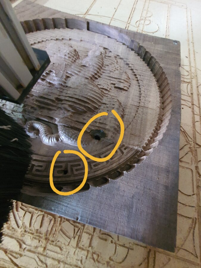

    Hi all,
    So about a month ago I purchased the blackbox to install in my work bee 750 x 500.
    Everything went smooth. Tested all axis and everything worked fine.
    I started a carve and it did about an hour of the roughing pass without a problem. I then started the finishing pass, and I came back after about 2 hours to see it had burried the TBN bit down as far as Z would go and it kept trying to go lower, so it was skipping, actually trying to lift the machine up.
    I stopped the job, and restarted the finishing pass, this time it did the same thing, but only within 20 minutes.
    I can manually raise and lower the Z axis without issues.
    PreviouslyI had a UNO setup with external TB6500 drivers, so I thought I'd upgrade.
    Anyone had this issueorknows what's going on?
    Cheers John

  13. John Tsolomitis
    Oct 15, 2020
    18
    It jogs perfectly. No weird noises coming from motors, nothing like that. It all seems normal. Even when I'm carving, it all works fine, until all of a sudden Z gets burried in the work piece. See attached pic.

  27. John Tsolomitis
    Oct 15, 2020
    18
    So just to update, the issue has been resolved. After speaking with Makerstore (blackbox Aussie supplier), we discovered that somehow my Z axis was set to 1/2 microstepping. This alone did not fix the problem. It seems I need to use the openbuilds control software with the blackbox.
    I have since completed a 10 hour carve and has not missed a beat.
    Thanks to those that chimed in and helped me troubleshoot. Your time and effort was much appreciated.

  30. Peter Van Der Walt
    15,632
    4,462
    Never seen it before. Yeah writing a Serial Comms interface is actually very hard. CONTROLs serial backend has been in the works from my earlier days with LaserWeb (so since about 2016) - lots of improvements over many years adds up (;
    See gnea/grbl (we use the Character Counting queue for optimal performance)
    If its not done right the application can scramble the data (send wrong data), or fail to know where in the queue it is. Particularly scrambled data could result in your issues
    Say you want it to send G1 Z-20 then G1 X10. It messed up and drops a few characters. And now it sends G1 Z-20....(misses the G1 X)...10 which together looks like G1 Z-2010 (a very deep down crash on z results)
