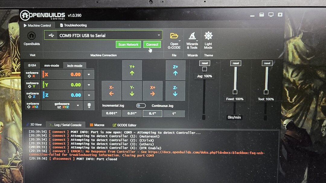

    Ok I've tried all my computers using the driver's from the interface x4 documentation on a fresh install of CONTROL and when hooked up The interface is shown on a com port but it's refusing to hook up.
    No matter what I've tried it on, it hasn't been able to connect.
    If I'm using this older interface on an older blackbox at v1.41 will it matter?
    Or should I strive to remedy this issue?
    I can't figure out why it's not connecting when it's showing up in the com ports.
    15,698
    4,499
    Control "connects" to BlackBox. It won't "connect" to Interface. You use either Interface or CONTROL to run your CNC...
    Don't use the connect button... Use the Flashing Tool under Wizards and Tools
    Read the docs docs:interface:firmware-update-control [OpenBuilds Documentation] in detail
    And yes you need to use CONTROL if you are very far behind (also in the docs) docs:interface:firmware-error-partitions [OpenBuilds Documentation]
    And remember to review the docs on how things work on the newer firmware - wifi setup is via a CONTROL wizard these days docs:interface:wifi-setup-nextgen [OpenBuilds Documentation]
    Also good to review https://github.com/OpenBuilds/firmware/blob/main/interface/CHANGELOG.txt so you can see what you missed out on

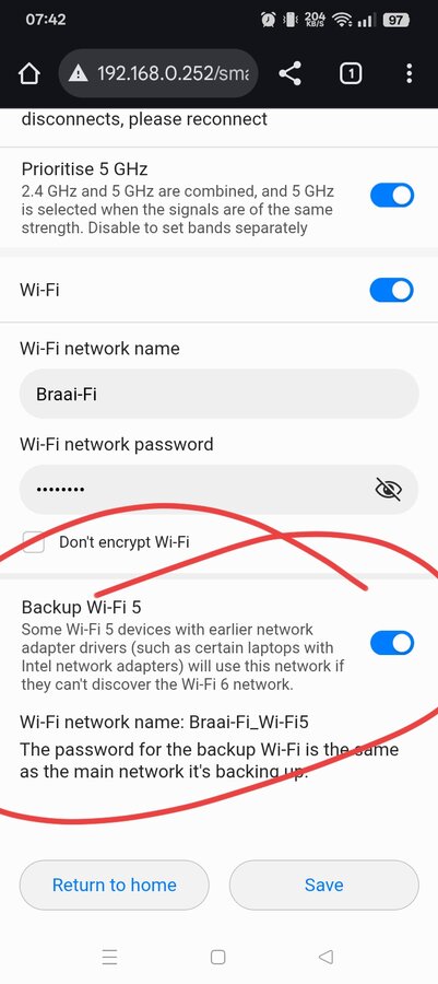

    Side question?
    I didn't want to start a new thread so I'll just ask here
    How do we go back to update 1.57?
    1.58 messed up my Internet connectivity - my operating interface was connected fine to my wifi6 but now that I updated to 1.58 I no longer have connection to my home network. Both interfaces now say "no connection" with a red wifi symbol and all zeros as the address.
    Last week I was connected fine to my nighthawk system.
    The only change was updating
  12. Peter Van Der Walt
    15,698
    4,499
    No difference in terms of wifi protocols (same chip on board, same antenna, always been 2.4b/g (older protocol, never did support Wifi 6), same firmware core down to the exact version of the ESP core etc) so just coincidence and "blaming the update" as observation bias.
    More likely just forgot to enter the SSID/password on docs:interface:wifi-setup-nextgen [OpenBuilds Documentation]
    Thats literally the only difference, instead if using a web interface to set the password, you place it in a text file on the USB. Thats all. Where it reads the ssid/password FROM then same connect code as always runs.
    Way way easier for non technical folks, and particularly with modern phones with Smart Wifi that disconnects AP endpoints without internet that messed with the web interface way. So a wizard to create the text file for them, was win win.
    Have an informed read through https://github.com/OpenBuilds/firmware/blob/main/interface/CHANGELOG.txt older versions of the firmware can of course be found in the same repository (commit history, browse files) BUT the version is not the issue...
    All you need is the right SSID/PSK, a router that supports 802.11b/g (compatibility mode on for wifi6 routers, mine creates a seperate fallback SSID for older devices for example) and the USB with the details plugged into Interface.
    Well and strong enough signal but that's sort of expected. Interface's antennas aren't the most sensitive and its inside the PCB case, so good strong signal
    If your router puts 802.11b/g on a different SSID, make sure to enter THAT SSID in the wizard.
    David the swarfer and Skip S. like this.

    Ok, got it squared away - the 1.58 update seemed to make my interface 'forget' it's settings for my slow side of my network.
    I had to log in to my Wi-Fi and set up a new 2.4ghz channel (we got fiber Internet recently and when the dude set it up he used my old network info) and after using CONTROL to set it up my interface is on the network. I've got my nighthawk satellite near the shop so I've got a nice strong signal too
