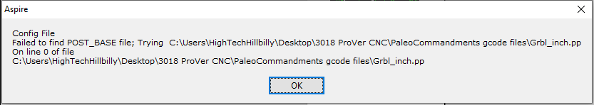

    NOTE: Someone had asked me if we were using the OpenBuilds post processor for Vectric.
    We tried to install the OpenBuilds post processor into Vectric Aspire, but it generated errors and would not install.

    Take a screenshot of your Aspire > Help > About window please
    Also your Post Processors would not be on the DESKTOP: See Where do I look to find the Post Processors folder on my PC?

    We extracted the files from the zip and put them into the /documents directory.
    Then, we used the "install post processor" utility in Aspire and directed it to the files in /documents.
  5. xoneeleven
    Mar 23, 2022
    We manually put the files into C:\ProgramData\Vectric\Aspire\V9.5\PostP
    Then, we re-launched Aspire.
    It generated the following error, when it re-launched.

    Version 9.5 is quite old, your are on v9.510 (from Oct 2018). See Program Updates | Vectric
    The installable Post files works with Vectric 10.x and newer. Our posts are built into the latest versions (10.5 and 11)
    You may want to get the latest: Aspire Upgrade Page | Vectric
    Also, make sure your machine is Calibrated - steps per mm properly set. If you jog an inch (in incremental) does it move an inch?. Wizards and tools > Calibration

    We have upgraded to Aspire 11, and the same issue is happening.
    I do not believe it is a post processor issue.
