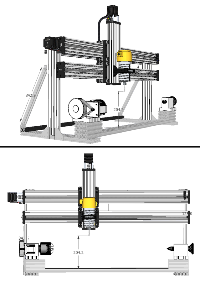

    In my case, I'm looking for a model where I can add a 4th axis to work on 140x140x140mm stock wood material. I was looking for CNC Turning machine but it is lot more expensive than DIY CNC.

    Big drawback for the workbee with 4th axis is Z height. It has been suggested that the high Z mod for the Lead 1010 will fit the Workbee, but then it fits the Lead 1010 anyway. :D

    Then the only one remaining is the Lead CNC with extra z as there is no extra Z mod for the workbee. Surprisingly there is no true openbuild CNC Wood Lathe

    I am in the process of building one right now based on purchasing a LEAD High Z kit and all off the shelf components from Openbuilds. The only thing purchased elsewhere is the rotary axis and tail stock. It will have a cutting length of about 27" and cutting height of about 10." The length could be longer, but I only have Vcarve desktop so I can't do unlimited.

    Exactly what I would like to do. Would you lilke to share the component please for the rotary and tail? Thanks

    I purchased it from Ebay in the U.S. form a store that - I assume - imports them in bulk from China. 〖US〗Rotation A Axis CNC Router Rotary Table 4th Axis 100mm 3 jaw chuck&Tailstock | eBay My previous attempt to get one a year ago failed when the Aliexpress seller took my money then said I had to pay more because shipping rates went up. That was a month after they had taken my money. I disputed it and I got my money back. I will not do business with them again. That Aliexpress store was LYCNC Store. I would have preferred a 4 jaw chuck, but I was not willing to pay the significant difference in price. I plan to make a triangular end piece out of aluminum that will screw into my work piece for the jaws to grab.

    Thanks, will a nema23 be powerfull enough to be used as Lathe axis? Same question apply to the belt drive....Please be aware that I'm not a mechanic man, so my question may sounds stupid.
