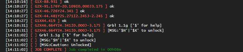

    I searched in the forums couldn't find my issue. Please forgive me if it's in there some where. Here is what is happening, I think these two issues are related because they started at the same time. Using a 1010, with a blackbox, interface, and updated firmware.
    After turning on my machine, I started to prepare a project (get material and files ready). I heard the machine randomly jogging on it's own. I watched and it is randomly jogging one step in the Y negative direction. Probably only does it once every minute or two. I tried blowing out dust from interface and black box thinking maybe there was a short of some sort. Tried resetting blackbox. Tried cycling power on the blackbox. Tried cycling power to whole system. I had a very simple project (1/8" endmill sign...one pocket toolpath) I really needed to get done so I decided to try it and see what happened. Periodically during the job, the machine paused and needed the OK key to be tapped to continue. I'm guessing the phantom jog happened and caused the machine to pause, but they could be unrelated.
    What should I try next?

    Most likely EMI/Earthing but do check in with the store via Support > New Ticket for the best assistance with this issue

    We have found that this is usually related to EMI using cheap unfiltered power supply units.
    Try this quality psu and your problems should go away

    That is the power supply I'm using. :(

    I wanted to follow up for others that may find this thread.
    FIRST, I submitted the ticket and a new interface showed up in my mail box within days! Holy Cow, I was impressed. No additional questions or rigga-ma-role to go through.
    I switched out the interfaces and was back up and running.
    Unfortunately, now just a few weeks later a new problem has arisen and I'm pretty confident it is again the interface. One time the machine began making a random circular pattern and hung up continuing in a circle. After a reset it errored out half way through the job. On a third attempt the interfaced failed to respond period. I've submitted a new Support Ticket and will update later.

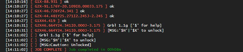

    Peter,
    I tried to switch to using OpenBuilds CONTROL software to run my machine. I tried to different smaller jobs, both ran fine. Went back to the original project...first two trapezoids cut fine. Halfway through the third the machine stopped. Here are the last lines from the log. Could I have a short somewhere?
  10. Peter Van Der Walt
    15,629
    4,460
    It could be a short, or EMI: docs:blackbox-4x:faq-emi [OpenBuilds Documentation] but also make sure your USB Selective Suspend setting is correct: docs:blackbox-4x:install-windows-selective-suspend [OpenBuilds Documentation]
