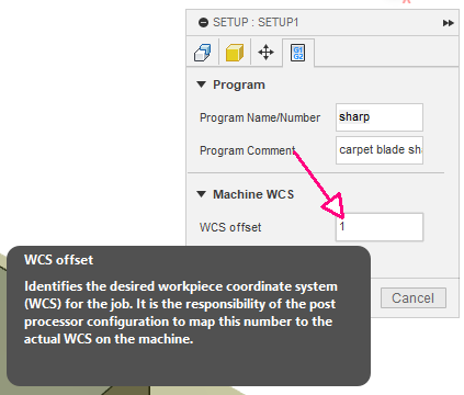

    Warning: Invalid Work Coordinate System. Select WCS 1..6 in CAM software. Selecting default WCS1/G54

    Alex, I was thinking this might have been the issue. FYI, last night I thought I uploaded the newest version.
    I just deleted the old one, then loaded the newest one. Same issue, failure to post. At this point I'll check back and see if other folks run into same issues and see if there is a fix. The two appear to not be compatible anymore, or there is some user error.
    15,637
    4,467
    You should be on V1.42 OpenBuilds-Fusion360-Postprocessor/OpenbuildsFusion360PostGrbl.cps at master · OpenBuilds/OpenBuilds-Fusion360-Postprocessor
    Also, set your WCS please:

    Following the guidance from Alex and Peter, I'm back up and running! Thanks
