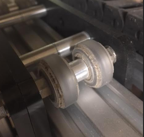

  18. Peter Van Der Walt
    15,329
    4,363
    Wheels worn out? Time for replacement? (Med term consumable)
    Too close would result in people Overtightening them - this wears a groove into the wheels in a matter of hours. That spacing has been tweaked over a decade to find the perfect balance. If its not adjusting as shown in the Eccentric Adjustment video, something else is wrong. Wheel wear on a machine thats been in use would be a good candidate.
    Make sure to push it all the way tight and keep it there while fastening the setscrew. Its a pretty simple system, but does rely on you pushing it tight up against the bearings on both end before setting the setscrew to lock it down.
    If you do the bearing at the top first, then the bottom, the springiness shouldn't come into effect, unless you forgot one of the lock collars? You do have both installed, one on each end of the screw? The bearings+collars constrain the screw. The shaft coupler just transfers rotational force. As said above, you can always loosen it, but it sounds more like you are trying to rely on the coupler instead of a collar?
    Alex Chambers likes this.

  20. jda70az
    jda70az Well-Known
    Nov 11, 2020
    122
    16
    IDK maybe the wheels do need replacing?
    Do you guys have a picture of a worn wheel to show us what that looks like?
    Sounds like I am not getting the Locking Collars in place properly. Because when I grab onto the gantry plates and push back and forth the lead screw is moving back and forth.
  21. Peter Van Der Walt
    15,329
    4,363
    Extreme example, perhaps pics of yours for review would be better
    Yip not set correctly.
    Watch video below (short form, actuator are just what makes up the machine, so transferrable and much shorter to watch) - around 12min onward shows install of lock collars. Note the tip about spinning it around a little so the grubscrew seats best and making sure collar is tight up against bearings, leadscrew must have 0 axial play.
