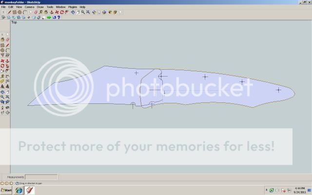

    Hello @MashX The forces to cut steel are very hard indeed, however if your inspired to try you can do it the way some knife makers do it by engraving the patterns on steel or even to make the patterns for the knives.
    Check out the post here where Randy is working up some very nice knives using a Phlatprinter! So with a little desire there are more then one way to skin a cat. :)
    Check out all the other cool knives Randy has made
    http://www.phlatforum.com/xenforo/threads/knife-phlatprinter-style.1908/
