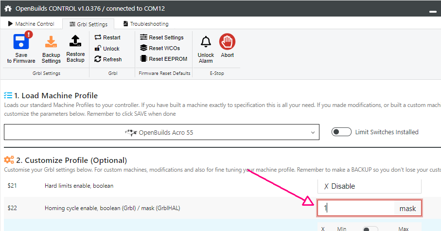

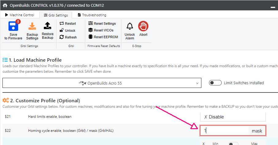

  17. David the swarfer
    3,604
    1,978
    this is not a 3D printer, G28 is not in any way associated with home on a router running GRBL firmware. G28 is a 'predefined position', just like G30 G Codes
    In the GRBL settings is a 'homing on/off', maybe you turned it off, that would cause the home button to be grey.
    samuel kalika likes this.
  18. samuel kalika
    Jan 22, 2024
    34
    hey David, thanks for coming in! Very appreciated :)
    Somehow the $22 went so zero indeed, very strange! Do you have any input on the main problem I'm facing: no voltage out of 0-10V on the blackbox?
    I previously had the Relay into the M1/DCM and the AVI/ACM into the 0-10V and I managed to get the spindle working at F400! But now nothing :(
    How can I see if my "experimental wiring" damaged the blackbox?
    I attach my current GRBL file.
