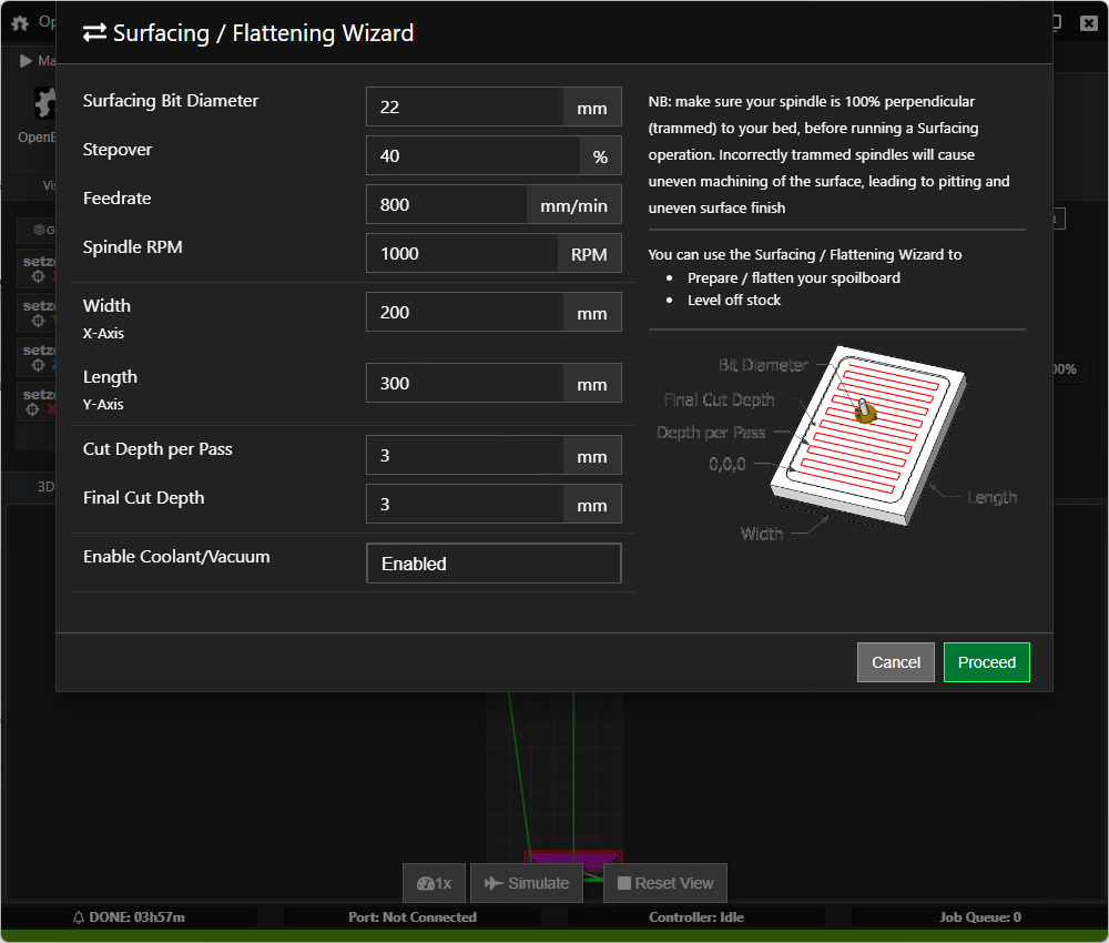

    yep, exactly how it went. thanks again. so my last question is in regards to the wording of the surfacing wizard. is does it by default know how deep to make each pass? when im in fusion I set my max depth per pass. I take it openbuilds is doing that on its own? whats its max depth per pass? thanks a bunch

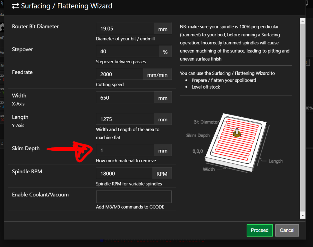

    In OpenBuilds Control choose the "skim Depth":
    When I do mine, I generally do 0.5mm. That way the cutter isn't working real hard so there is no deflection, and I have more spoil board left to spoil. Of course if it is not completely flat (I can tell it is not cutting in some areas) I will come back and do another 0.25mm. However, I am running mine at a higher speed (2500mm/min). If you go with the default above (800 mm/min) you could easily go deeper. If you have a significant hum, I would go with those defaults. It is safe and you may only need the one pass.

  11. Peter Van Der Walt
    15,632
    4,463
    If you set final depth and depth per pass to the same value yes.
  12. shotfun
    shotfun New
    Jan 4, 2022
    71
    This is where I’m getting confused in regards to running the wizard. I only have a “skim depth” field. I take it that’s the depth per pass field. I don’t see anywhere in the wizard where I can set the final depth. Am I missing something here? The dark mode image is from an earlier response to my questions and the light mode image is from my computer hooked to my machine.
  13. Giarc
    3,058
    1,709
    I do not see it either. I would suggest doing as I said above and skim a thin layer. If it is not enough, run it again after re-zeroing your Z. If you are doing a thin layer, you can increase the feed speed.
