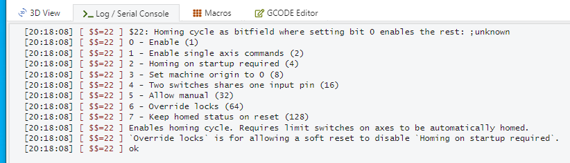

    As per the title I have gone from GRBL to GRBLHAL. Some settings are different such as $22 Homing cycle enable/disable. In GRBL, $22 is boolean and in GRBLHAL is an 8 bit mask (which is a little confusing). Is there any documentation that helps people migrate from GRBL settings to GRBLHAL settings?

    Enter $$=22 for example into the Serial Terminal, grblhal will output the Help for that command
    (TIP: Only 1 and 0 is typically used with CONTROL)
    Note that if you have an existing Grbl Backup from CONTROL, just import it into the X32 using CONTROL > Restore Backup and we'll apply the needed changes for you. No custom work needed
    Make sure you have a solid working machine first before customizing (just the import as first test - no changes), and make sure you have a backup from when it was working before making changes so you have something to fall back on

    Thanks for the info Peter. So a good starting point for $22 would be 3 (bit 0 and 1 set to '1')
    15,643
    4,471
    No i mean as values, we either do $22=0 (OFF) or $22=1 (ON) typically.
  5. Scott Thompson
    Nov 13, 2019
    47
    Got it! Thanks
