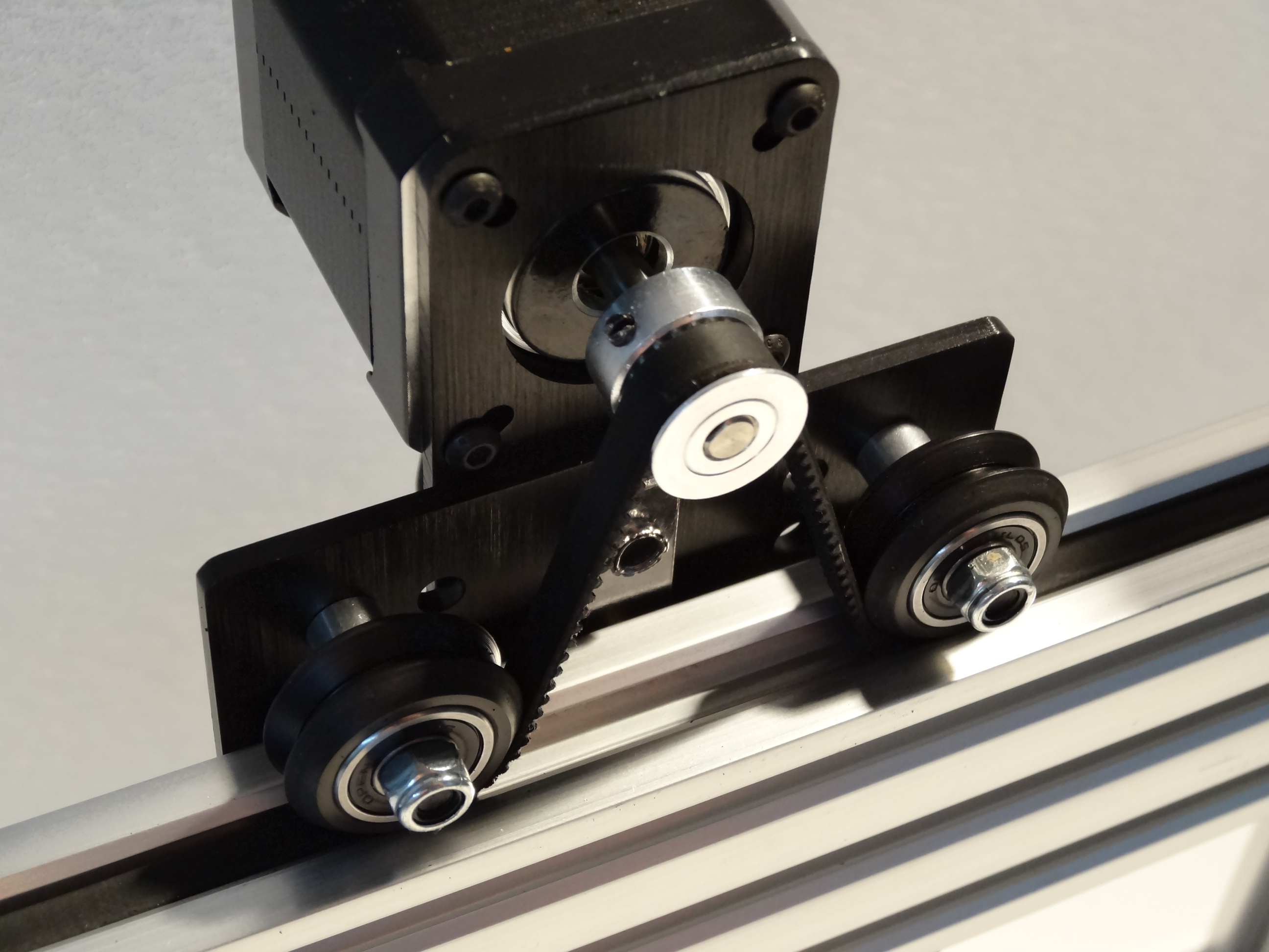

  7. Tweakie
    Tweakie OpenBuilds Team
    Moderator
    Jan 18, 2014
    784
    326
    Hi Duane,
    I think it's the standard extrusion rather than V-Slot (captured this image from their video) but their set-up certainly seems to have a nice smooth motion.
    Tweakie.

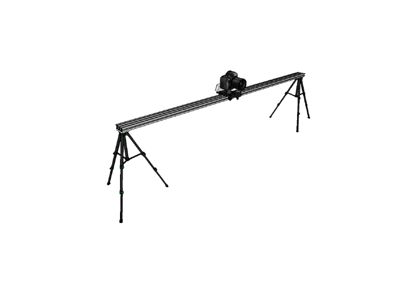

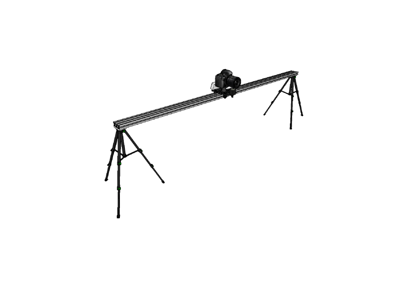

  8. gjwest
    gjwest New
    Jun 13, 2014
    18
    25
    Hi Guys
    That system looks interesting and seems to have no wheels. I'm opting for the solid delrin wheels both for the belt support and the extra stength, though I'm not sure how the bearings will cope based on the this but the system will be operating in a start, stop, shoot, method not as one continuous run. I have seen other systems similar to this that use the delrin v wheels using makerslide but there is not much about how much weight they can take. My plan currently has only 2 wheels on each side of the rail but it may be worth upping this to spread the load.
    Below is some rough images of my plan so far. CameraRail1.png CameraRail2.png

  13. Rick 2.0
    2,912
    1,574
    I knocked together a quick mockup based on what you have shown using a 6 wheel v-slot gantry plate with the wheel bearings transversely loaded. With a 5kg load there were no noticeable issues with the bearings. While this is not an orientation I would use for a CNC setup which would have thousands upon thousands of high speed motions, for a slow moving slider you will not likely have any issues with the bearings.
    One issue that should be noted however is that under full load with the slider at the center, there was a rail deflection of slightly over 7mm. You will probably want to move the end supports inward 25cm to 30cm from the ends to reduce this to a negligible amount.
  14. gjwest
    gjwest New
    Jun 13, 2014
    18
    25
    Thanks Rick, I was also concerned about how much deflection there would be. The plate I have for the tripod mount can slide along the rail to any location so moving the tripods in form the end wont be a problem.

    @gjwest i am attempting to build a time lapse slider as well based on the pi lapse build found here. You mentioned you are mounting the motor on the gantry plate with the Camera and ardunio. Can you explain how you are mounting the motor, i am planing on using a dc motor and not one of the stepper motors from open build. Also are you running a belt along the width of the slider or does the motor just move the wheels on the side that it is mounted to? See very bad drawing.
  16. gjwest
    gjwest New
    Jun 13, 2014
    18
    25
    I also looked at the PiLapse and was tossing up which to go with. I already had an Arduino so went with that and based my system on Airic Lenzs MiniE v1. Based on your pic I think you are planning on doing the same as me but with a Pi. Below is an image of what I'm basing mine on. More info can be found here I am putting together site for the build here and will also be posting the final build on Openbuilds. My length of rail finally is hopefully turning up today so I can complete the build this week and get the final build online for anyone interested.
  17. David the swarfer
    3,604
    1,976
    I would orient the rail vertically to minimize deflection due to gravity.
    put the motor underneath and the camera on top. maybe a plate each side then you can mount the electronics one side and battery the other.
  18. gjwest
    gjwest New
    Jun 13, 2014
    18
    25
    I have thought about that and as mentioned by Rick 2.0 above I'm investigating how much this can be minimized by placing the supports in a bit from the ends. I have loaded a 1.5m length of rail with 5kg in the center and it deflected about 4mm with supports at the very ends of the rail. I moved the supports in 25cm each end and the deflection was only about 1mm. I do like the idea of putting the rail vertically and removing the deflection all together and may look at this option in future enhancements.
