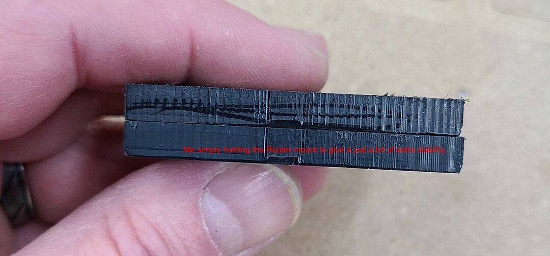

    In trying to tram my X direction I found that the X Motor is torquing the entire X C-Beam.
    I get a ridge (in the z- direction) on the forward cut when moving in the X minus direction. When it moves in the X positive direction the cuts are flush. So I get this weird "wave" instead of a flat surface.
    Anyone else have this issue?

    Here is an cross section of the surface it leaves.

    This probably has less to do with tramming and more to do with climb vs conventional cutting and overall torsional rigidity of the gantry vis-a-vis the leverage of your spindle arm. If your machine can't handle it, simply uncheck the "Both Ways" option in CAM and go with the method that provides the best finish- climb milling, in this case, which is normally the case in CNC.
    Both Ways is primarily a high-speed decking strategy, not a surface finish strategy. Add Stock To Leave (slightly larger than your ridge height) and then add a second facing op that's climb-milling only, if you like.

    Typical saw tooth pattern you get when your tool is not 90 degrees to the machine bed.

    When moving in the X-minus direction the tool is not 90 to the table, but when moving in the X-Positive direction the tool IS 90 to the table. It;s not a saw tooth pattern (see the red and blue lines above). I'm trying to figure out why it is not 90 in one direction and is 90 in the other.

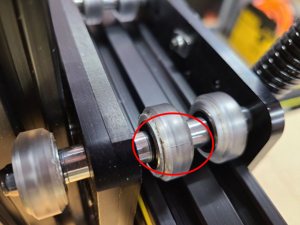

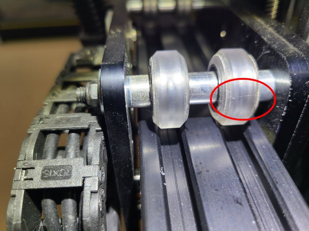

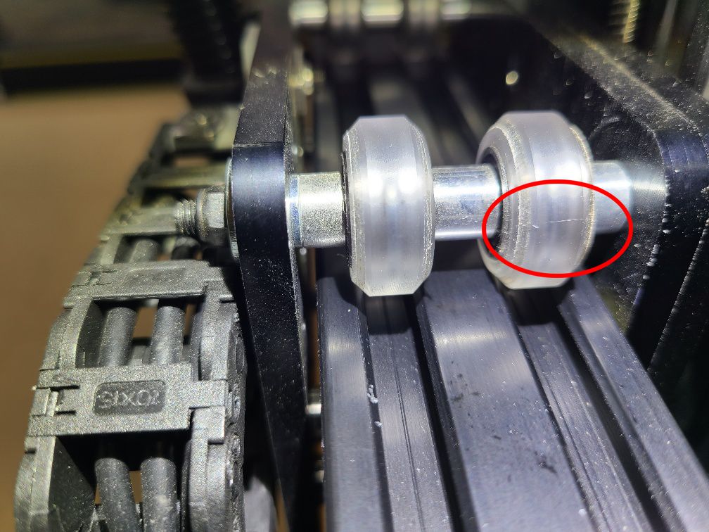

    I have also found 2 cracked wheels on the X gantry, pictured. Are these wheels molded or machined? the crack is so straight I wonder if they are cracking on the mold line. These wheels are the two forward wheels on the X, the ones that carry all the weight of the router and get all the force when pushing/pulling on the cutter. Early on I think I was running this machine too aggressive and the instabilities were too much for the wheels to handle. Not sure if this is what is causing the X jitter or not. But will replace them when and if I upgrade to a second beam on the X.

  19. Gary Caruso
    May 19, 2016
    1,203
    536
    looks like a line (just a dent) that happens when I run the wheel into an end plate, does it go all the way through?

  20. Peter Van Der Walt
    15,644
    4,471
    They are machined, but its possible the raw stock may be made using a float/mold (How acrylic plastic is made - material, making, used, processing, parts, Raw Materials)
    If they are new enough - http://support.openbuilds.com/support/home will be happy to help, if its been some time, consider it long term consumable
  21. Kristoffer Lippert
    Apr 19, 2020
    41
    It sounds weird. I've had dents in my wheels (cause i ran over a wire) - without any issues.

    - You could well go-ahead and replace the wheels with the cracks, though I'd be surprised if that makes the problem go away.

  22. BeeAMaker
    BeeAMaker Well-Known
    Apr 19, 2016
    127
    34
    @Gary
    I haven't ran my X into the end plat yet - I have however ran the Y into end plates, no mark on those wheels however. The Speeds I am using are from sources of Speeds and Feeds I have been reading about but I for get that info is for machines that can handle those speeds. Most sites I look on have the surface speed at 400 - 600 ft/min and a chip load of 0.003 to 0.006 for HDPE. but I see I am going to have to slow things down a bit.

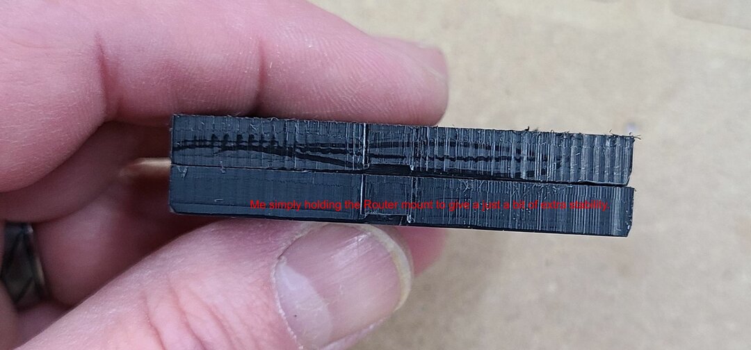

    As for Tramming issue, I realized I drew my original image backwards, it leave the forward edge on the X+ direction and flat on the X-, But anyways. after all this I have gotten that ridge down to less than 0.001. So the issues is still there but far less than previously. As I mentioned before, I can see about a 0.001 deflection in the beam when moving back and forth so some if not all of this is due to the X motor torquing the beam. I've resolved to surfacing in one direction for the best cut.

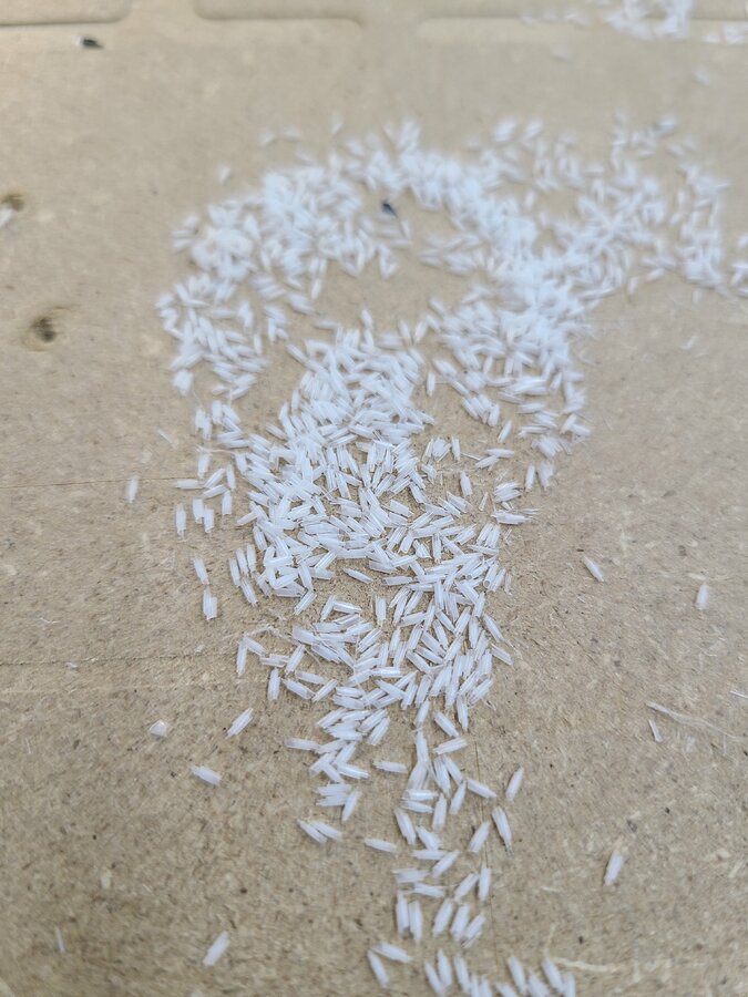

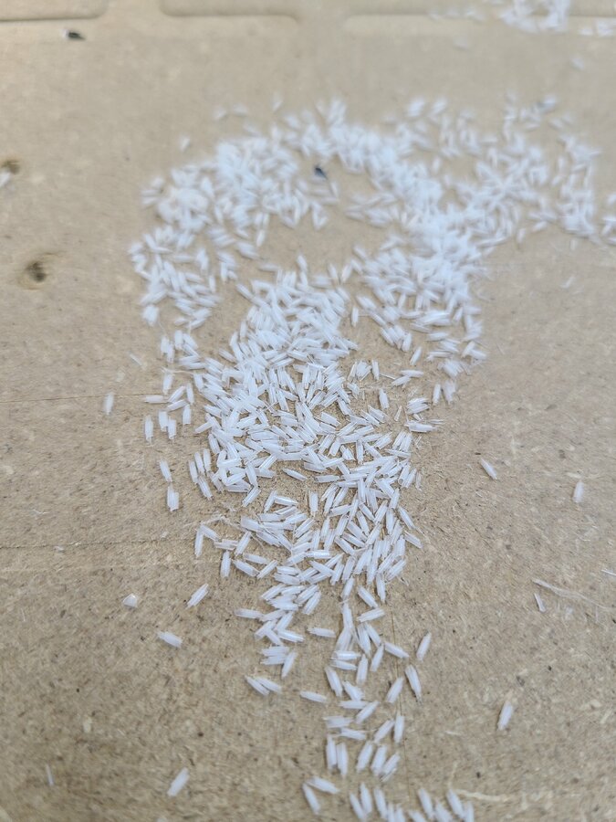

    These are my chips for 1500mm/min single flute, 1.5875mm doc. No chatter and very little deflection on a 1" thick part.

    I'm no expert on chips. - but if the surface finish is good, then something is definitely right ;)
