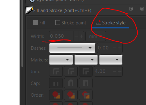

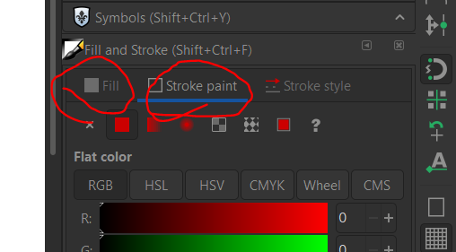

    In inkscape, I bet if you remove the "fill" after you did a "Trace Bitmap" on your drawing you will find your ink line is two parallel lines. If so, delete one. If you can not see anything after removing the fill, the make sure you have the "stroke paint" selected. These are circled in the picture:
    You can then change the "stroke type" and make it thinner. I use 0.05mm.

    I made a test file with line varying line widths and found for my laser that anything under .15mm creates a path vice something Lightburn wants to try to fill.
