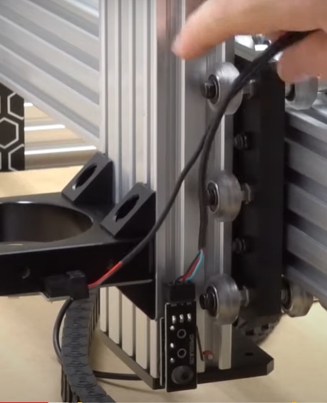

    As you can see from the attached photo, I'd like to have the Z-axis stop just shy of the Z-axis end plate. But I can't figure out where or how to position the end stop switch.
    I have a 16mm spoilboard, and I will mainly be cutting 18mm plywood, which doesn't give me many mm to play with. Every position i can think of makes the end stop switch protrude past the Z-axis end plate.
    Suggestions?

    Image from Workbee Build video.
  4. Giarc
    3,058
    1,710
    I did it the hard way. I must not have been thinking clearly the other day. Maybe I should watch the assembly videos. :) Mine required grinding away a good portion of an aluminum right angle bracket...which is actually easy with a disk sander. At least it is a pretty shade of orange.

    Hi,
    My switches are a different shape/size to the one showed in the build video. I've managed to get mine pretty darn close, but my soldering is something only a mother could love. So I've taken the chicken way out and ordered a few of the end-stop switches from the parts store. My next challenge is to test the full travel of the axes. So far I've got the X-axis travelling the full 1300mm, but have discovered that the cable management is way too tight at about 1250mm - so I'm repositioning them. I need the full 1300 x 1270 travel for the work I'm going.

    Hi,
    My question was related to where to physically attach the Z-stop so that its body clears the wheels, but the roller at the end of the switch arm makes good contact. I have had to position the switch at an angle, and add an extra screw to the bottom wheel. I'll post a picture shortly. It works, but looks messy. I was just wondering how other people do this.
