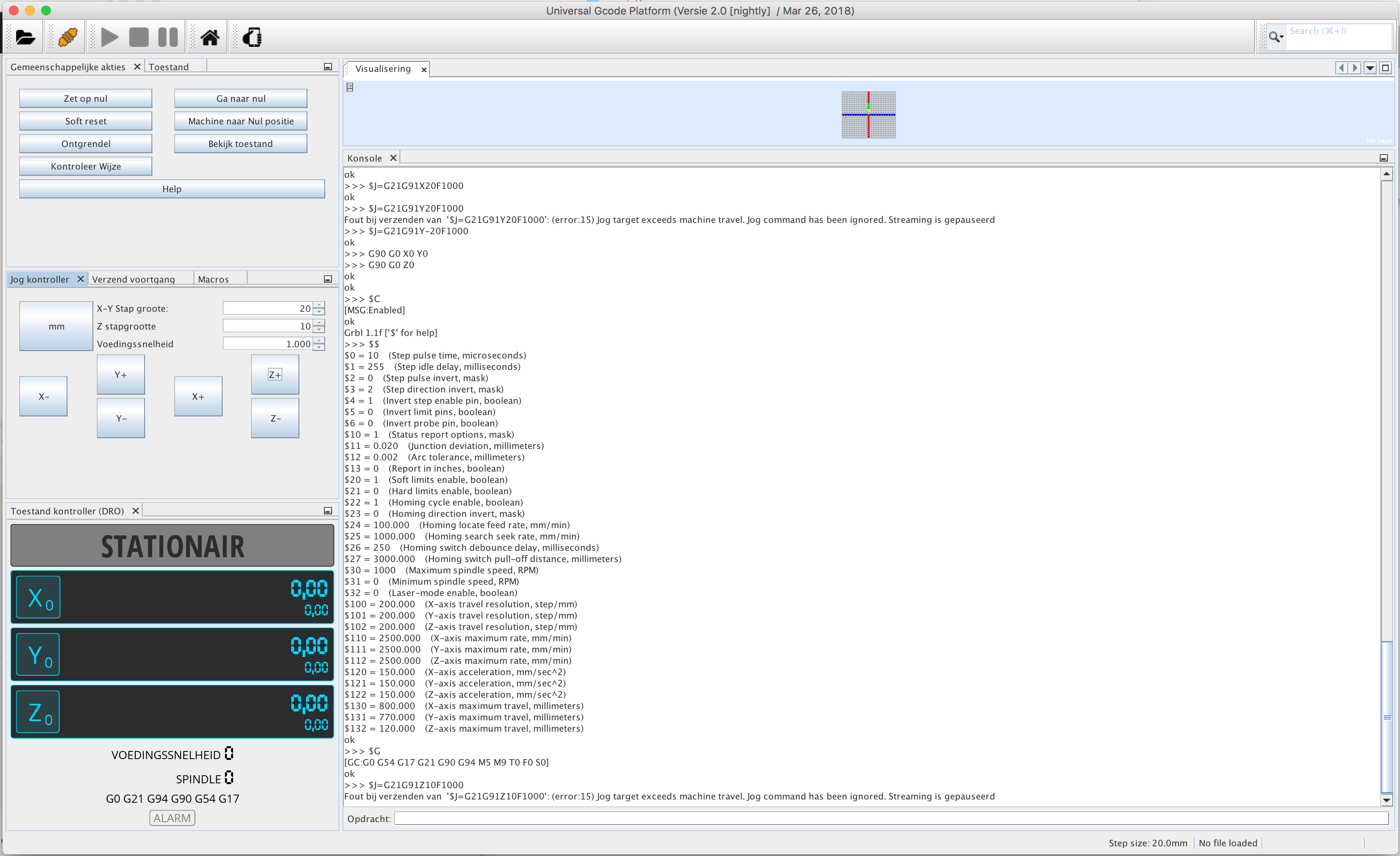

    Hi Vincent, you've done a great job and I agree with your positive comments about Ooznest, they're great!
    Regarding the $h sorry can't help with that one, I never got around even to fitting limit switches to my C-beam XL. In my opinion, a home function is not too much use, when you start cutting you will position your material somewhere on the bed such that you can reach all the regions to be cut, then you jog the tool in X Y to a convenient place on the workpiece; most often I use lower left corner, sometimes the centre. Then I jog the tool in Z until it's less than 1mm from the workpiece top, measure the gap with feeler gauges and program in UGS macro

    Hi,
    Glad you have had a positive experience with out machine so far. Could i get a shot of all your $$ settings to double check them?
    I a little stumped why it does that aswell, as you are correct it should home X and Y after. Are you using UGS? Could you try another one like GRBL Panel, just to rule it out.
    Ryan

    Okay I made a booboo.
    I 've set $27 on 3000 instead of 3.000..... #mybad..
    I was already composing an email and had to check the facts one more time. Guess I'm human after all :)
    thank you Ryan and Geoff!
