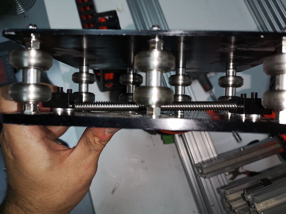

  3. Alex Chambers
    2,830
    1,389
    In addition to @Giarc 's comments (drivers are the most likely cause), look down on the Y gantries - is the leadscrew parallel to the gantry plates? One problem with the [knockoff seller] kits is that the spacers between the nut blocks and the gantry plates doesn't sit properly and the nut blocks are at an angle, forcing the leadscrew also at an angle. If you can't tighten the nut blocks to the plate then they are not doing their job. Likewise with the eccentrics - unless you can adjust them properly this machine will be unusable. Good luck and do come back with any further questions.

  4. Travis101
    Travis101 New
    Apr 29, 2020
    If I can't get this system up and running with what I have I am too deep now to not spend some more and get it working. It doesn't seem to be an overheating issue because it happens as soon as it's powered up. That being said i'm sure that will be another problem I will run into. As far as the CNC shield I soldered onto the proper pin to supply the Z-limit.
    Other than the Z-limit pinout is there a quality issue there? or should it be fine?
    Also I did send a message off to Bulkman3D support and am waiting for a reply
    I did add small spacers on both sides to get the lead screws looking closer to what looks straight to my eye. Not 100% sure what you mean by sitting at an angle, unless spacing like i did is what you mean. The eccentrics can be tightened and it still runs the same, I just loosened them all in hopes of solving this problem first.

  5. Alex Chambers
    2,830
    1,389
    This is what I meant - a picture of a problem someone else had with a SPAM workbee;-

  7. Travis101
    Travis101 New
    Apr 29, 2020
    Thanks for the pic, I have taken the Y-Axis Gantry completely off and ensured that this isn't my problem. I then leveled the machine and laid a level across the nut blocks and tightened them into place with the lead screw through both. After this I slid the Y-Axis Gantry back on and adjusted each eccentric spacer until every wheel moved on both sides. The machine definitely feels more rigid and smooth to move by hand, however I still have the same original issue when trying to jog the machine.
