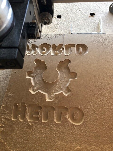

    Hello,
    just build a workbee!
    After having done many test Cuts and holes and been pretty happy with the results for now, I’ve run into a problem.
    I did a more complex job and it suddenly missed about 15-20mm of steps on x axis.
    The result wasn’t exactly joy... as the pic shows.
    I’m running it off a mks 2.0 cnc board with tmc2209 in chopcycle mode at 16th step resolution.
    when jogging and doing tests the drivers run completely cool. however when I did the bigger job they start to get warm. Not too hot to touch, but noticeably warm.
    I’m running Grbl1.1h and controlling it via usb, which hasn’t given any problems so far.
    the machine has some occasional resonance when jogging over 1700mm/sec, which seem slow to me. But I decided to ignore it for now and stay under 1000mm/sec where it runs super smooth.
    Any suggestions on where to start hunting down the failing parts would be very welcome. :)

    1.7A peak drivers are more suited to NEMA17s and 3D printers
    Consider the OpenBuilds Blackbox with 4A peak, 3.2A RMS as more suited to the typical CNC application

    Hm. That’s fair input. What’s the black box based on?
    I was wondering if I should go for dedicated drivers with closed loop steppers if I need to upgrade anyway?

    yes. I was considering closed loop steppers. Can you drive them with the std. grbl/arduino board just by using the four pins (en,step, dir, gnd) by the stepsticks. or do you need a different kind of feedback from the drivers?
    And just a newbie question, how does the drivers compensate for a missed step? Do the just keep the signal until the motor responds?
    Or how does that actually work?
    I like the idea of running closedloop steppers. It would definitely be a good upgrade.

    Yup! Same as all stepper drivers. Same thing is happening internally in the BlackBox, but you can't just buy a "Muscle" (drivers) board without a "Brains" (basically an Arduino Uno) board, though I suspect a lot of people- who are sufficiently advanced enough in their journey not to necessarily be advantaged by a full-aftermarket-service integrated solution and also understand the downsides of integrated solutions- would buy one.
    This is part of the reason why they run cooler- the driver increases the current upon resistance, to try and power through it, but if it doesn't work, it cuts power to the motor entirely until you power-cycle it. This is a very fast process, and may in certain circumstances help stop you damaging your machine. It's not a replacement for limit switches though!
    I explain them further in the thread I quoted from, actually. Explanation post here: ARC issues with grbl
    What I can do/have done before which doesn't quite fit with my understanding of them just yet is when you have a hex wrench on the motor shaft coupler/pulley/whatever, you can just pull the motor around with it, but then it'll return to its previous position. It's a neat party trick, and really exemplifies the servo nature of the system, but I'm not 100% sure how it doesn't error out the driver- that's a LOT of unanticipated encoder steps.
    I like them a lot. Like I say in the other thread, I don't think they're necessary for NEMA 17 projects, but I doubt I'd use anything else for NEMA 23/24/34 projects at this point.

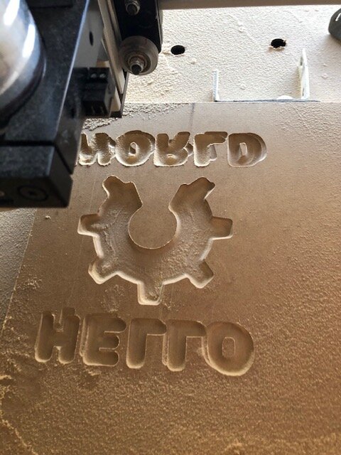

    This is mirrored ??/ mirrored.jpg
  13. Peter Van Der Walt
    15,632
    4,462
    Invert the directions thats wrong

    Finally got my new closed loop steppers. And voila, it cuts like a champ! :)
    I can push it quite hard, and no problems with lost steps or anything. The weakpoint on that account is my 500w china spindle - but so far it's really not an issue.
    so, great thanks, Rob, for suggesting closed loop steppers.
    Next up is getting the rs232 cable to actually configure the drivers :)
