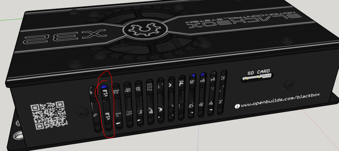

    Which version of the BlackBox do you have? (X32 - could be V1.2 or V1.3)

  7. Matt McG
    Matt McG New
    Sep 28, 2023
    56
    Where can I find the version#?
  8. Peter Van Der Walt
    15,647
    4,472
    Peak into the Vents on the side :)

  10. Matt McG
    Matt McG New
    Sep 28, 2023
    56
