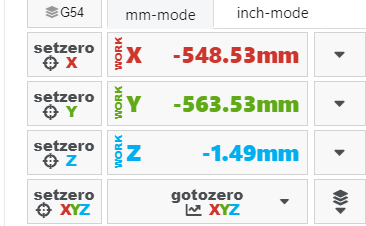

    Did a fresh USB-plug-in and Home in CONTROL and the positions I get back in are some strange numbers. For clarification, soft limits are enabled with X=550; X=565 and Z=50 mm each. So I don't even know why I get these numbers. X and Y are at least close but Z is completely wrong.
    If I click on the Z probe button right after it finished homing, it starts, but stops quickly with the error: 15 message stating that the jog target exceeds machine travel.

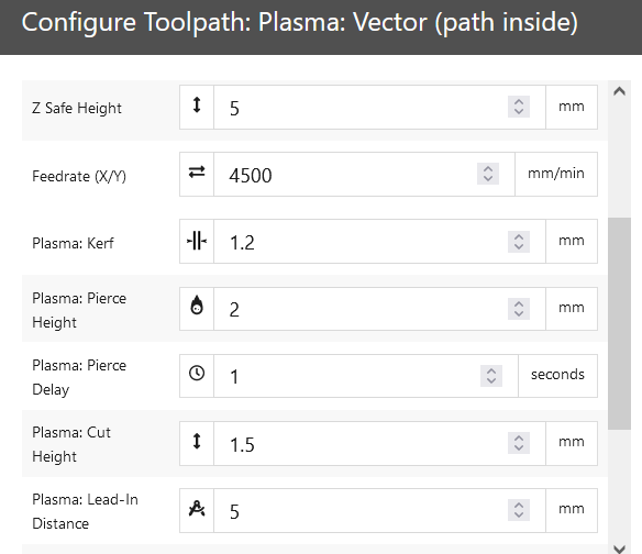

    About the CAM settings, here you can see them:

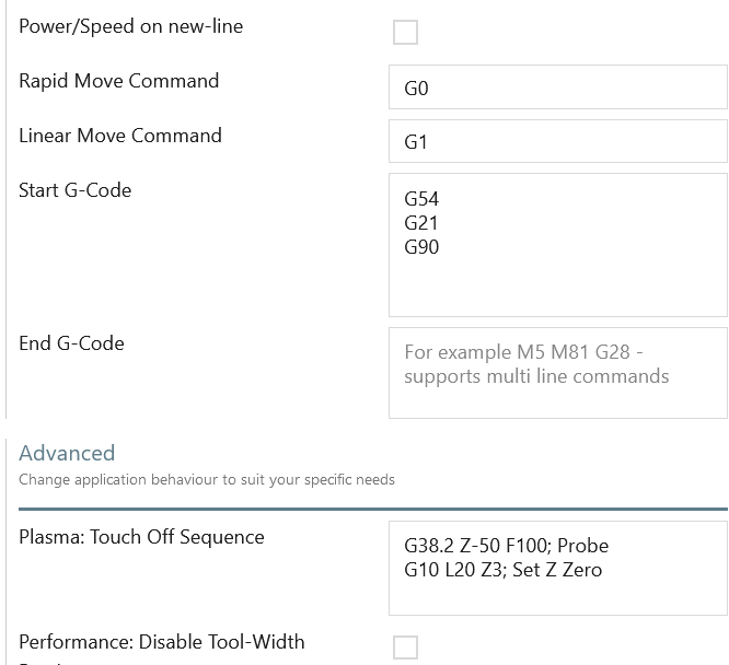

    The probe code was the same as I mentioned earlier:
    G38.2 Z50 F200; Probe
    G10 L20 Z0; Set Z Zero
    Did these inputs help you clarify my problem?

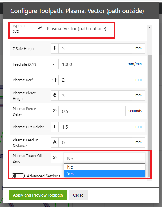

    If you want to use touchoff you also need to define your Probe Macro in SETTINGS. And enable Touchoff in the toolpath
    The DRO values just indicate you haven't SETZERO yet. See Frequently Asked Questions · gnea/grbl Wiki

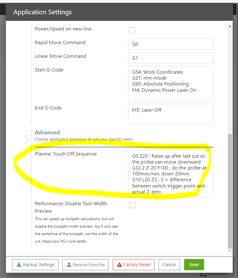

    Still waiting on you to screenshot me your macro :) - OpenBuildsCAM > Settings tab > Settings button > Plasma: Touch Off Sequence
    For example mine: (yours will be different - experiment until you have a macro that perfectly zeros)
    and also make sure you are telling CAM if you want to use the macro: along with proper CUT HEIGHT, PIERCE height etc

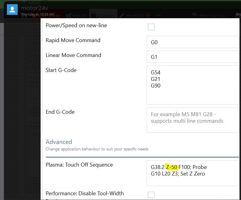

    Yes... but see: (from your screenshot on Thu)
    You want to G38.2 Z-50, Max travel = 50.... Where do you think Grbl should move to if the limit is 50, but you want to move by 50mm. 50-50=0 - and thus the cause of your error.
    Thus:
    I'd suggest you either Disable Soft Limits until you understand them better, or set Max Travel higher
