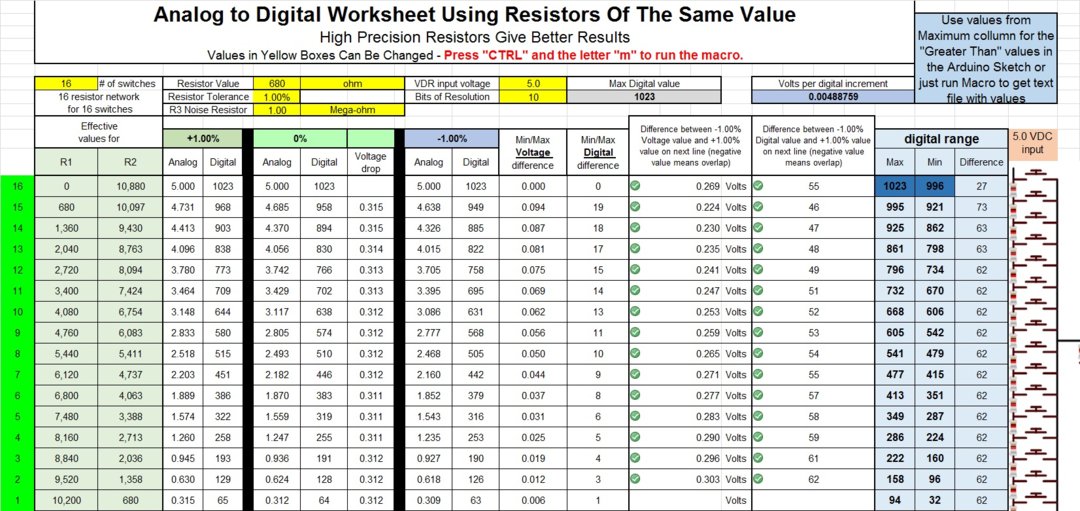

Below is a screen shot of the spreadsheet that I made to calculate the values. (this is my first post here and I could not figure out how to embed the screen shot so refer to attached files) My first breadboard prototype only has 16 switches and with 0.1% resistors there is no overlap in the values along with about a 60 point window. In the circuit that I built later I used 1% resistors and all of the serial monitor reported values were within 2 points of the calculated 0% value.

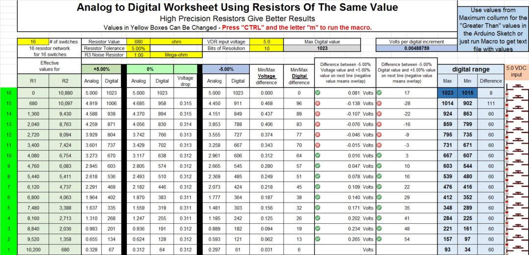

In the next screen shot you can see the effect of +/- 5% resistors, a few switches have an overlap that may affect which signal gets sent to the board. Again, this presumes you did not measure the actual resistor values. The first spreadsheet tab uses the same value for all the resistors. There is a second tab in the spreadsheet that allows you to enter the actual measured values of the resistors you pull out of your junk box. The spreadsheet also has a macro that will kick out a text file with all the values ready to be copied and pasted into your Arduino Sketch which makes for easy updates.
I mentioned earlier that you are not locked into 32 buttons and you can see that I setup a bread board with a 16 button prototype. While testing I noticed that the digital value only varied about 3 points at most when any button was pushed, this is where the serial monitor feature came in handy so that the value for each button can be seen. At idle while waiting for a button press the noise value was about the same 3 point amount. A 16 button setup has about a 60 point window and a 32 button setup has about a 30 point window. Just use the spreadsheet and enter the number of buttons you want and it will calculate the window value along with the “greater than” values in the Arduino sketch. If you were willing to have a 10 point window you could get 100 buttons to work. The spreadsheet is currently only setup for a maximum of 32 buttons but you can just copy and paste the formulas to get more buttons. Page protection is turned on but there is not any password so you can unlock it easily. If you add buttons to this, you will need to unhide column “A” and you will have to do a lot of manual editing to keep the Macro working with the extra buttons.

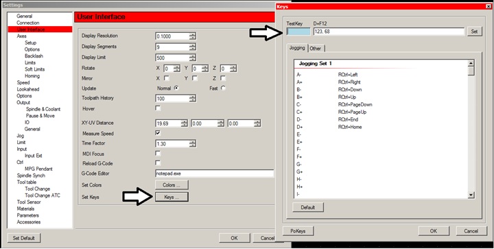

Now getting back to the Planet CNC software, also linked to the MDI feature in the Planet CNC software is the ability to setup hotkey combinations that do the same thing as clicking on the icon or typing commands in the MDI window. In the screenshot below you can see the first of three jogging set commands. Even though this window shows axis A, B, C etc. it is actually axis X, Y, and Z, not sure why it was labeled this way. The default setup for jogging the X axis to the left is to hold down the right hand “CTRL” key and pressing the left arrow button. This can be edited to any key combination you want. There are some commands that have a four key combination by default. So this makes it possible to edit this set or use one of the other two sets that are available to create your own custom combination set with any combinations you want. For the functions I want to setup I decided on a two key combination that uses the F12 key and the letter keys “a” to “z” and numbers 0 to 5 for a total of the 32 combinations that could be used.
In the screenshot you can see that the setup for defining the hot key combinations allows you to press a keyboard button and the program will show you the key code numbers. I thought that I could just use the same codes as the standard ASCII codes but those don’t include the Function keys. So I tried using the same number that showed up in the “test key” window thinking that would work but this is where something unexpected happened. On the screen you can see that the ASCII key code for the uppercase letter “D” shows up correctly as 68 and the F12 key is showing as 123 which is correct for some systems based on a google search for that topic. The problem that I ran into was when I sent 123 from the Arduino the key code for the open bracket symbol “{“ is sent along with a left shift key command which is the correct ASCII code combination for the bracket symbol. If I send a 68 from the Arduino the test key window shows a Left Shift “160 + 68”. To get just the upper case “D” the Arduino has to send ASCII code 100 for a lower case “d” then the Planet CNC window shows code 68 by itself. So the work around to solve this problem is to use the lower case codes in the Arduino software and the upper case codes in the Planet CNC software. Now for the F12 key code; in order to find out what code is used for the F12 key a second program was written to increment the key code by one at a time using a normally open switch between ground and pin 2 on the Arduino, and send the code to the test key window and the Arduino serial monitor at the same time. This showed that the Arduino has to send code 205 to get the F12 key command in the Planet CNC software where it is recognized as 123. This “key test” program will be included in the files section if you want to try it yourself. I also included the list of codes in the spreadsheet with the resistor calculations. Although there is something strange going on here, and I think it has to do with how the Planet CNC software recognizes the code sent from the Arduino or the keyboard, the work around is simple enough that I don’t plan to pursue finding the cause of the problem because I don’t think I could do anything about it anyway. When you go to setup the hotkey combinations in the Planet CNC software just have the pendant hooked up and press the button you want for each function you want to use and let it record whatever shows up and click the set button.

So here we go, since getting the EXACT digital value needed would be wishful thinking, the decision was made to use a range value that puts the ideal value smack dab in the middle of the range. The simplest way that could be found was to use a maximum value and to use a command of “IF value X is greater than value Y THEN GOTO next section else do the code in this section”. If the value of X is still greater than the value of Y for next section then GOTO the next section after that and so on down the line until it hits the correct section.

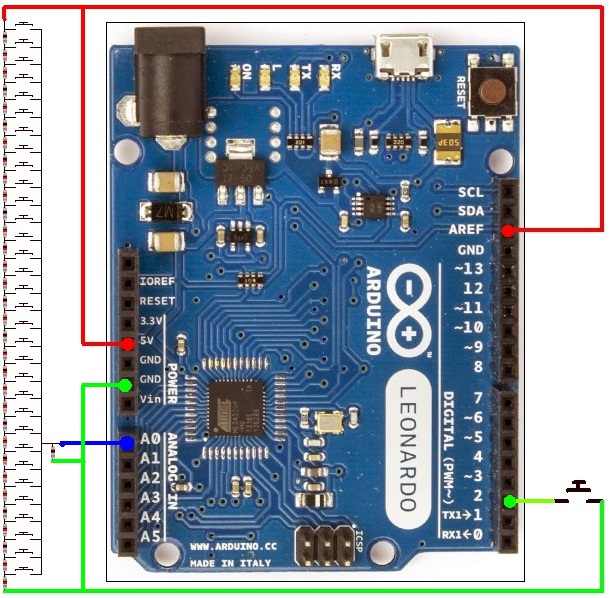

The wiring diagram is pretty simple and just look at all those unused I/O pins just waiting for something to do. The button circuit and the Arduino is powered through the USB connection to the computer. Not all Arduino boards can use the keyboard function. Boards that use the 32u4 or SAMD chip such as the Leonardo, Esplora, Zero, Due and MKR boards can use the keyboard function which is needed for all of this to work.
I decided to make a shield PCB board for the resistor network and for the connection to the Arduino when I came up with the idea to use 2 separate boards. One board will be for the resistor network and buttons and the other will be an interface “shield” that mounts on the Arduino board and they are connected to each other using a standard Ethernet cable that are easy to get and in a variety of lengths. This would allow the Arduino board to be mounted near the computer and the pendant would have the resistor network and buttons. This is where I made a major blunder when I was laying out the board in the Express PCB software. The circuit was simple enough and I didn’t have a lot of time to work on it that I went right to the board layout without drawing a schematic. The plan was to use a 40 pin IDE hard drive cable to connect between the buttons and the resistor board. When I drew it up I put the 5 volt supply and ground on the wrong ends of the resistor network so when I plugged it in none of the buttons were doing what I expected. With this mistake I had to decide whether or not to get new boards made, unsolder all the wires and rearrange them, or edit the software. New boards meant more money and all those little wires were a pain to solder to begin with so the idea of redoing all of that did not thrill me, so I just moved the blocks of code around to match the function that I wanted with the button I wanted to use. This is where the serial monitor code really paid off because I could easily identify which button was being recognized. The Arduino code I included on the Open Builds site is the original code and the Express PCB board file that I included has been fixed so if you decide to use it you should not have to change anything but if something goes wrong you know that you can just rearrange the code to get it to work.
When I was making the video I found that there was a lot more noise on the signal when everything was hooked up to the mill I was using. I was able to adjust the noise filter level in the software from 10 to 25 but if there is more noise when the spindle is running I may have to add a noise filter to the circuit.
