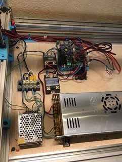

- The Duetwifi is a huge step up from a RAMPS system. Once it's all wired up and running you never have to touch the hardware. Everything is done through a web interface. Every bit of configuration is done through the Reprap firmware web interface using text files and macros.

- Duetwifi ARM based controller

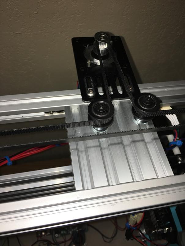

- DUAL X-axis pinion drive for maximum X movement

- 110VAC silicone heatbed

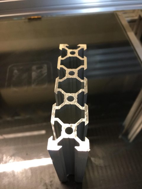

I found out half way through the first iteration of the printer that Openbuilds will always give you at least the length you purchase but invariably it's a few millimeters longer. Rarely are two pieces the same length which tends to make it tough to get things to align. Needless to say, I now cut all my extrusion to the length I need. I order it from Openbuilds in 1000-1500 mm lengths.
As with anything you make, having the right tools makes your life much easier. After a bit of research I soon found all that I needed was a high quality blade for my 10" miter saw. This is the one I bought. Don't cheap out, it's not worth it in the long run. Now I can cut V-slot just as easily as I can cut a 2X4. Don't forget to use cutting lubricant of some kind.
Example of the cut quality with the Freud Diablo blade

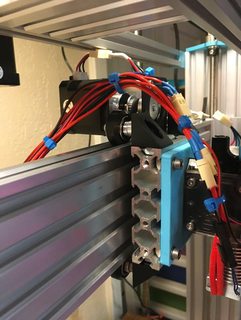

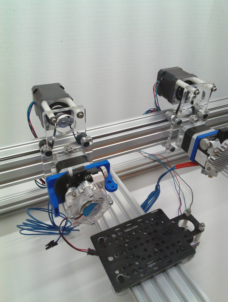

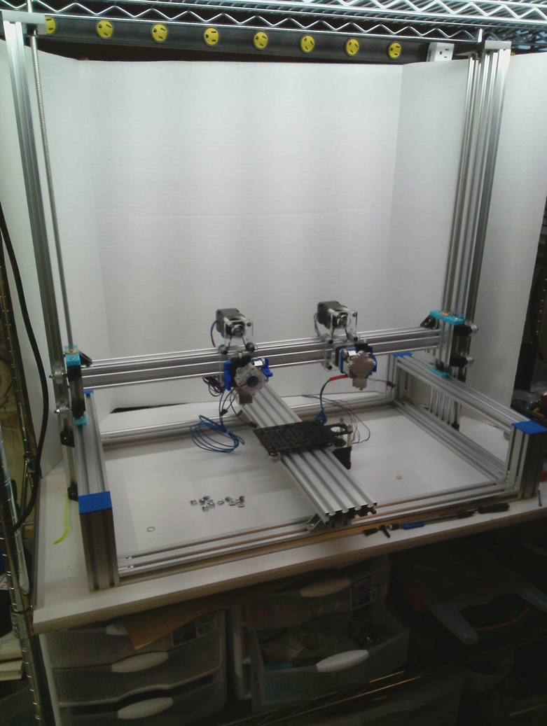

Closeup of single X carriage. I made the carriage from laser cut 6mm acrylic and incorporated an adjustable motor plate so that the verticle height can be adjusted to align the nozzles.
Both X carriages sharing a single belt. They can move simultaneously and in different directions. Here is a link to Openbuilds pinion drive video that convinced me that this will work.

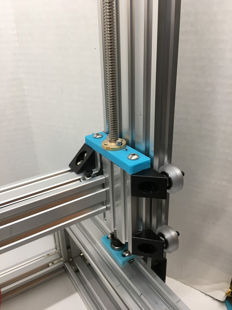

Closeup of Z axis carriage. I cut a section of 2080 V-slot to use as a carriage. It makes it easier to mount stuff without having to insert screws through the back of a standard plate. I also make a plate to mount a standard brass leadscrew nut. I'm experimenting with a 2mm single start leadscrew to get maximum resolution out of the Z axis.
The Z axis is driven by a single 0.9° (400 per revolution) NEMA 17 motor driving both leadscrews through a continuous endless loop GT2 belt. Belt adjustment is very easy. Combined with the 2mm leadscrew screws give the Z axis a step length of .005mm. At 1/32 uStep that gives 6400 steps/mm.
