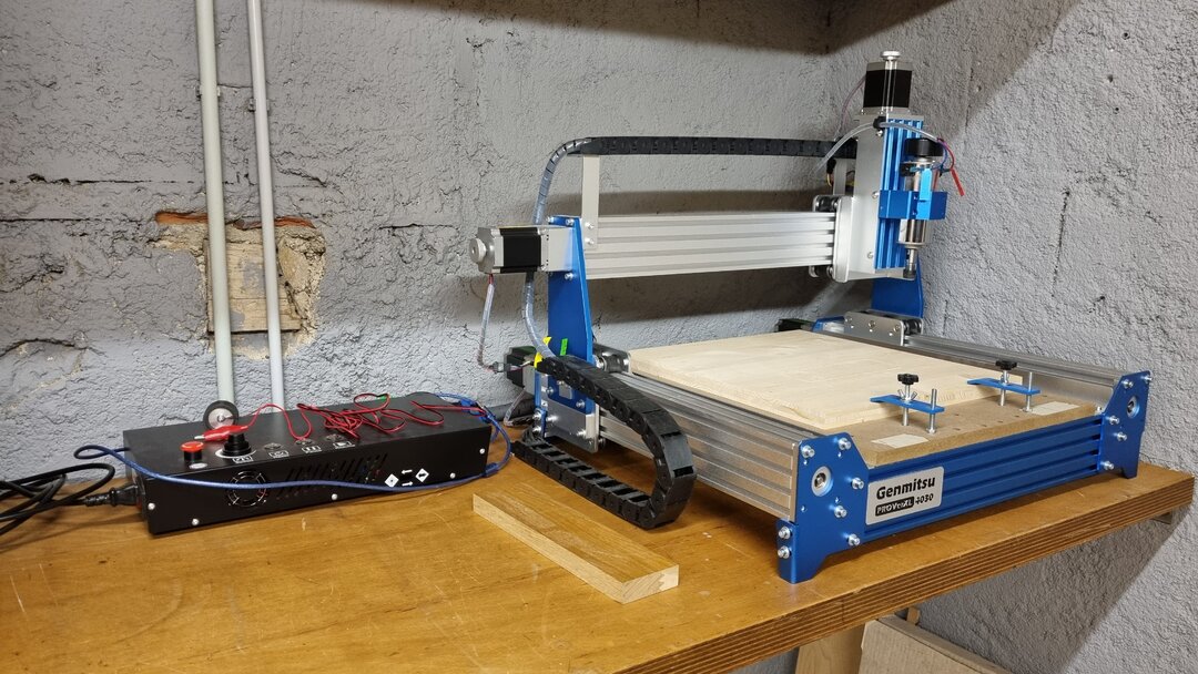

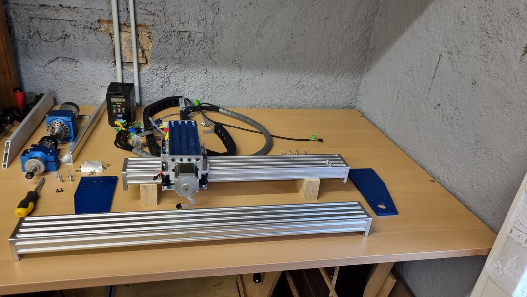

      Here is the story of my first Genmitsu 4030 V1 CNC Build Initiated in 2022.

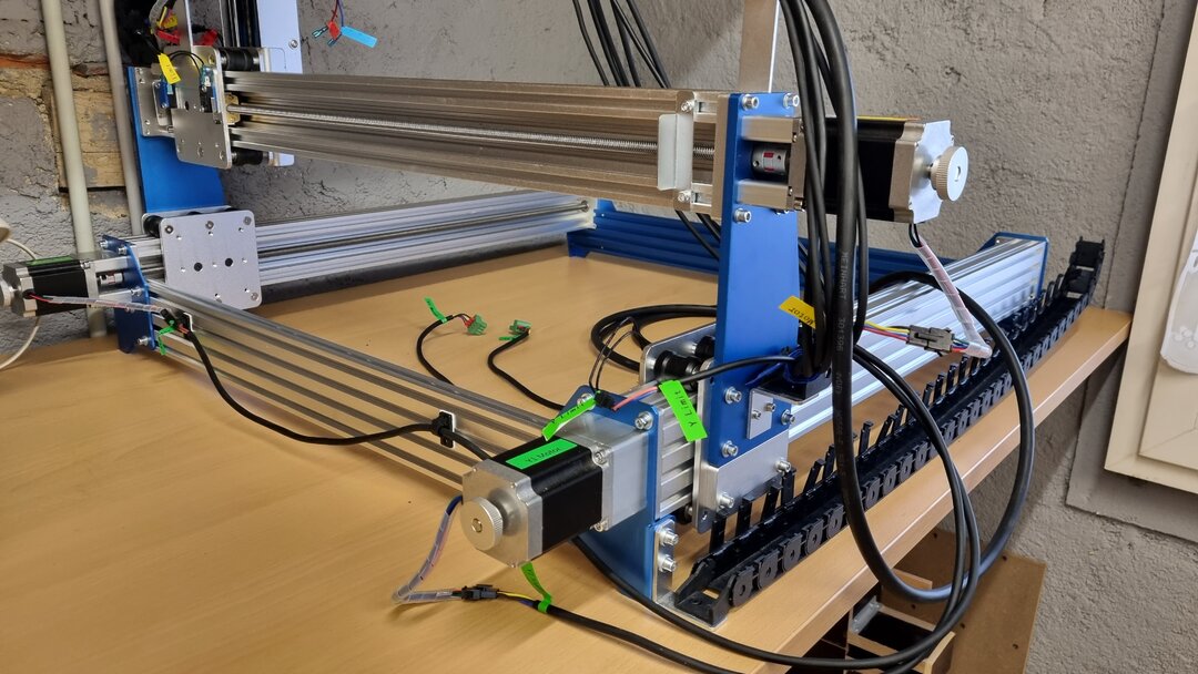

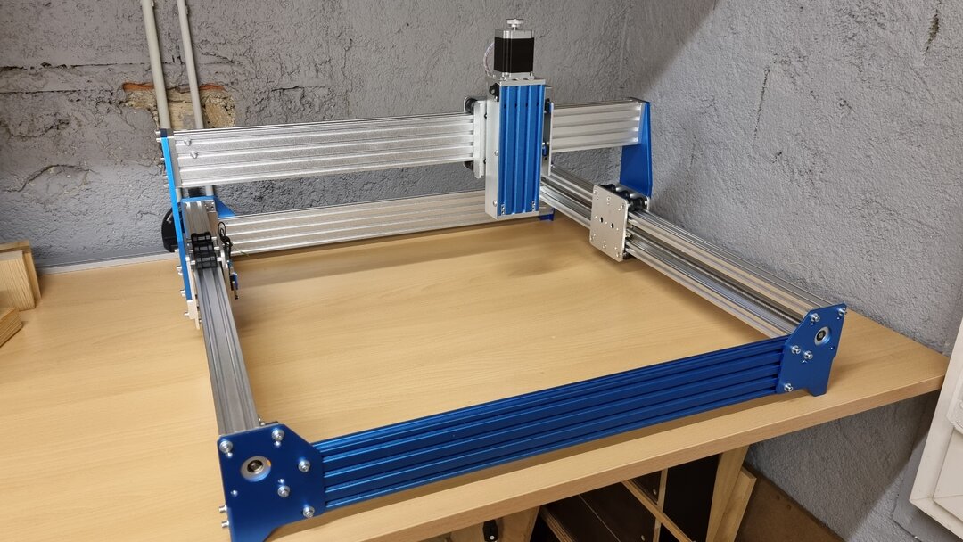

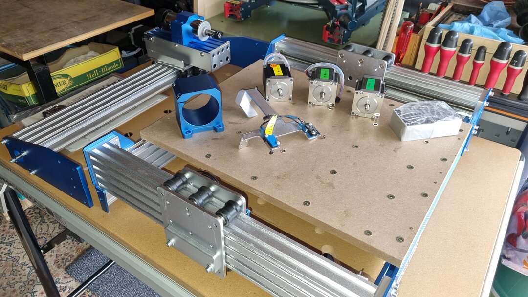

      A Chinese box pre-built kit, it worked for my learning for 3 months and I dismantled everything to upgrade it into 600x600 with a hybrid bed. Why 600x600 ? For lack of space in my little workshop! I consider 600x1500 for the future.

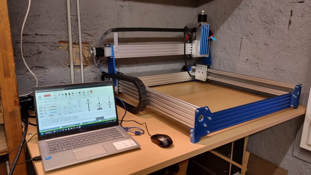

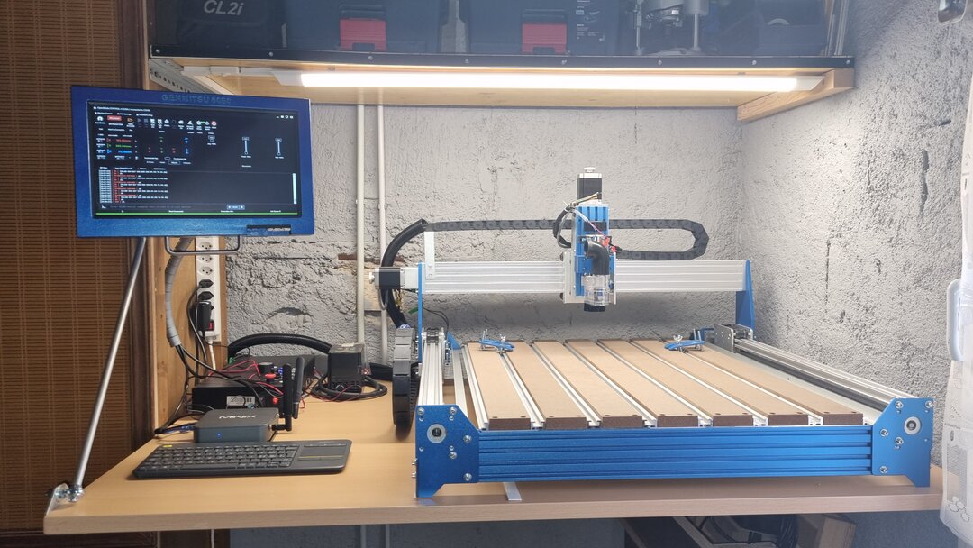

      In this time, things have evolved, the most urgent was the Chinese Spindle 1.5kW with VFD which allowed more important achievements, then the modifications for the management of the machine, on the internet, this subject of machine management is a real Jungle and my curiosity quickly turned to Openbuilds, I did not know this system and it had been two months since I studied this solution which was the right one for my expectations.
      Today all is 100% managed with openbuilds technology and I am completely satisfied with it, I am satisfied with the machine, the results obtained with my skills level and I am proud to have chosen OpenBuilds.
      In the near future I will install an automatic tool change kit. Solutions with high-performance controllers exist but I hope to be able to control with the Blackbox X32, technically this controller has a very good design and I hope to be able to develop the machine without having to go to another controller.

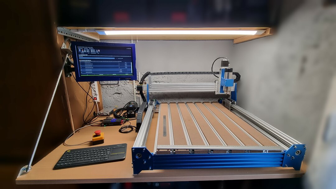

      August 2022 - Sainsmart Genmitsu ProVerxl 4030 - OpenBuilds Control
      January 2023 - 6060 extension - 1.5 kW 400 Hz and VFD A2-8015 spindle - Vectric VCARVE Pro
      March 2023 - PC interface Minix NEO J51-C8 Asus VT168HR 15 " touch screen - Hybrid Bed
      April 2023 - Blackbox X32
