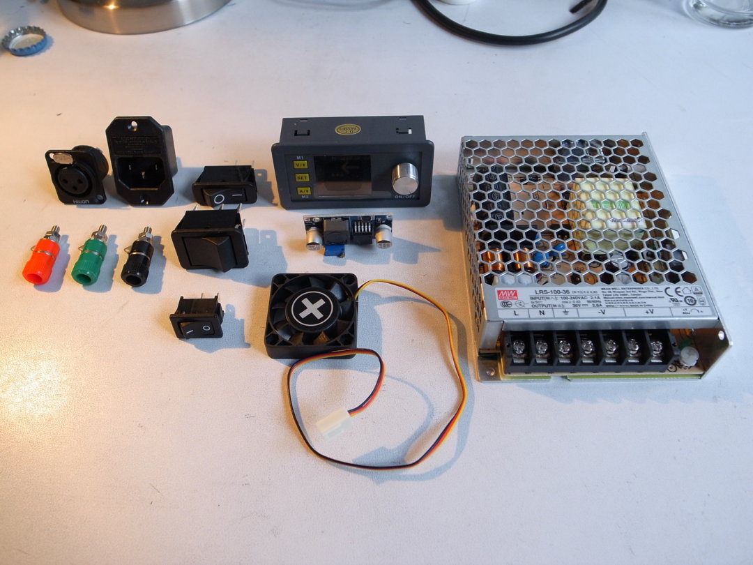

      1. Components laid out
      Before planning how exactly I will arrange the components in the case, I laid out everything to get an overview and rough idea of placement.

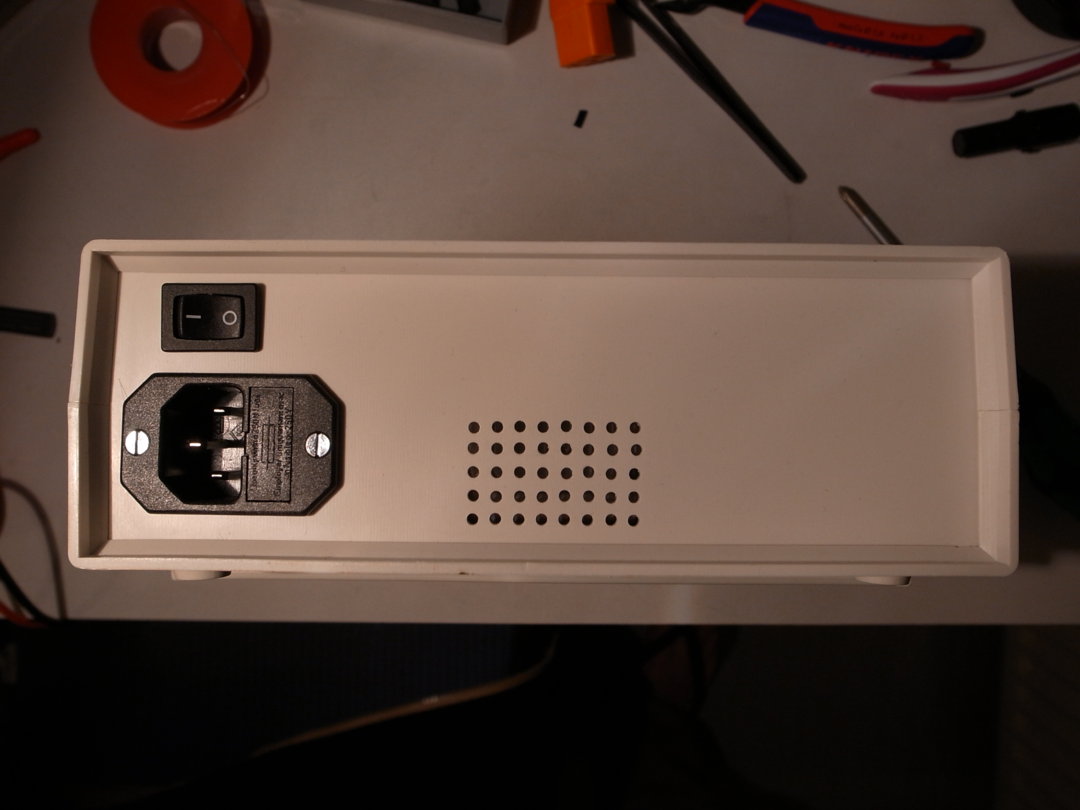

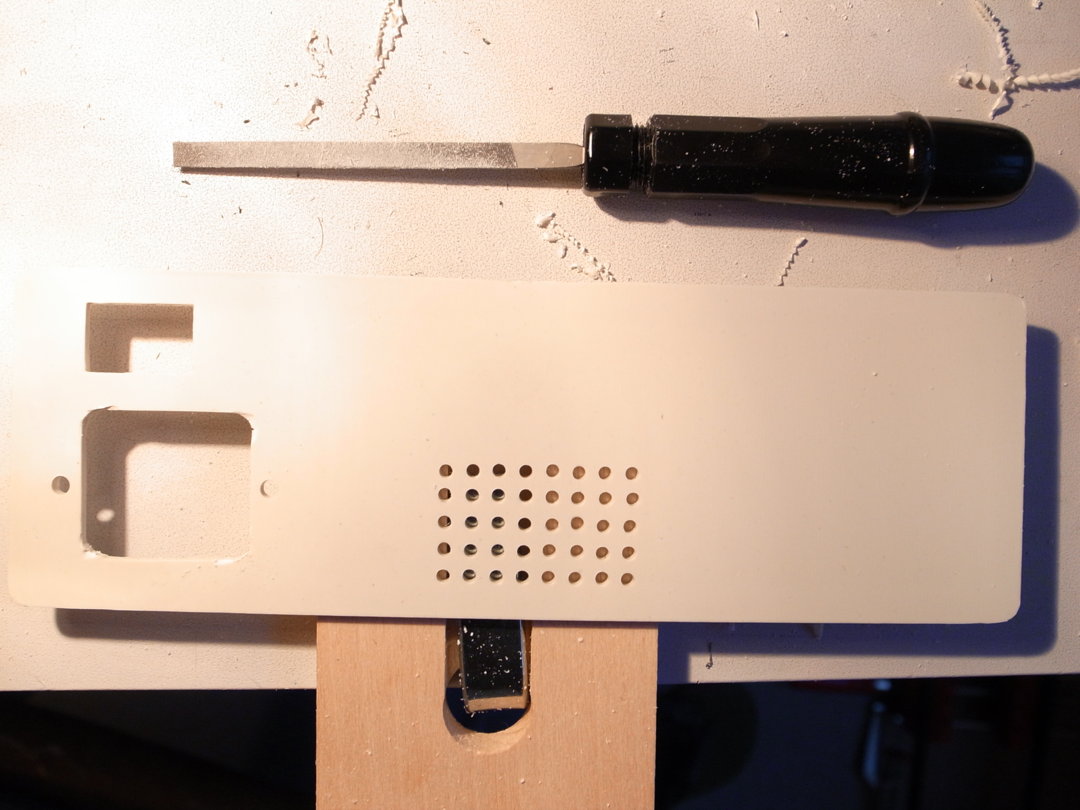

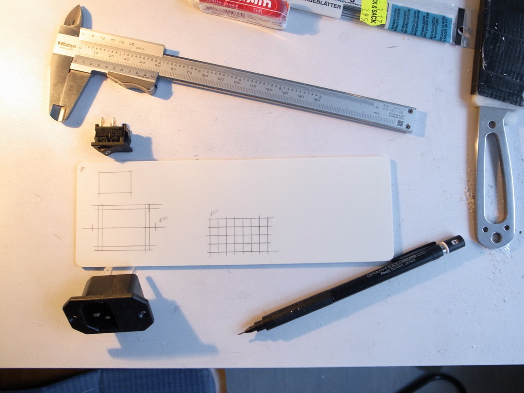

      4. Manufacture
      From the drawings, I transferred necessary information to modify the raw case onto the case components. With a hand drill, fret saw and a file, I made all the holes and cutouts.

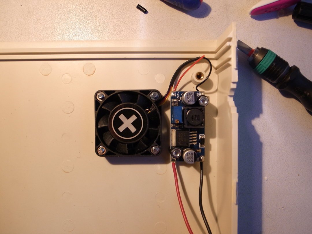

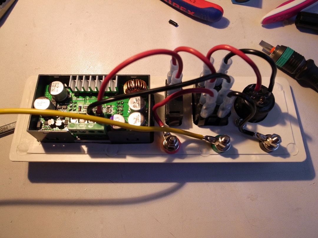

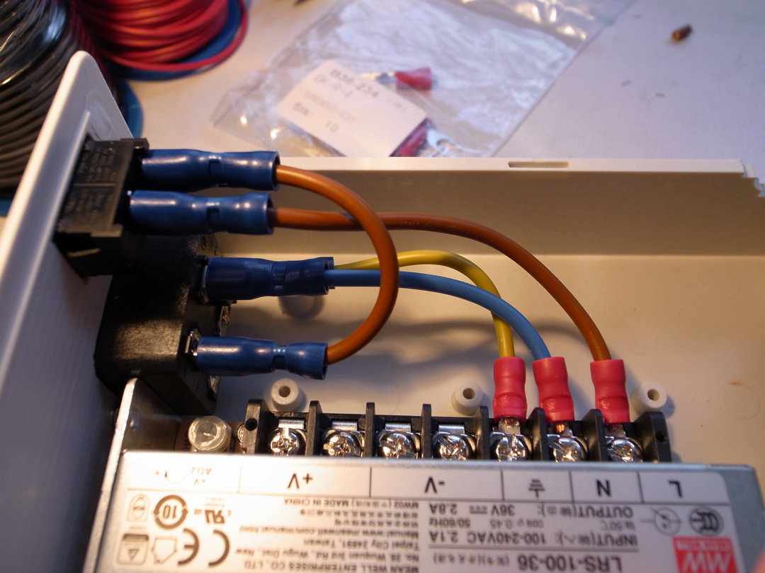

      5. Mounting components and wiring
      Components are mounted in place and wired according to the wiring schematic. I used proper connectors and ferrules wherever possible. You should, too. These little things increase the reliability and repairability of your project.

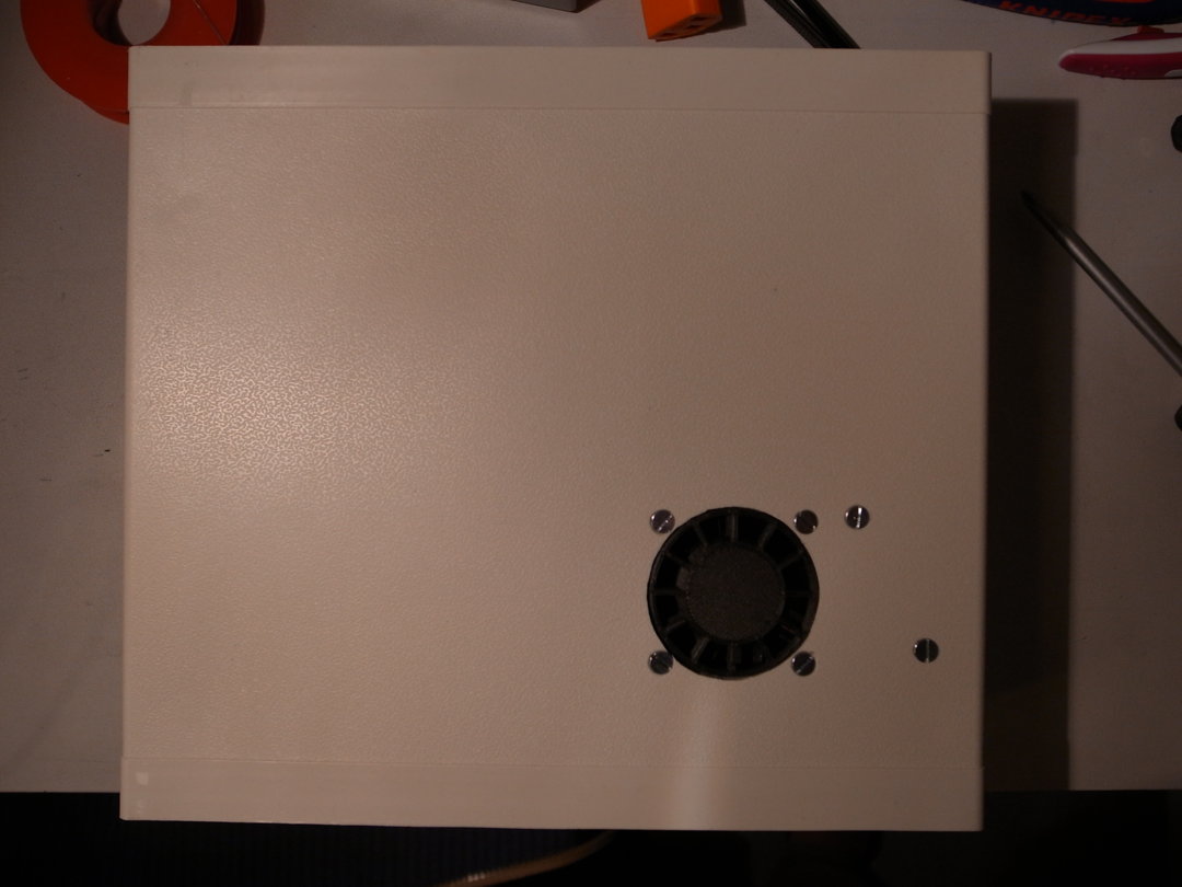

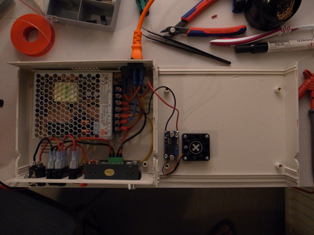

      I mounted the fan so that it blows out of the case. Its purpose is to generate an air flow, drawing air from the openings in the case. Since I did not have a 40 mm fan grill, I printed one. The BOM specifies a standard wire fan grill.
      6. Fan setup
      Since the DC-DC converter for the fan can only be set under voltage, I set the trimming potentiometer to the lowest setting, activated the power supply and used a multimeter clamped to the output of the DC-DC converter to set 12 V as output voltage.

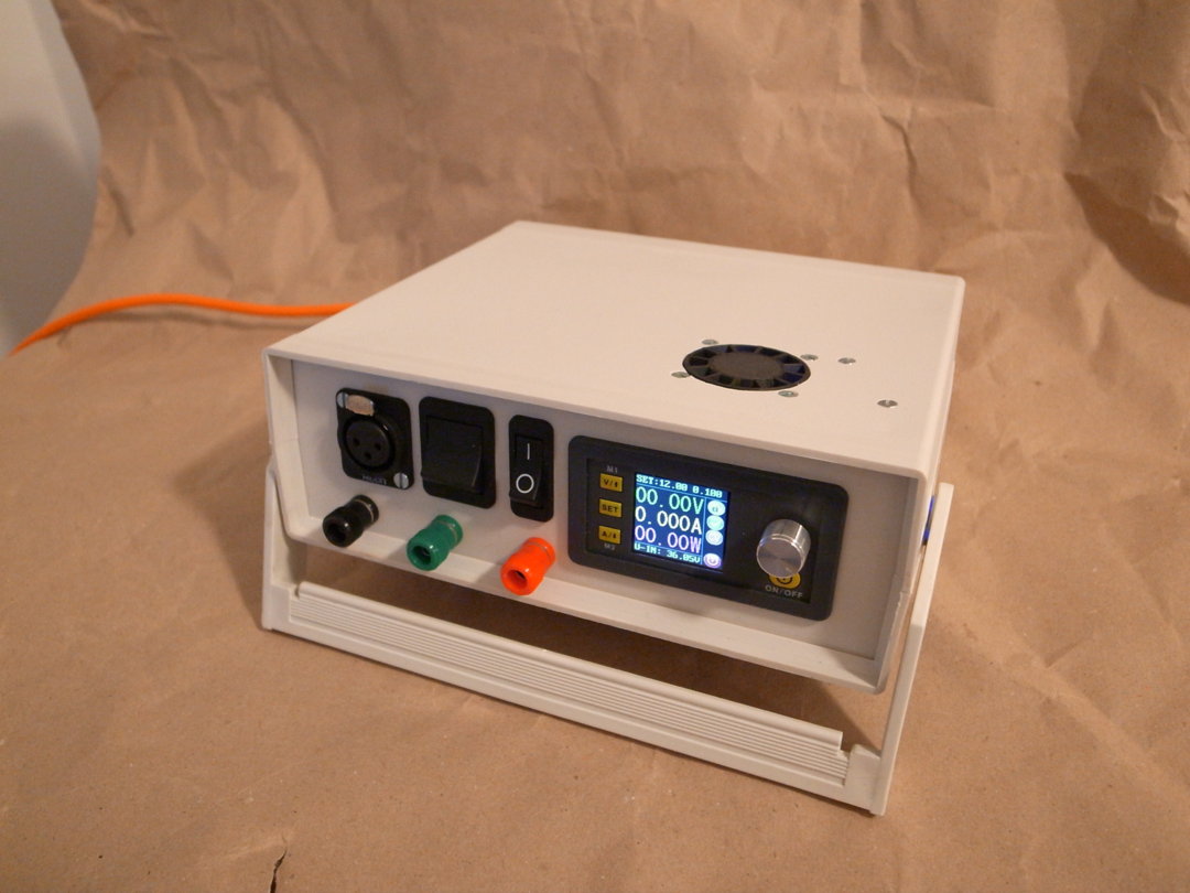

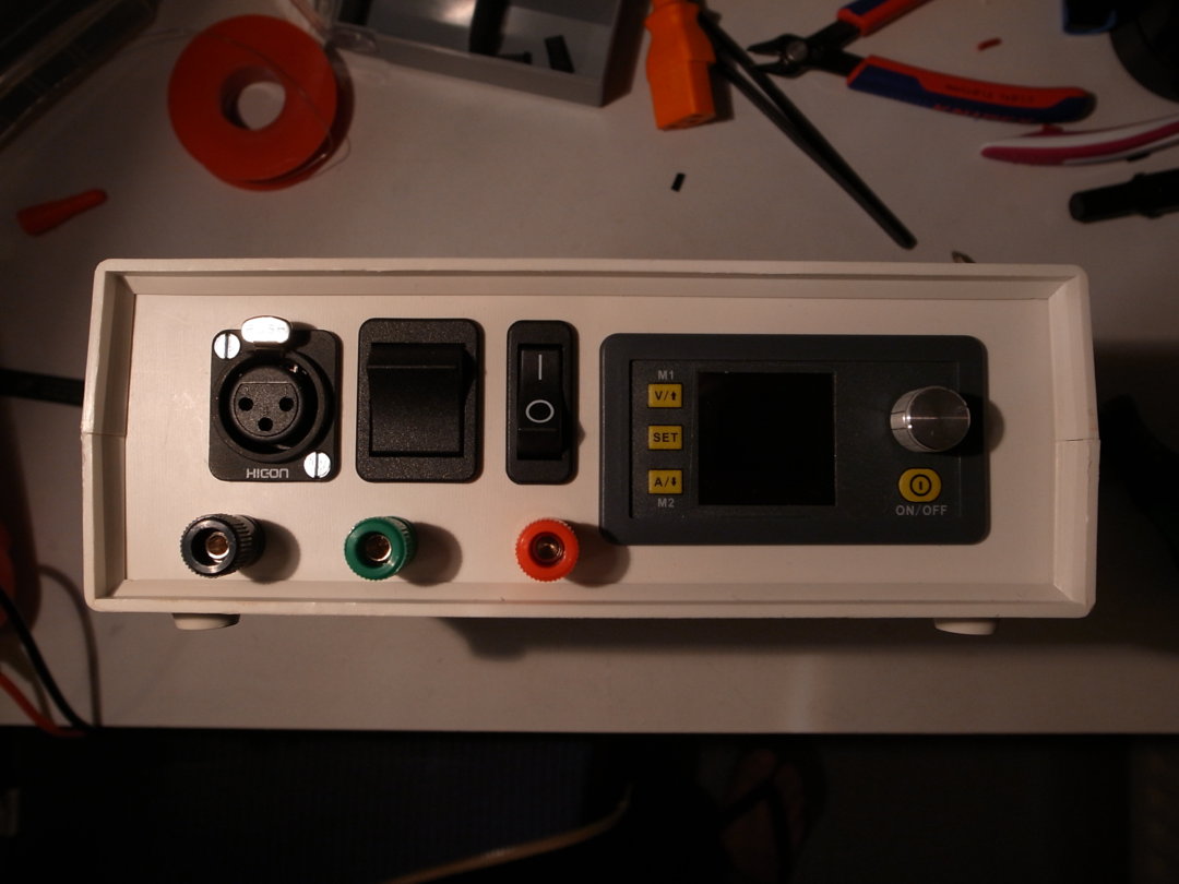

      7. Finished
      The lab power supply is now ready for usage.
