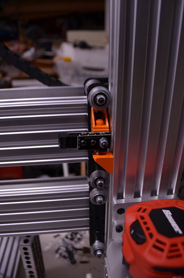

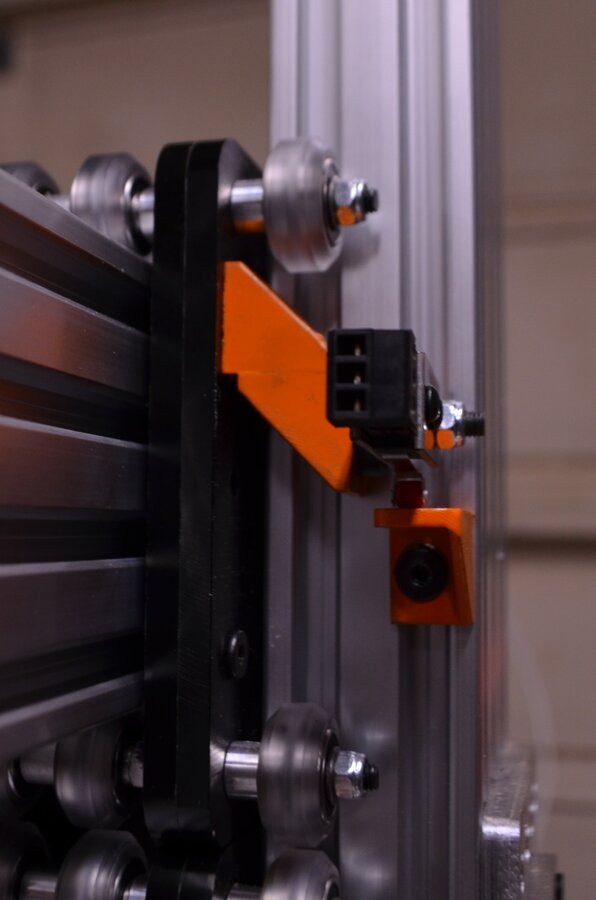

I made a limit switch assembly out of three of the aluminum Cast Corner Bracket s. If only I would have watched an assembly video or two and I would have known there was a much easier (and cheaper) way. But, then I wouldn't have a cool orange mount. I did have to sand one down to make it narrow enough to not interfere with the wheels.
