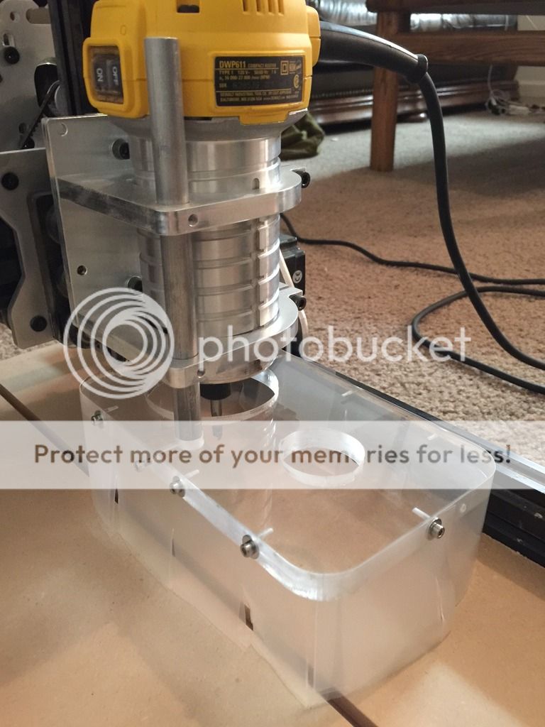

Laser cut some .46" acrylic to make a dust boot. I used "Report Covers" from Walmart for the flexible sides, two layers thick. I purchased the .5" aluminum rod off amazon for $5.
