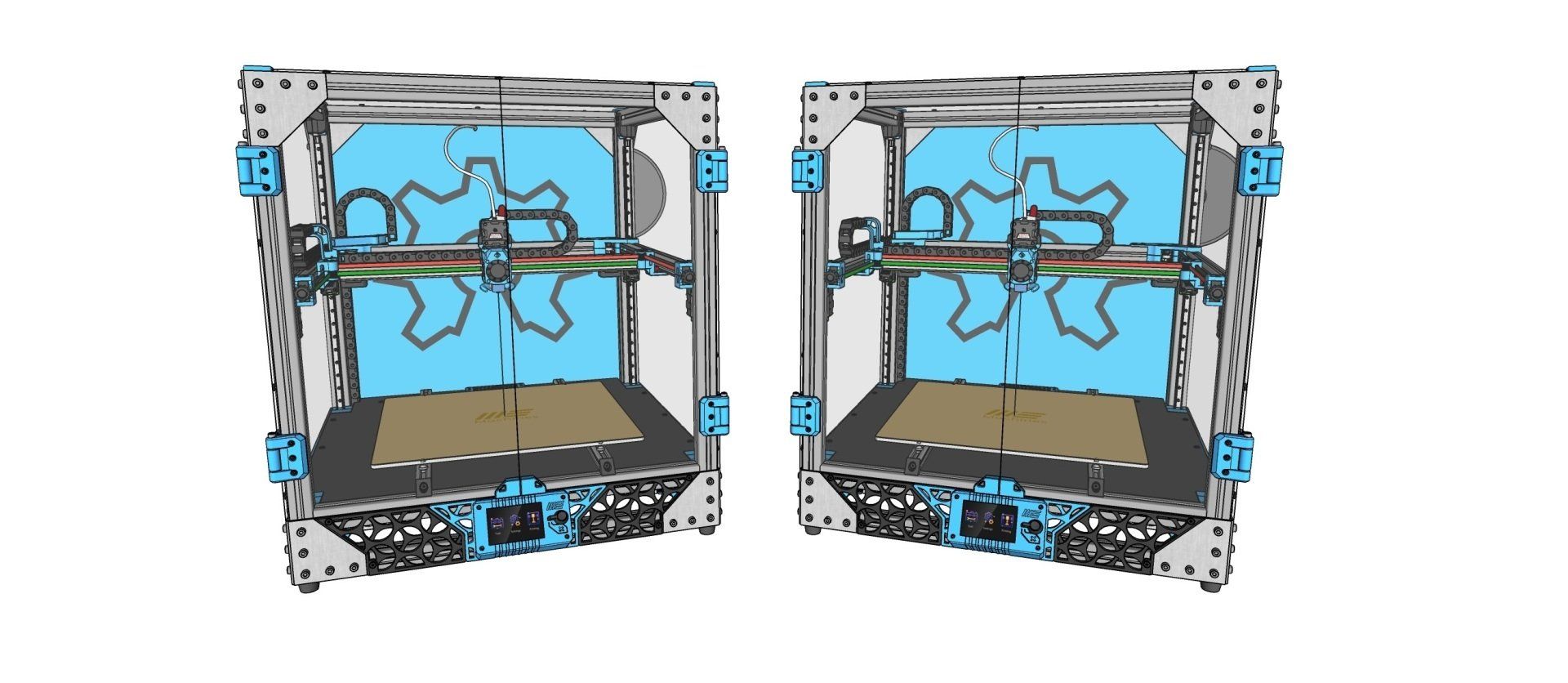

I wanted to make my own Voron, so I made my own Voron, this is my drawing of a CoreXY printer that uses the same principle as Voron in terms of mechanics...

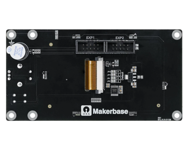

- Board Makerbase MKS-Monster 8 with silent TMC2209 drivers

For the board I decided to use the MKS-Monster 8, it's an 8-axis motherboard, which supports Voron printers and can run Marlin and Klipper firmware, so I thought it was perfect for this machine that is trying to be a voron variant
For more information about this board you can consult the official page Makerbase as well as the page GitHub.
If you want to buy this board please use my affiliate link, it helps my project a lot - Link to AliExpress

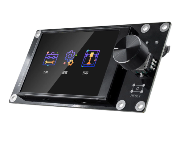

Touch screen display model
For display use the MKS TS35 V2.0 is a 3.5 IPS resistive touch screen...
3D model and Bill of materials
If you're thinking about building your own ME - Core XY you can find everything you need on my web site ifixgadget.pt/me-corexy
I'll leave the link to the 3D model I made in Sketchup as well as the BOM list and parts for 3D printing.
