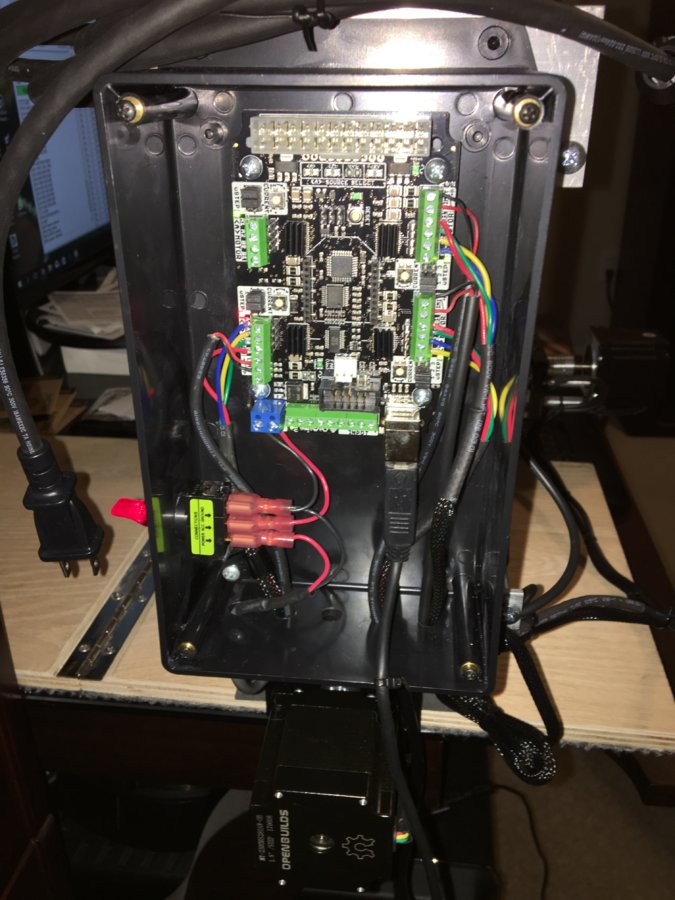

This is a stock MiniMill with limit switches on all 3 axis and a Makita RT0701C router. I chose the Makita because of its range of speeds, which I think will be an advantage. Everything seems to be working as designed and I look forward to making some chips. I also have grand plans to make it bigger by expanding the travel for all 3 axis and strengthening the structure. I'm going to get my hands dirty with it as is and expand it some time next year.

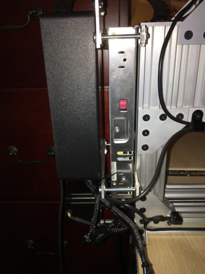

I chose to mount the power supply and electronics piggy back style by creating a standoff structure. I also chose to mount the xPRO V3 controller in an enclosure with power switch on the enclosure.

I plan to add electronics to start/stop my router and to start/stop an air/lubricant mist.
