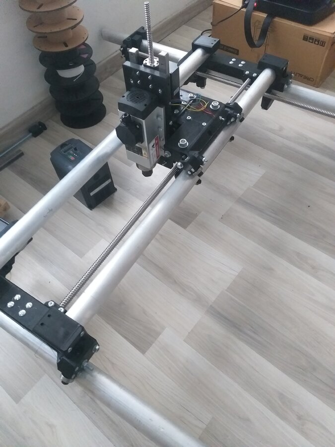

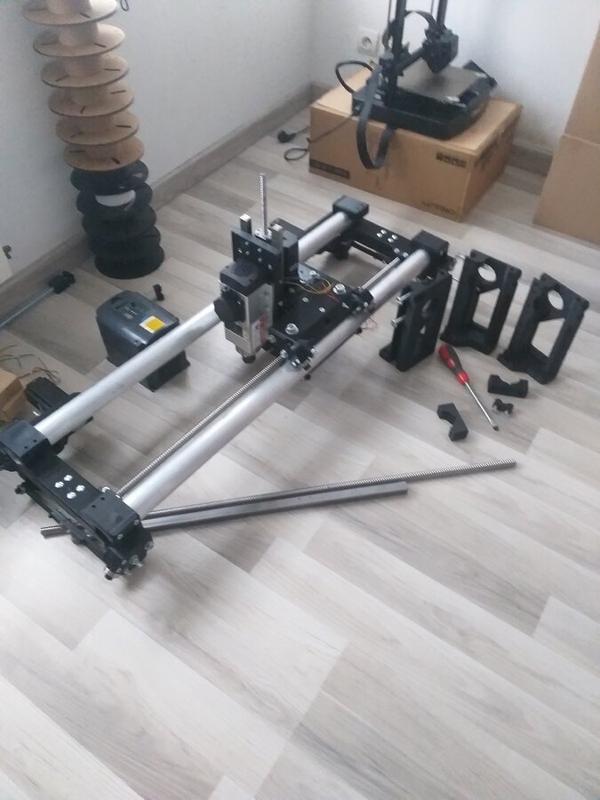

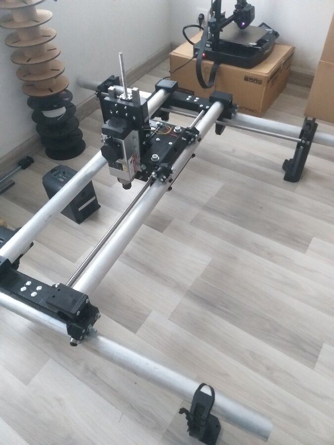

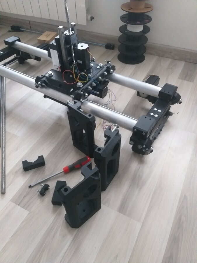

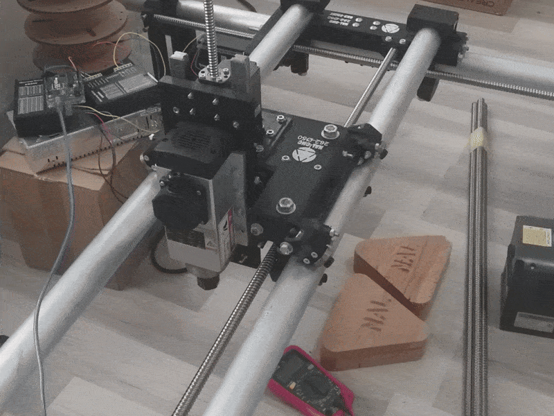

Wanted to share NALCNC, a fresh open-source large-format CNC project from Nal Design Studio. It's an optimized evolution of designs like the MPCNC, but taken to pro-level rigidity and speed for intensive woodworking, carpentry, and precision milling in hard materials.
The core idea: A hybrid design with just 3 optimized 3D-printed modules (PETG-CF/PA-CF) reinforced with steel tubes and ball screws. Super scalable, easy assembly, and cost-effective.
Key features:
Standard models (kits or complete machines):
- Fully open-source (OCL license) – 3D files, STEP/DXF plans.
- Scalable work areas: 500x500 mm up to 1500x3000 mm+.
- Pro mechanics: SFU1610/1204 ball screws with rotating nut (high precision/speed, no whip).
- Steel tube guides (round OX or square QX versions).
- Compatible with GRBL, FluidNC, MASSO, MakerFr, Jackpot3, etc.
- Great for heavy-duty use in wood, composites, light alum.

Reason for this Build
Why did I design and build NALCNC?
As Nal Design Studio, I've always been passionate about open-source DIY CNCs, and I've greatly appreciated projects like the MPCNC from V1 Engineering—accessible machines with 3D-printed parts, perfect for soft materials or applications like laser/plasma engraving.
But in real-world intensive workshop use (woodworking, carpentry, large-format cutting), these designs quickly hit their limits: insufficient rigidity for deep, fast passes in hardwoods, room for improvement in precision, and sometimes complex assembly for truly large formats.
That's why I created NALCNC-PRINT: a major "PRO" evolution of the MPCNC concept, completely rethought to deliver professional performance while remaining accessible, modular, and affordable.
With just 3 optimized 3D-printed mechanical modules (in reinforced technical materials), steel tubes, and ball screws with rotating nuts (like on high-end machines), NALCNC makes it easy to build ultra-rigid, precise, and fast 3- or 4-axis CNC routers
- capable of intensive machining in hardwood, composites, and even light aluminum passes.
- The goal: democratize large-format machines (up to 1500x3000 mm and beyond) that hold up in real production, while keeping the DIY and open-source spirit (OCL license, free plans for early adopters).
In short, NALCNC was born from the desire to bridge the gap between accessible hobby CNCs and expensive professional machines - so anyone can assemble (or have assembled) a true workhorse without compromising on performance!
What do you think? If you have questions about the technical choices or how it improves on the MPCNC, I'm all ears!Inspired by
