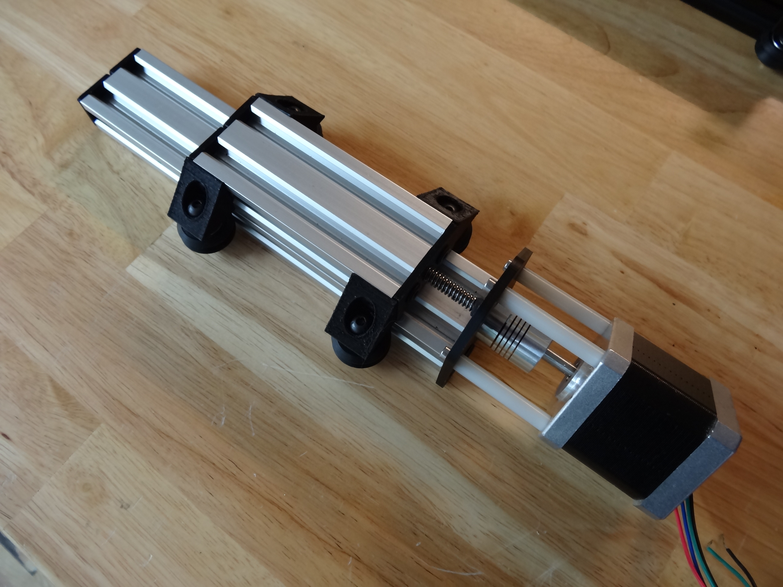

Z-AXES transfer plate drawings
If the circle to move the files to CAD was the first time I had to sketch up a new job is all garbled.
Plates.dxf working video
Plates Work Product
Z-AXES transfer plate + 8mm trapezoidal metric lead Ballscrew
5-axis CNC router kit, TB6560 1-axis driver + usb power interface board + 3PCS NEMA23 270 3PCS Oz stepper motor + power supply
5 Axis Breakout Board; MACH3, KCAM4, EMC2, and the host computer using the software.
