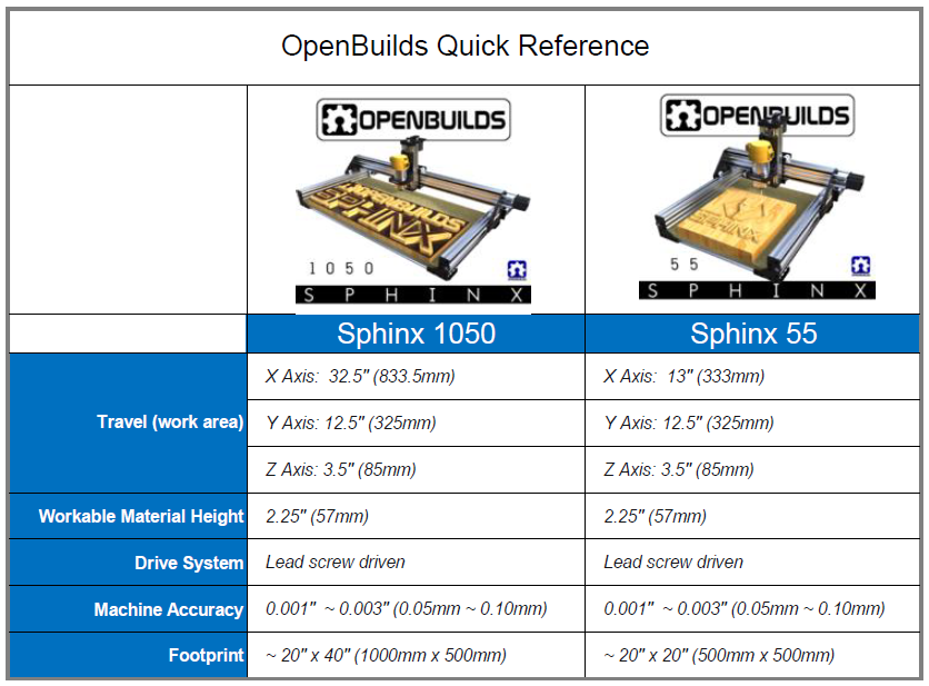

The OpenBuilds Sphinx Bundle is available in two sizes.
The Sphinx 1050 has a footprint of about 40" x 20" (1000mm x 500mm) The Sphinx 55 has a footprint of about 20" x 20" (500mm x500mm)![]()

H 3/4" (19mm) W 19.5" (500mm) L 16.250" (410mm)
Assembly time : Can be assembled in an afternoon.
