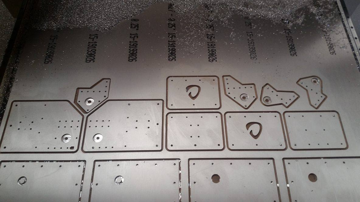

8th July - Plates milled by my friend Sean Coogan. If anyone needs alu work, please go to him. The least I can do is send more work his way.

Finished plates. Sadly, some of the holes he made were under sized so it added about 2 hours of work to ream them out to fit everything. Aluminum is a "soft" metal but **** is it hard compared to wood! I ruined a metal/wood bit or to in the process.
