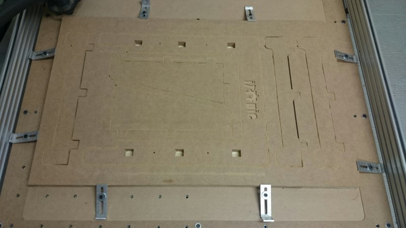

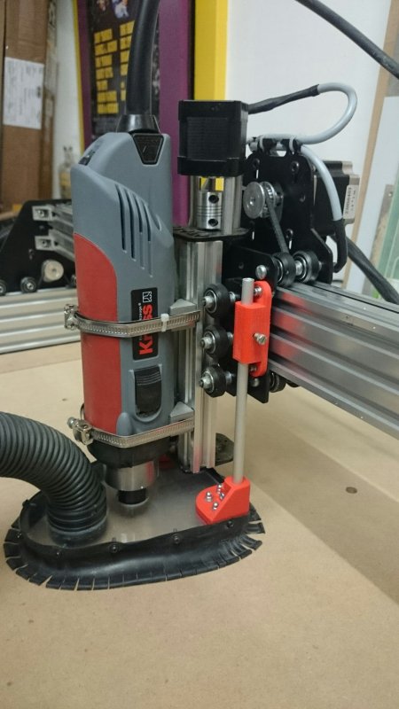

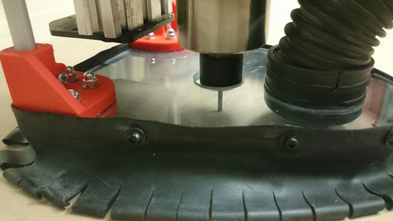

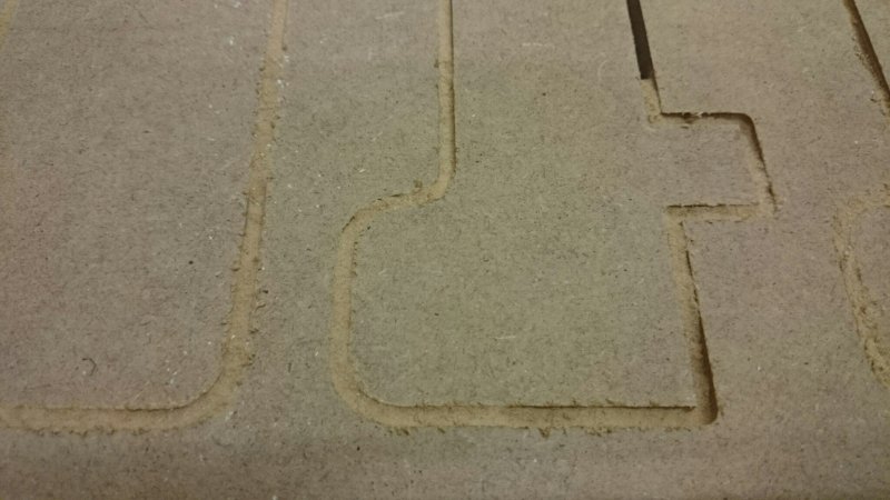

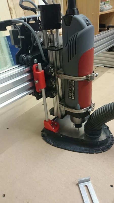

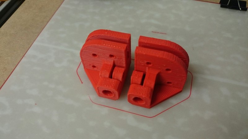

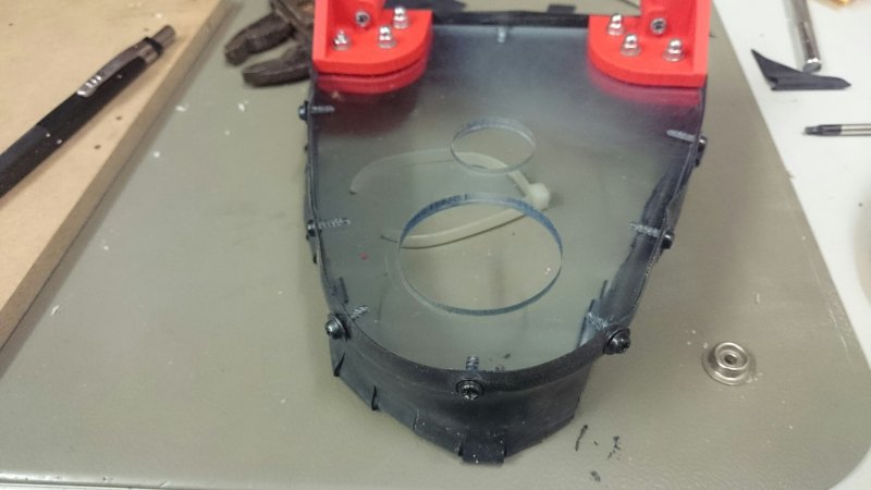

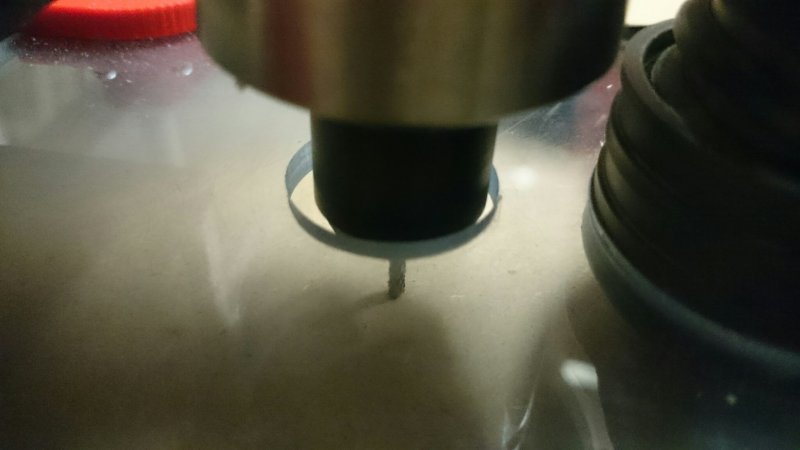

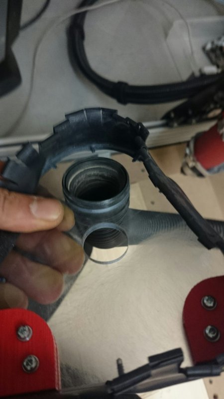

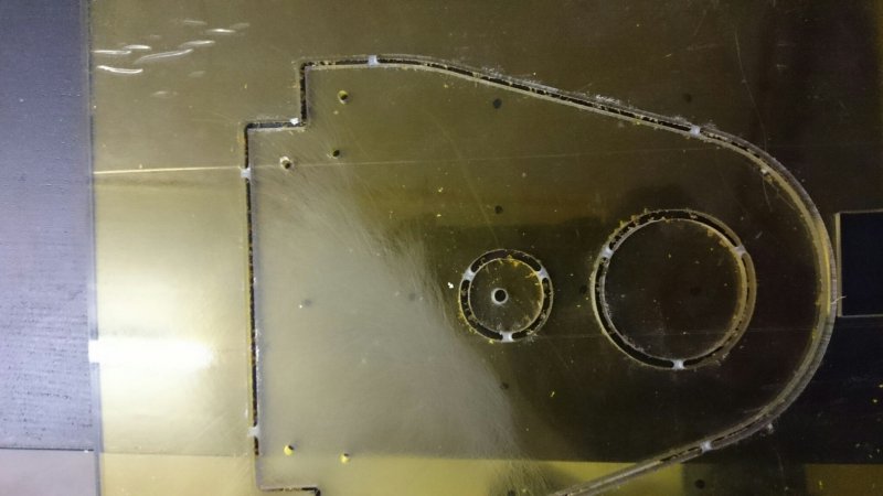

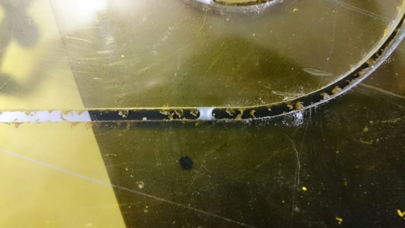

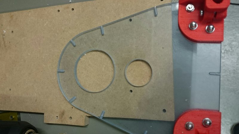

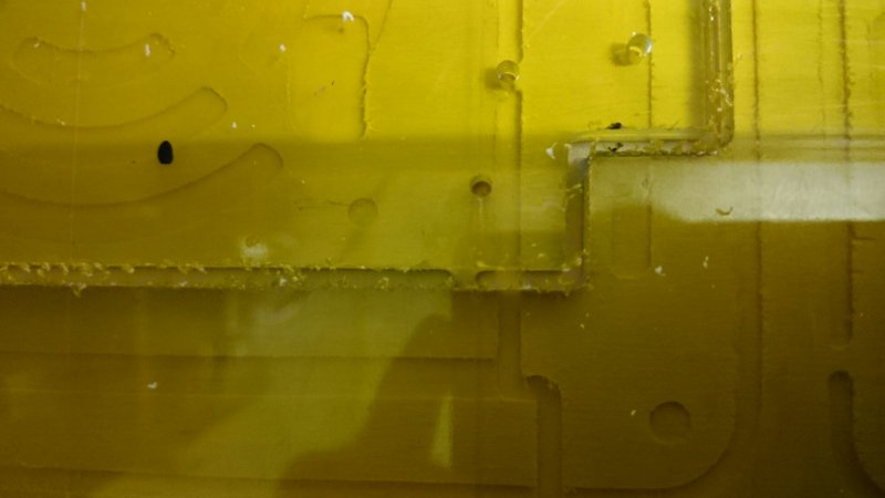

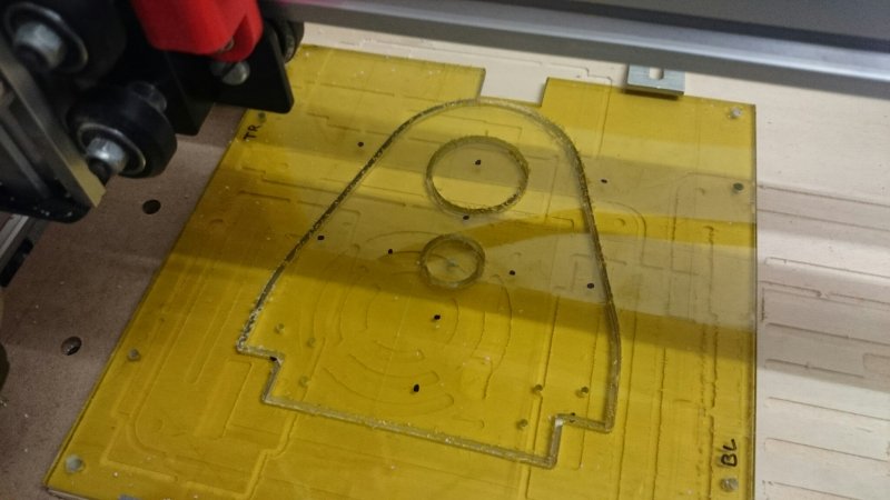

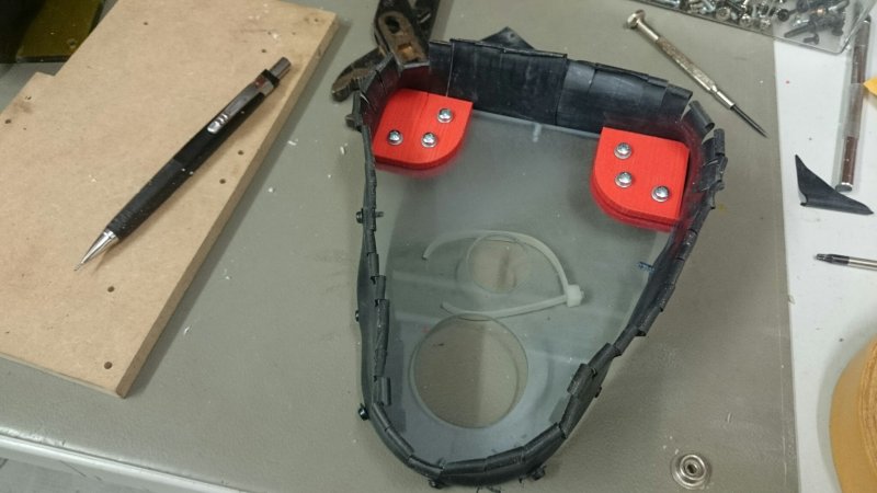

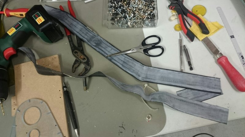

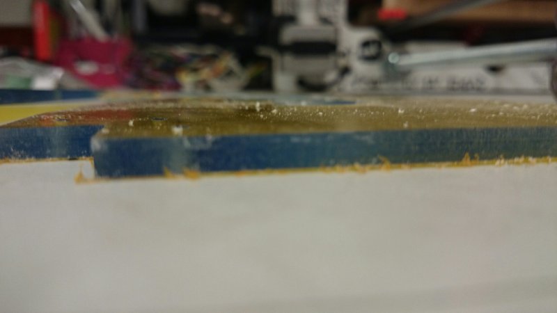

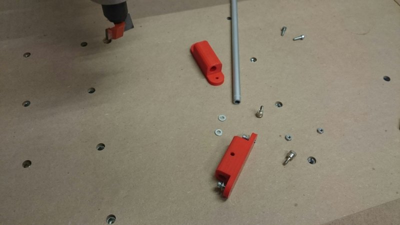

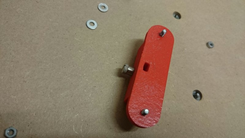

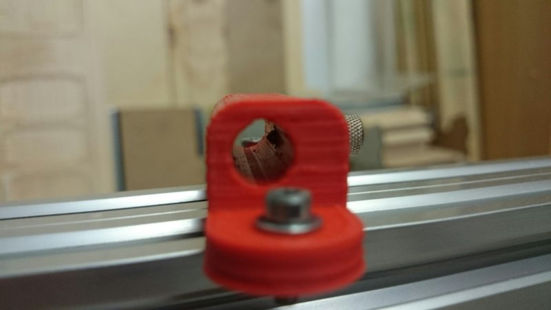

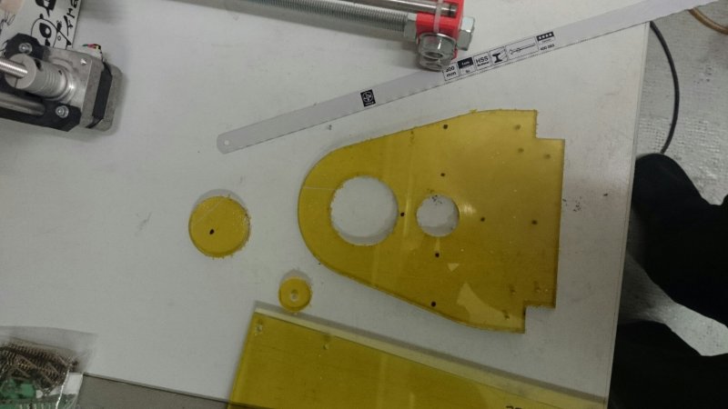

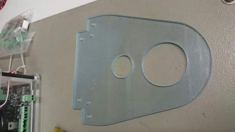

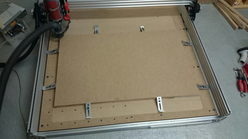

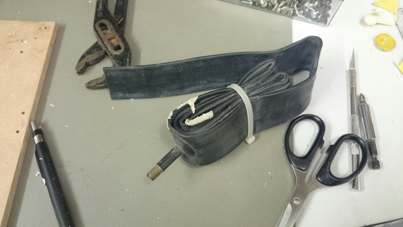

First try to make a dust shoe for my OX. I make a fixed version beacause it was easier for me to do and this facilitated the access for tool change. Note: the idea of the inner tube is not bad, but a less flexible material would be better (maybe a brush), because if it is too low there's suction effect on the plate. And the fringes too close from the tube are sucked. (I solved the problem by shortening some fringes.) Ok, no more speaking and more pictures/videos (less grammar errors). Peace.
