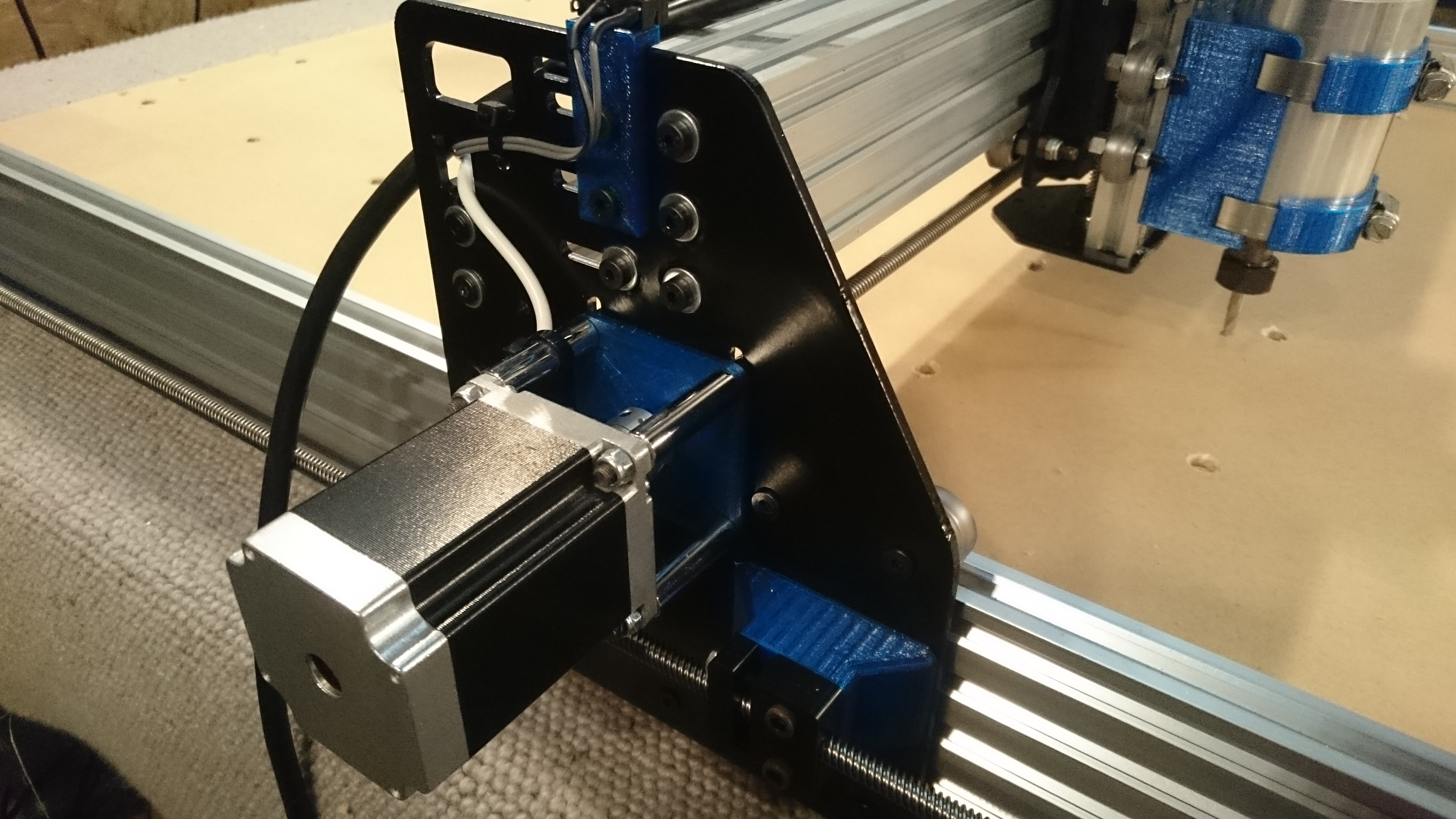

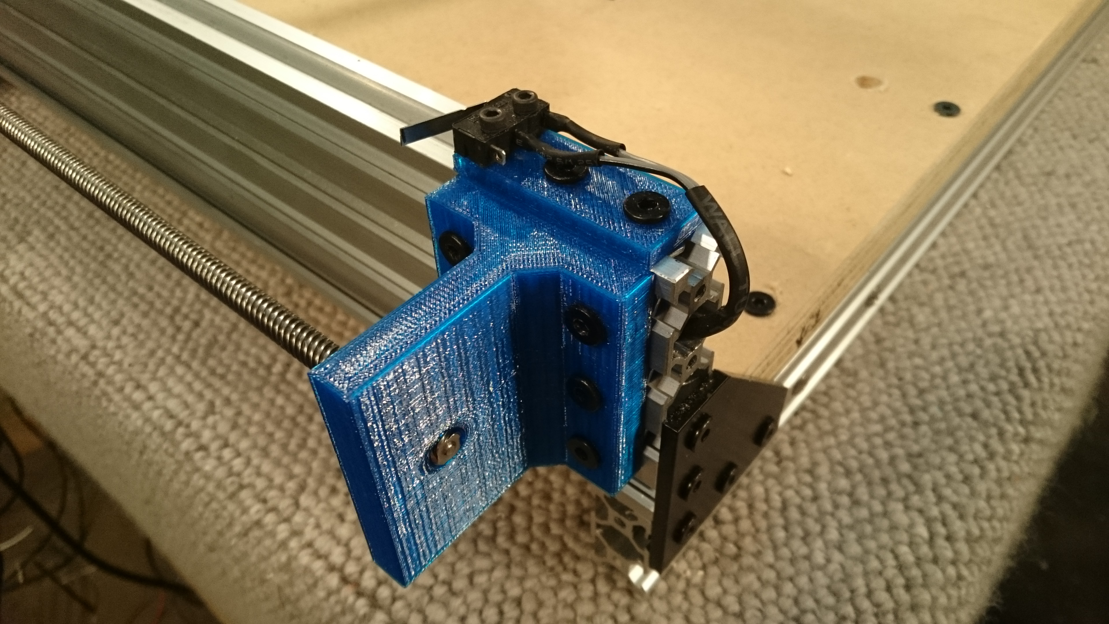

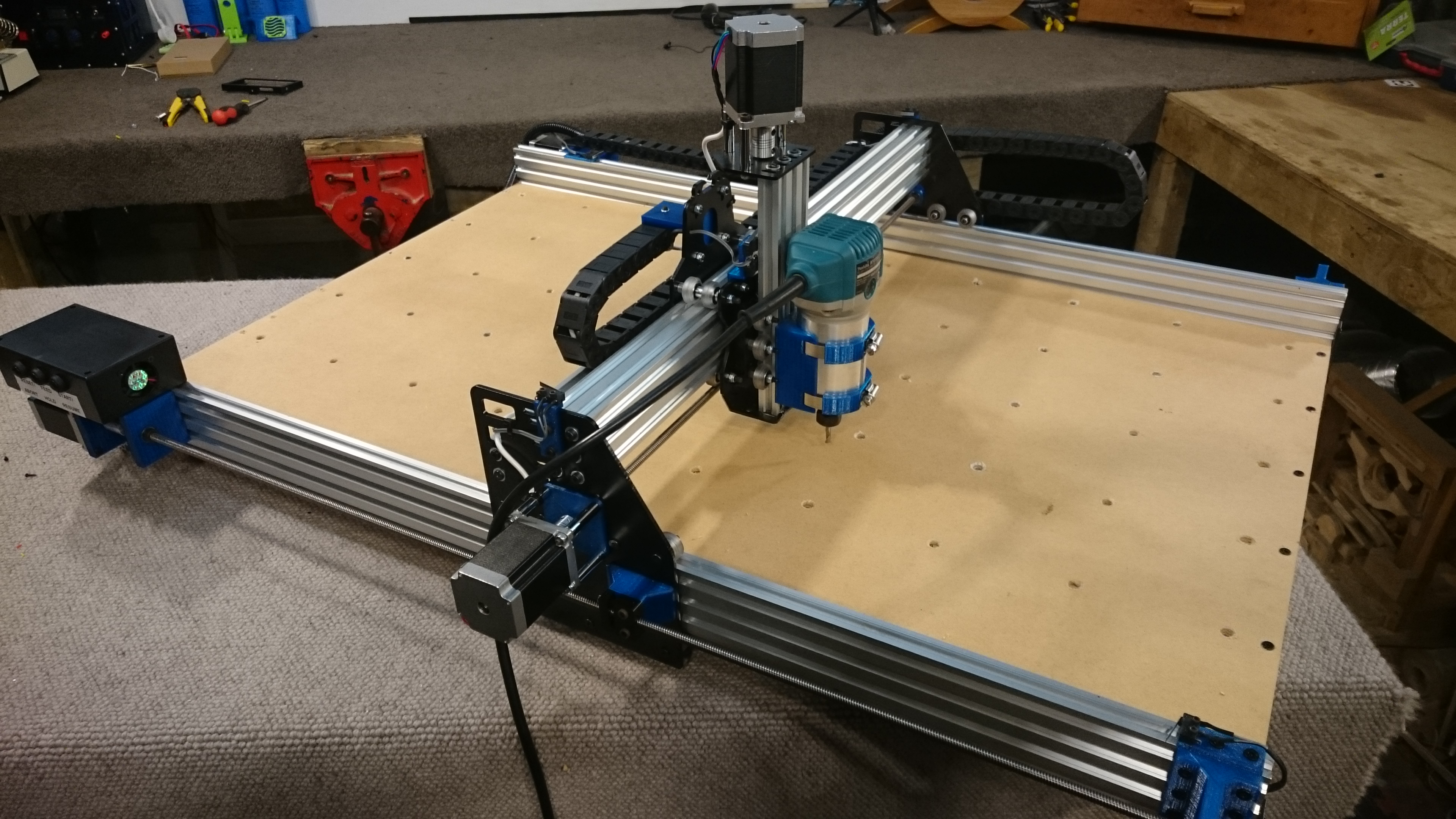

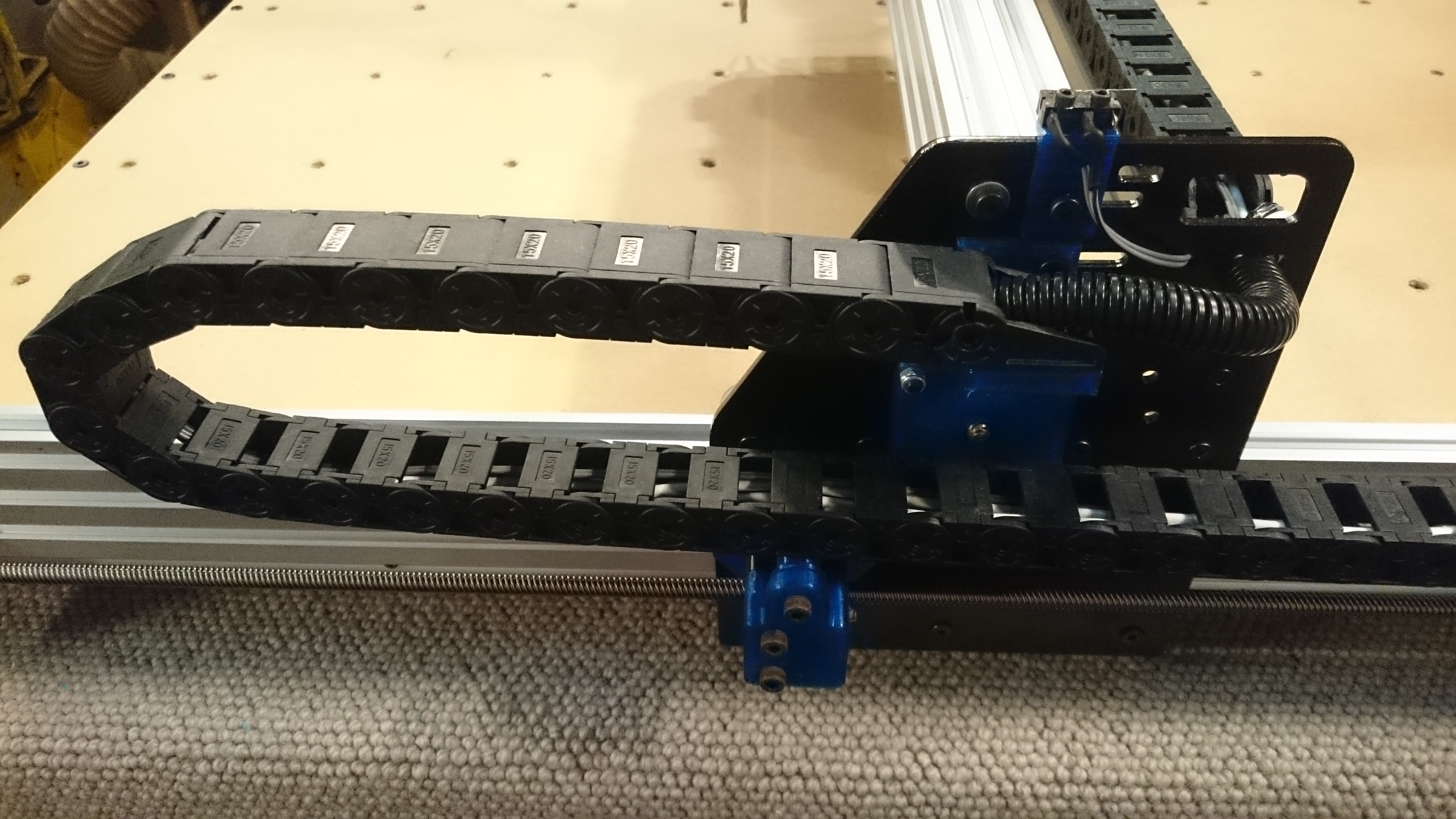

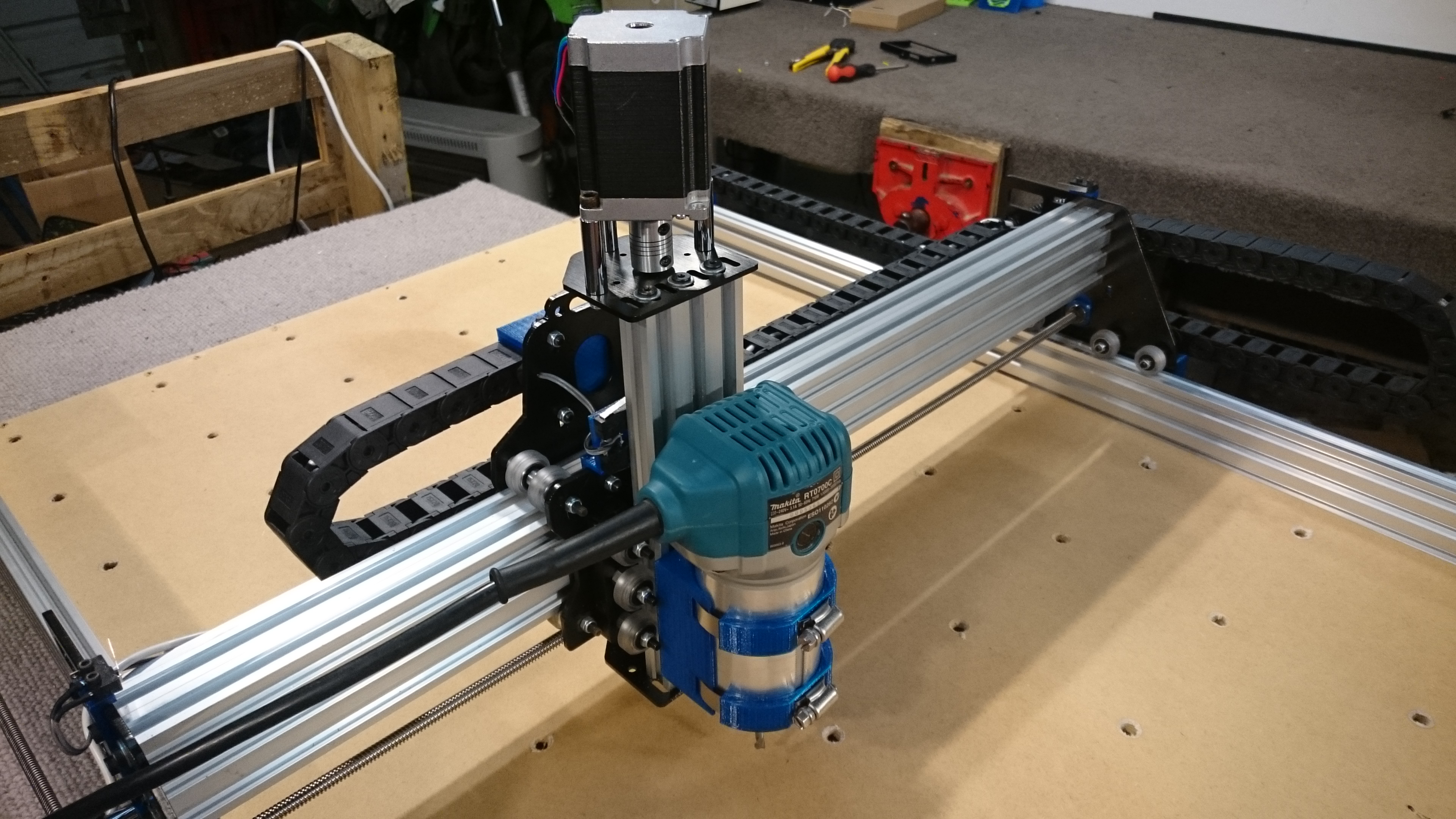

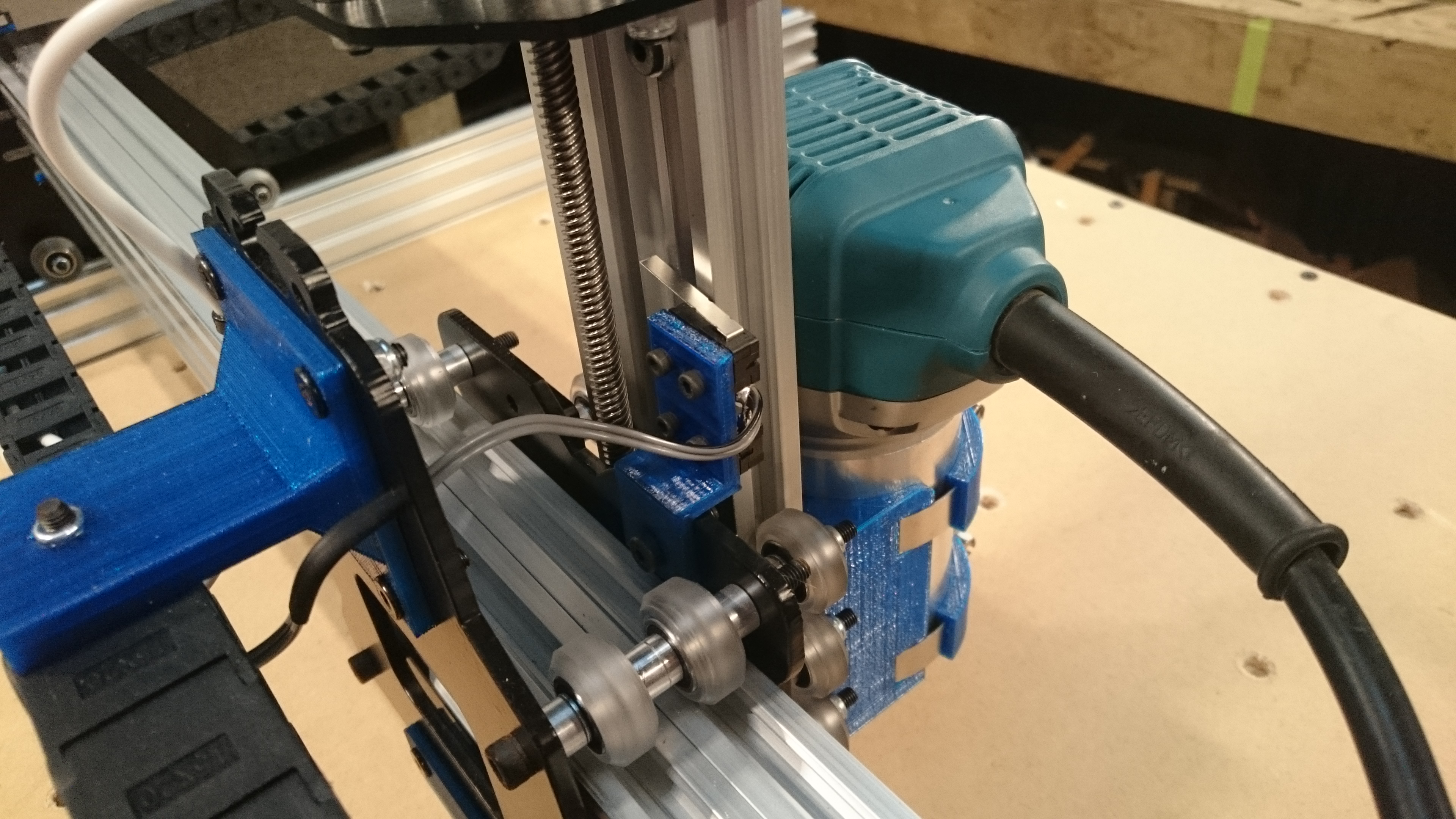

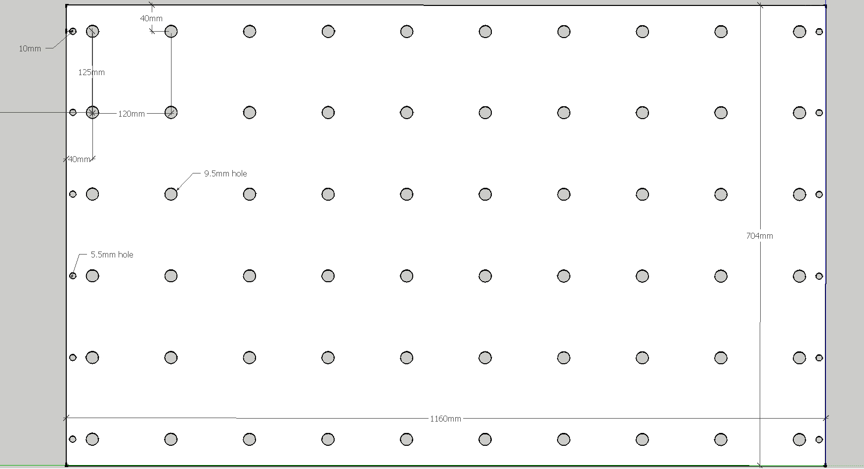

Introducing the OX-Metal CNC Router Mill. As the name would suggest this CNC mill is based on the popular OX CNC Mill. This is my own version of the OX and has been named the 'OX-Metal' to avoid confusion with the original OX. Most notably the biggest change to the design has to be the use of 8mm Leadscrew on all axis. This allows the OX-Metal to machine aluminum along with other similar hard materials. Even if you have no intention of machining aluminum I personally prefer leadscrew over GT3 belt for a couple of main reasons. First this stiffens the axis and reduces the amount of elasticity within the axis. And second effectively 'gears-down' the steppers to produce more torque. The OX-Metal has also had a few add-ons, Namely a grid of M8 tee nuts on an 18mm plywood bed to secure down your workpiece, Limit switches for both min & max travel, X and Y axis Cablechain for cable management along with some ideas for future improvements (such as a lubricant mister and a vacuum nozzle for dust collection)

The OX-Metal is based on the original OX CNC mill But with a few modifications and add-ons
