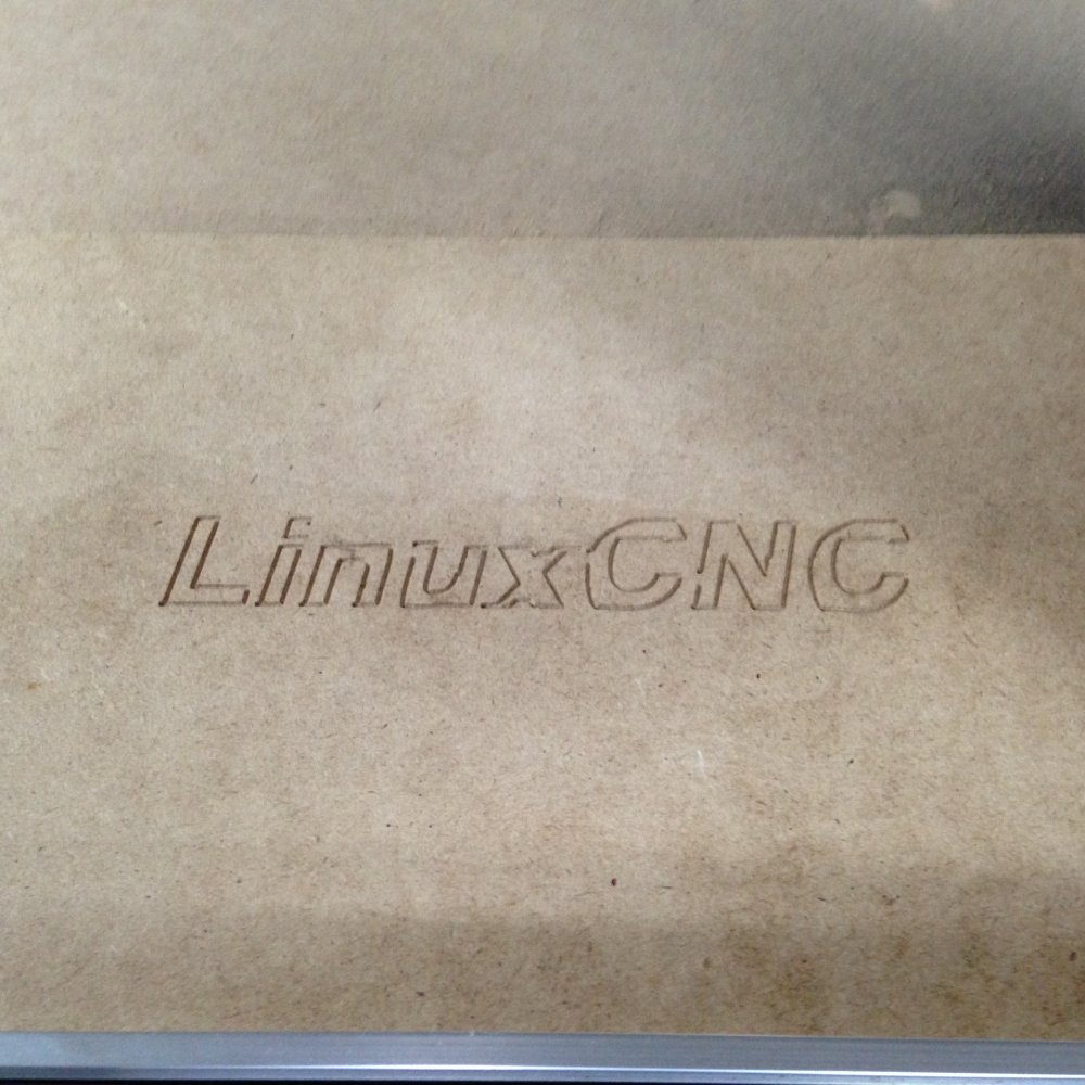

I finally made the first cut using a router. I need to figure out how to calibrate the dimensions but at least I have it cutting![]()
