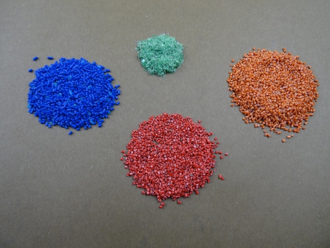

- Producing Flakes / Pellets / Granules:
- Leftover 3D Printer Filament - Pellets
- (PET/PETE) - Plastic bottles - flakes / granules
- (Nylon,Polyamid) - Monofilament Fishing Line - Pellets
- (Nylon) - zip ties - Flakes / pellets / granules
- (Nylon) - String Trimmer line - Pellets
- (many materials available) - Hot Melt Glue Gun Sticks 7,20mm - 7,50mm - granules "testings still in process"

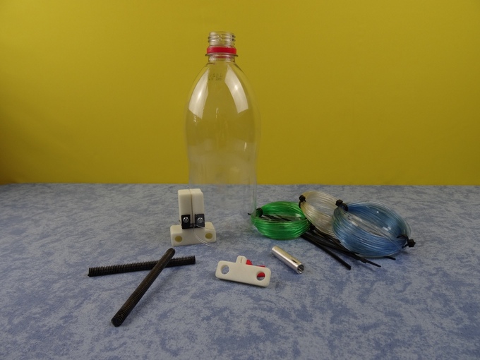

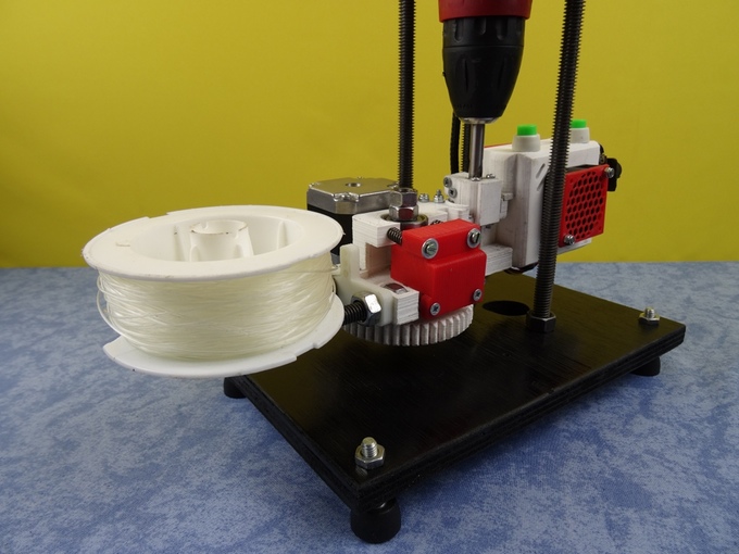

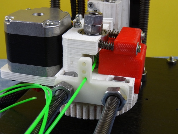

In most cases, any material is different in diameter or shape. For this reason we have a fast-swappable System in form of various slide-tubes implemented.
The shredder-element consists of a sharp HSS drill, which are known for their long durability. The bottle slicer can be easily fitted back to full cutting capability with a standard cutter blade.

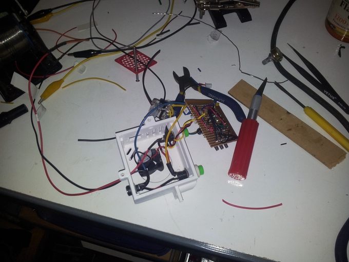

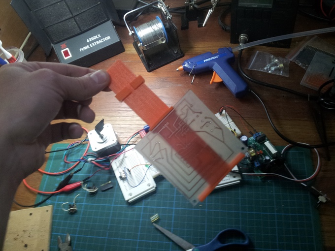

-Firmware for ATtiny85
-Pictures
-Wiring/PCB Layout as SVG and Gerber (with and without Copperfill)
-BOM/Shopping List with Links and more info
-3D Printing Parts as .STL
SHRED-Buddy3D UPcycler - Open Source Multi Material Cutter&Pelletizer
Build in 'Everything Else' published by Venturebit, Jan 2, 2017.
The whole system is powered by 12V / DC power. Process it into Pellets or Granules to use it with your 3D Printer or Filament Extruder. Our self-developed steppermotor Controls allows you to optimally adjust Feedrate for your Situation. Forward, Backward and Stop is integrated for easy operation. The Speed can be continuously regulated via rotary switch.
- Build in Progress...
