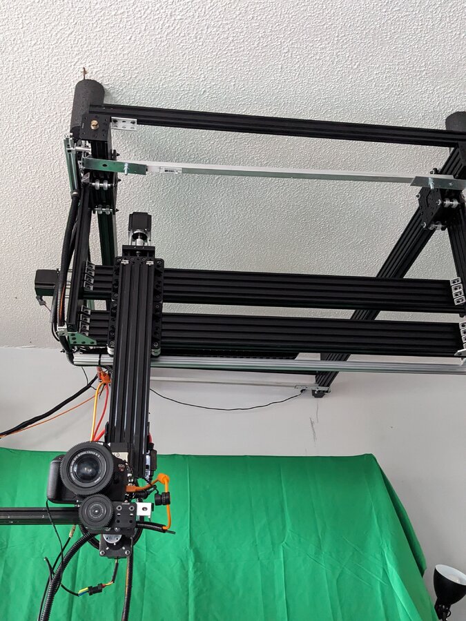

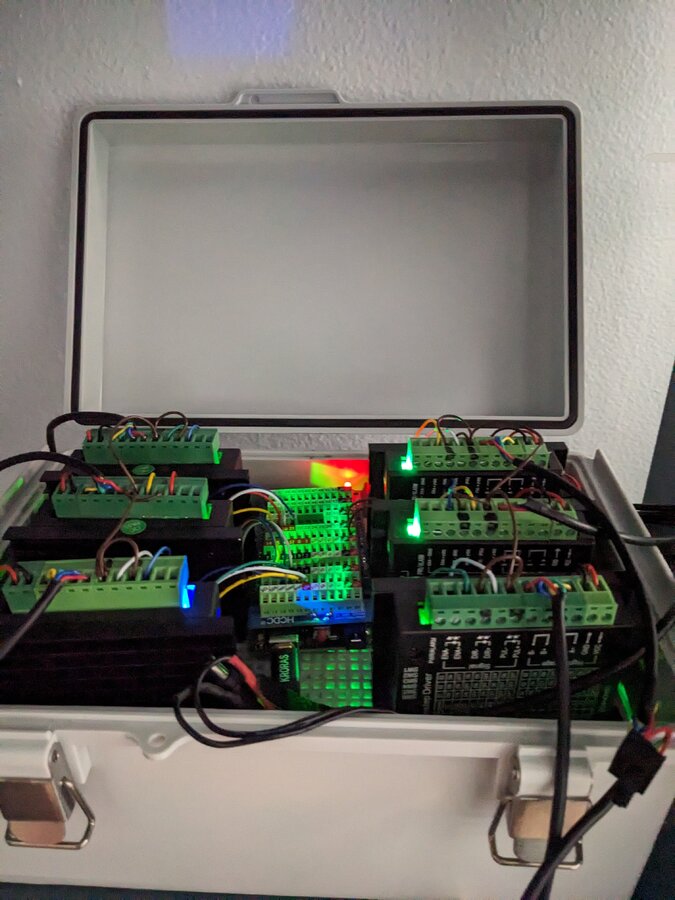

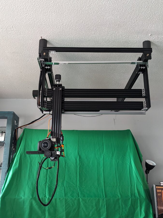

This build is based one-hundred percent on the Openbuilds lead 1515. Three additional axis were added to the Z-Axis. Arduino mega 2560 controls seven motors and six TB6600 controllers.
Six_Axis Camera Slider
Build in 'Camera Sliders - Rigs' published by hbtousa, Mar 13, 2025.
X is 1000mm, Y is 1500 mm, Z is 1000mm. It Rotates 360 degrees and Tilt also can move 360 degrees. I also have a motor that controls the focus of the camera.
- Build Complete!
Special Notes
Build has to be perfectly leveled, and squared. Weight is an issue. Plan ahead of time how much load your motors can handle. Motors have to carry the entire system plus a camera . I am using soft limits only. The parts are 99.9% from Open Builds, except the driver controller and Microprocessor. My background in electronics is very poor. But, building a system with high quality parts makes the job easier.
